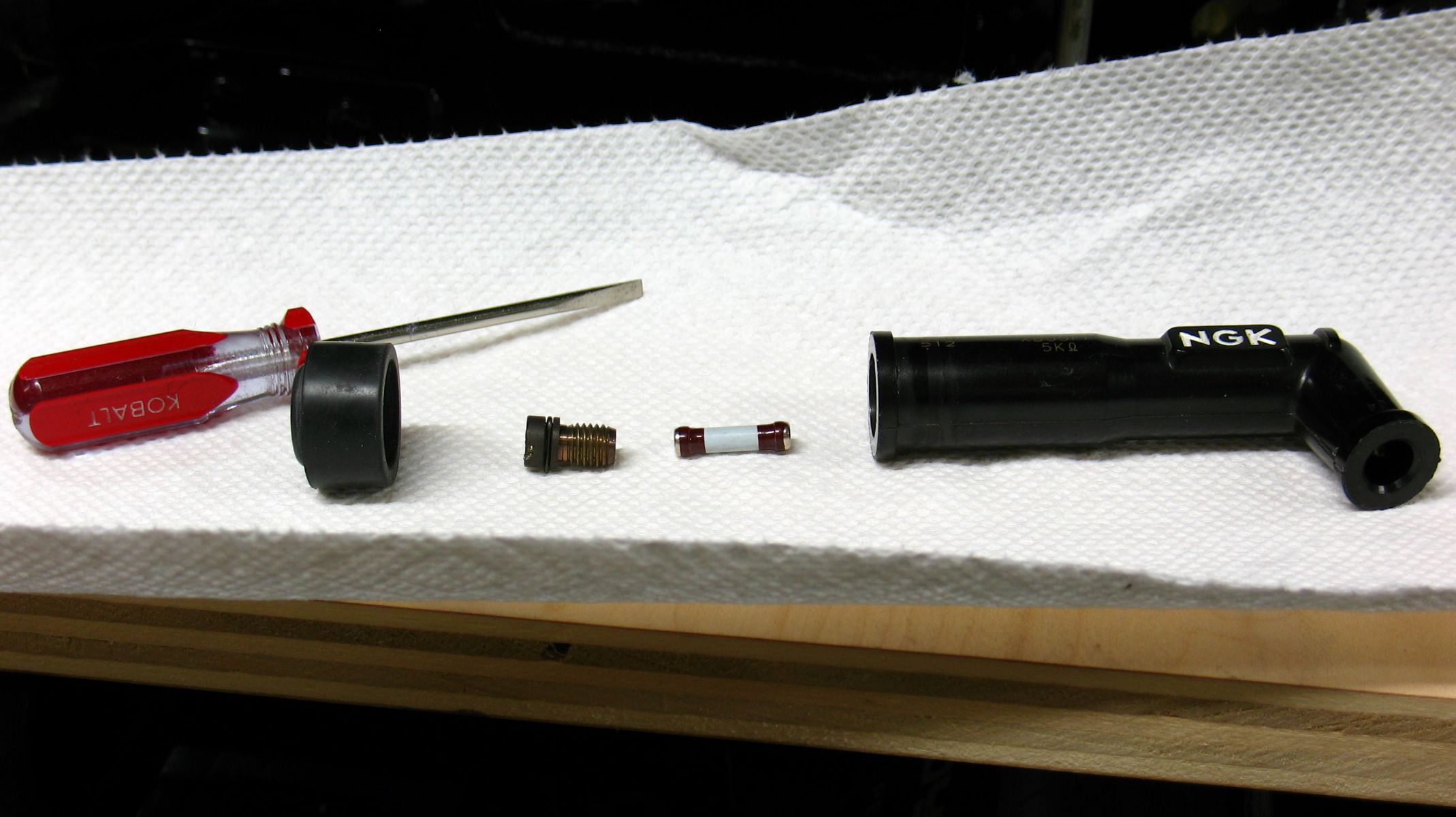

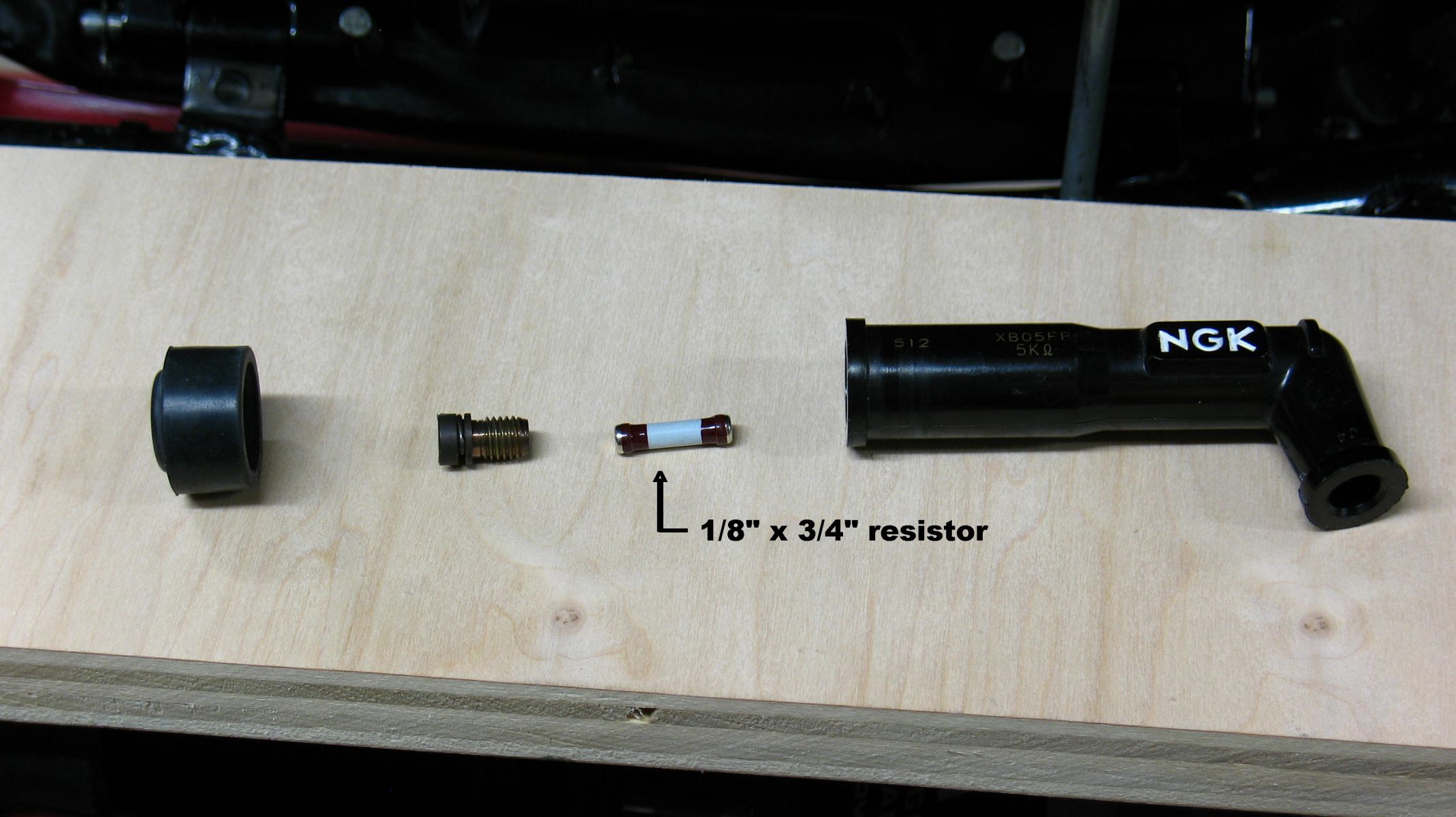

I installed a Dynatek 2000 ignition and 3 ohm Mini-Coils a couple years ago, and tried the suppression wire/non-suppression caps and
B8ES plugs, but now have copper core wires with the suppression caps...which work excellent with non-R spark plugs, but I think the spark energy is diminished using R plugs with the setup.
Here's one #2 & 3 cap ready for conversion. I've read one suggestion to use a piece of solid brass rod in place of the resistor. Sounds good, but will something else work even better?

20 Sep 2015 06:57MFolks wrote: NEVER use resistor plugs and suppression caps or suppression plug wires, as now there will be three (3) sources of resistance in the secondary loop of the ignition coils, possibly reducing the spark energy.
I have two of these ready to convert (for #2 & #3 spark plugs) to non-resistor, and prefer NGK's attachment design (to the plug wires and the plugs), over other cap styles available.
What would be the best thing (for conductivity) to use in place of the resistor?
