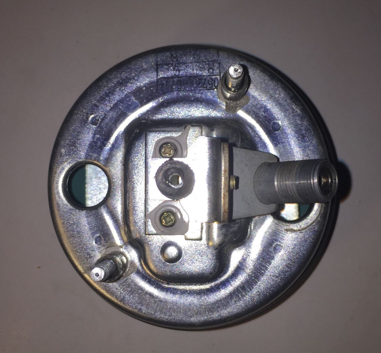

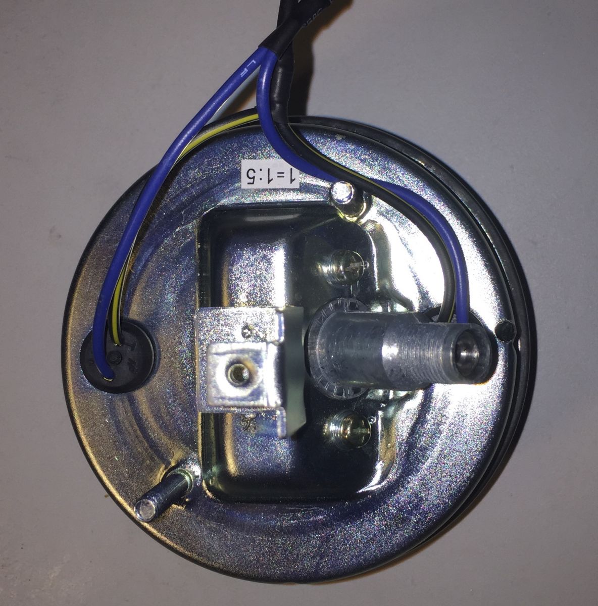

OK so I took two pictures of the two tachometers. The ones with the lamps installed is the reproduction one....
You can clearly see that the gear box drive assembly is much larger and rectangular in the repro clock. Notice how close the stamped box comes to the mounting stud.
The studs line up fine but that that larger rectangle shape makes it so it will not fit in the stock KZ instrument bracket.

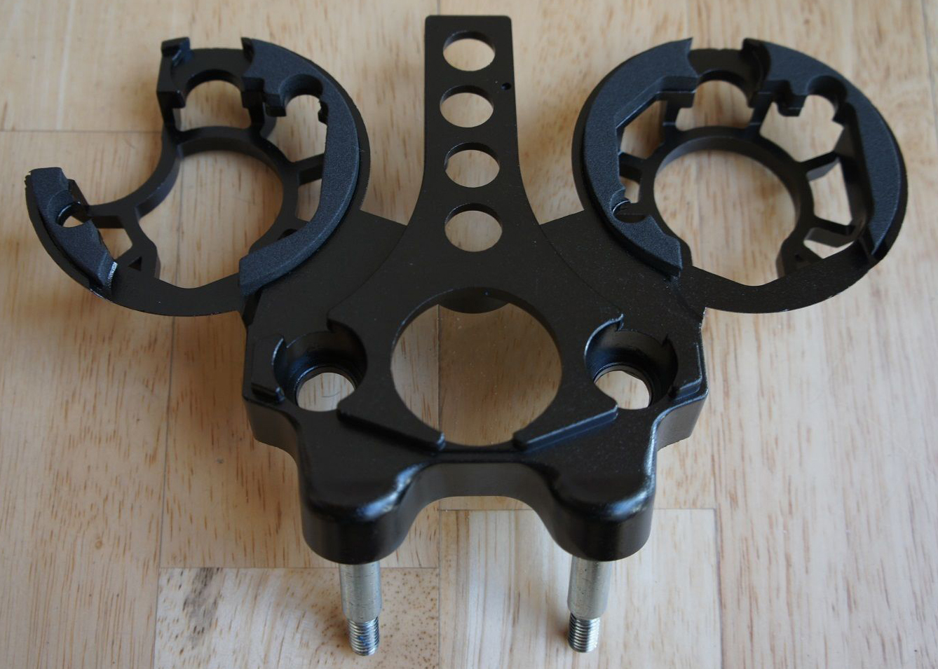

Below is a close up of the aftermarket instrument mounting bracket, which assume is cast to fit either the factory clocks or reproduction.

So you would have to hog out the metal for it to fit.
