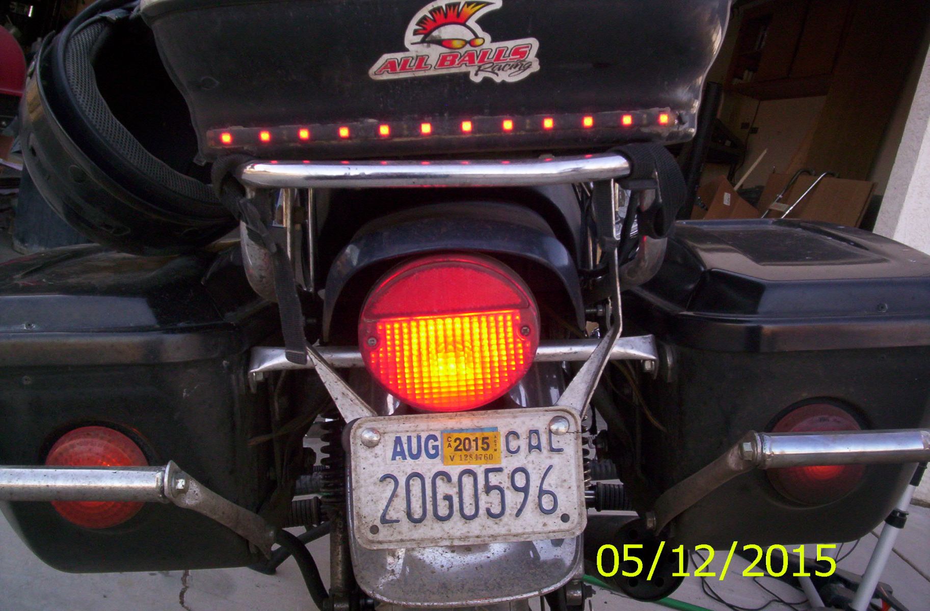

I have a LED strip on the back of my top box for the brake light. Works great but my outage indicator stays on dimly. Possible bleed over or some kind of transient voltage? I don't know. Works great though and when I put on the brakes the light works like it should in my gauge. They have a built in resister but I think they're right, you need the right flasher relay.
