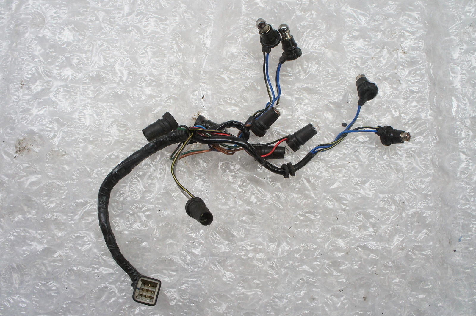

on a 1980 KZ750, Can anyone tell me how to get to the speedo and tach bulbs for replacement? I removed the 2 chrome 8mm nuts on the back of the housing, but I did not see how to get the front face off to get to the bulbs. Any help is truly appreciated.

- Posts: 23784
- Thanks: 3047
Re: Indicator/dash lights
17 May 2015 12:38
You don't have to open the gauge housings. I'm planning on doing a thread on that. On the bottom of the housings are black plugs like corks with wires in them. Carefully pry them out and change the lights. The ones you buy now don't last, that's why I tried the LED style. Because they're so hard to get to, I would suggest buying the better type. If mine burn out, that's what I'll do.
