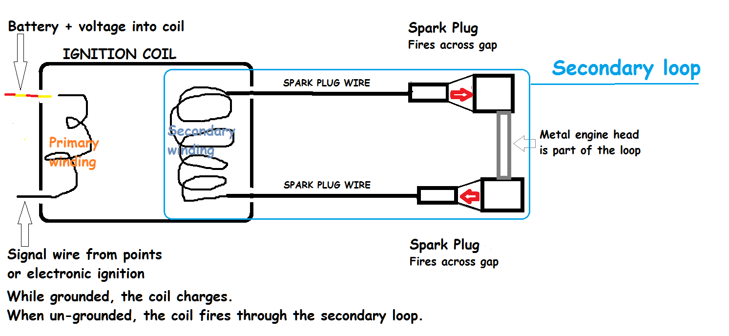

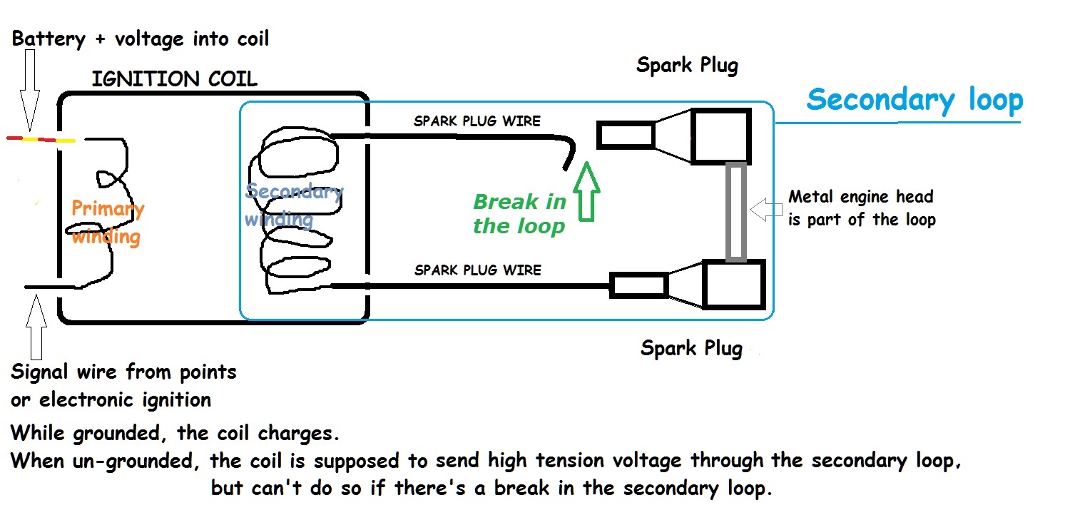

#2 and #3 spark plugs are part of the same secondary loop and are supposed to fire simultaneously as high tension voltage passes through the loop.
If the loop is broken for whatever reason, then the high tension voltage doesn't pass through either spark plug because high tension voltage isn't passing through the loop.

yep, two plugs form a series circuit so if you open either side, both plugs quit firing. 1-4 are a set and 2-3 are the other set.
