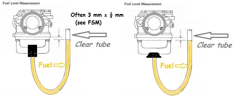

If not already done, would perform clear tube test on #2 carb to determine whether fuel level is within spec.
Special tool isn't essential, as may use section of larger hose or conical shaped grommet to accommodate the clear tube.

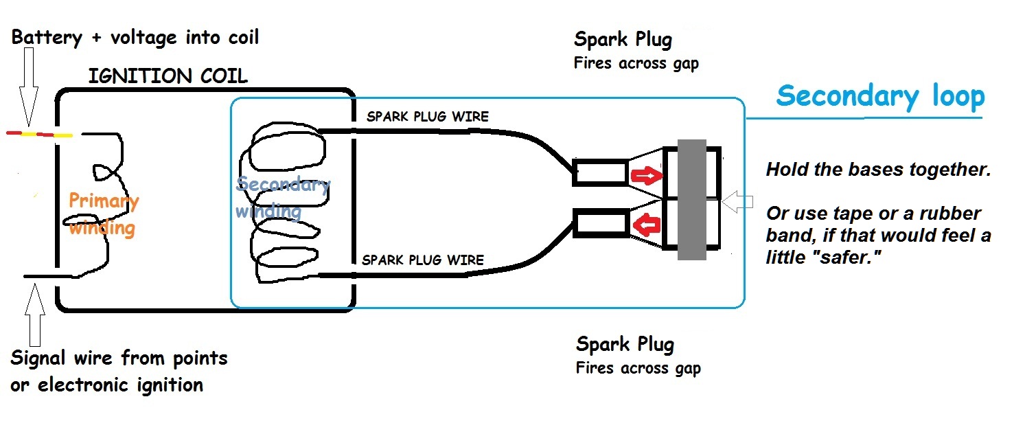

As a visual test for comparative spark quality on #2 and #3 plugs, could attach the plug bases together (eg. tape, rubber band. whatever) -- rendering it unnecessary to ground plug bases against the engine head -- and watch sparks on the two plugs with engine spinning over.
Is there a significant difference in spark quality between the two plugs?
If the plug wires are removable from the coils, would replace them with brand new Dyna metal core plug wires, which come with integrated non-resistor caps, especially the #2 and #3 plug wires.
Then re-test for comparative visible spark quality as described above.
As both #2 and #3 plugs are in the same secondary loop, it's puzzling why one plug would have noticeably weaker spark without blaming it on some defect in the plug itself.

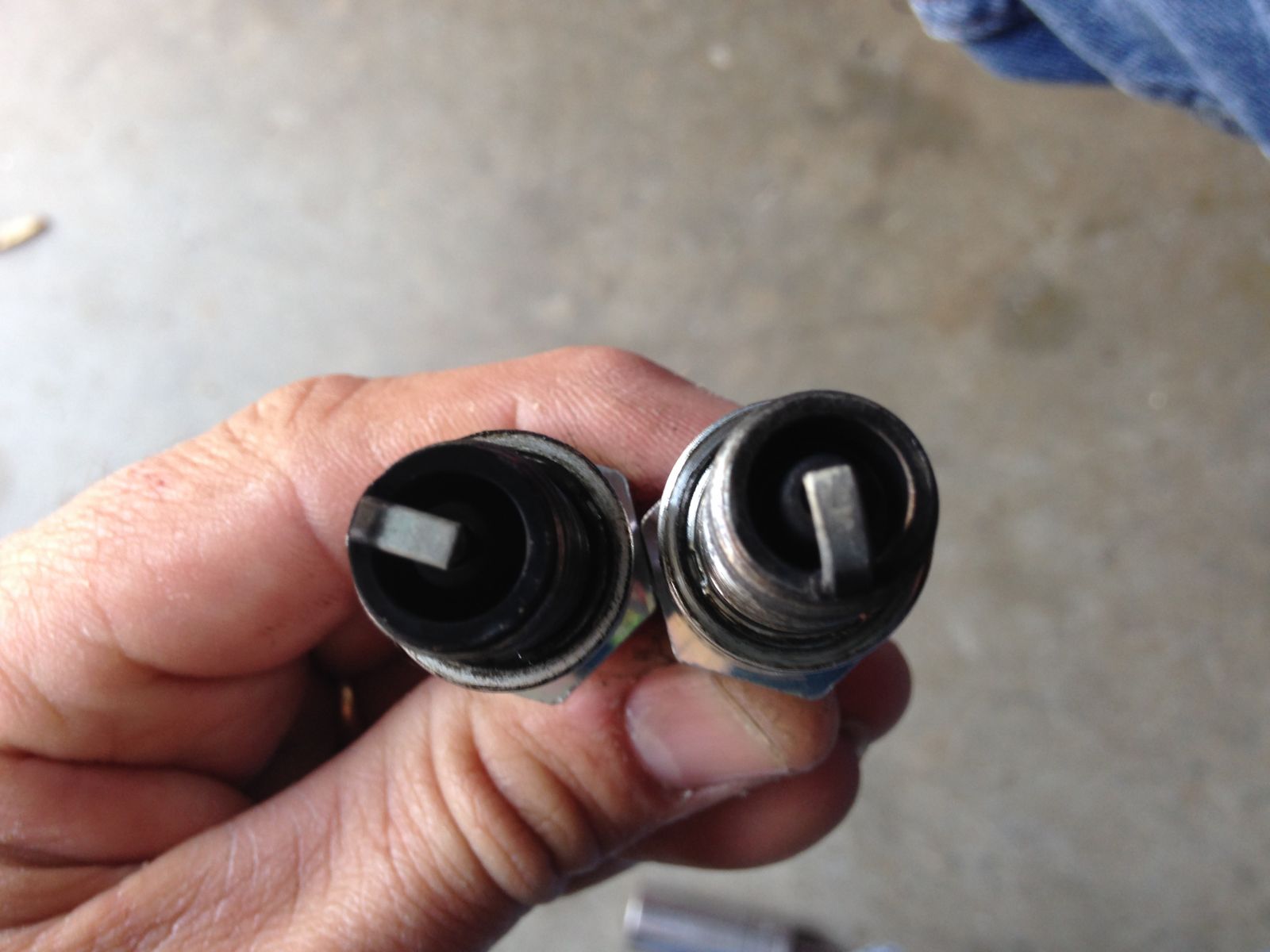

well i did not get to do the above test mention above..will do......thx for the input...
did drive the bike for about 15min. ..
1st...bike does not like to idle below 1800rpm
2nd...bike under load.... under 3000rpm sluggish..wakkens up above 3K rpm (not enough street) 2nd gear
3rd...scary fast...tire losses traction
pic of plugs after drive...
left is #1 was on bike already and right #2 new plug ( reason for no carbon builtup)
carbs are 29mm SB 132.5 main..25 pilot...1.5 air jet..neddle ste at..n/a
temps at exhaust.... all were at around 450F except #2 at 320F
