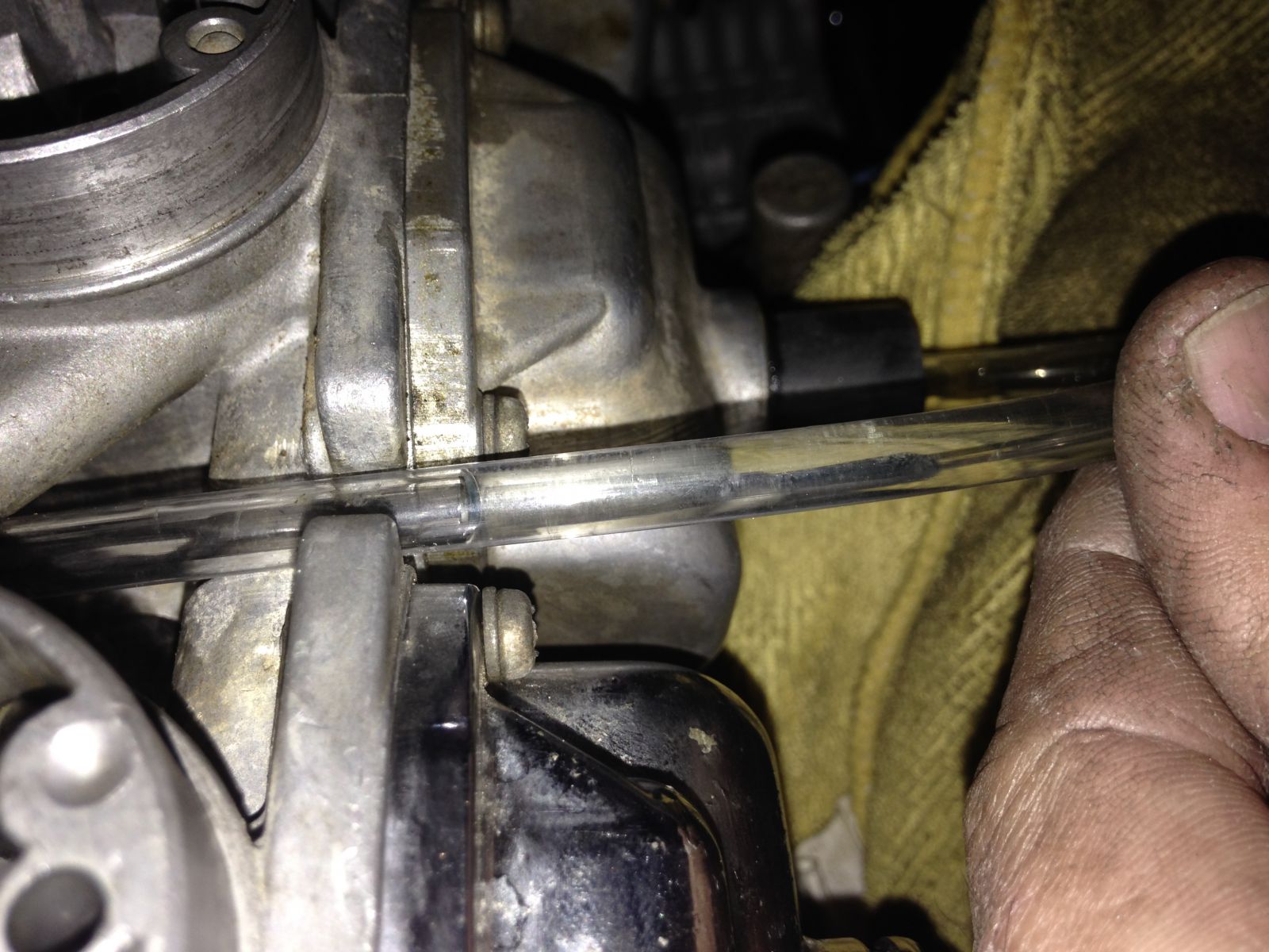

ok....change out the coils( originals from my 77kz1000a) and proform the plug spark test as Patton suggusted.
both plugs had the same spark..so went aheadand proform the clear tube test again and was fine.

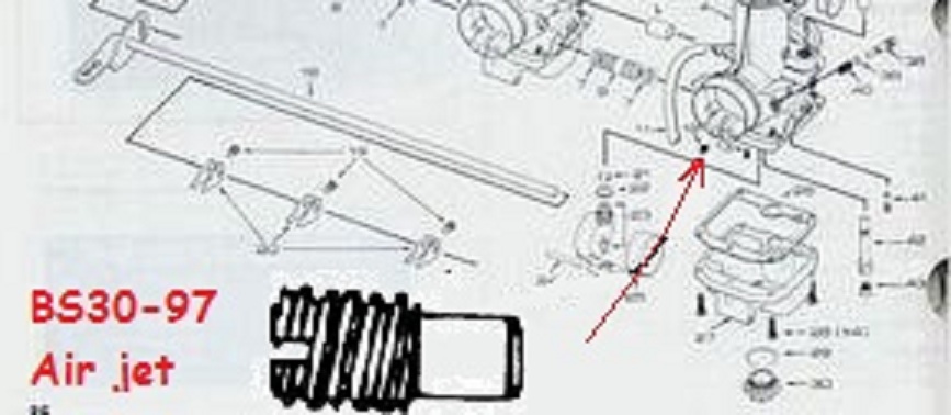

- Posts: 18568
- Thanks: 2102
Re: #2 cylinder low temp and spark
23 Nov 2014 08:29 - 26 Dec 2014 15:27
If not already done, would assure that pilot air jet BS30-97 is clean and clear.
Reportedly, the fitment with some brands of pods may obstruct the pilot air intake on certain carb models.
If pods are fitted, would assure that the pod isn't obstructing the pilot air jet.

with holidays around had some time to look at the carbs. found the two inner air jets to be stuck and maybe broken at the on one side. can not turn them out. did spray cleaner and it came out the other end.
