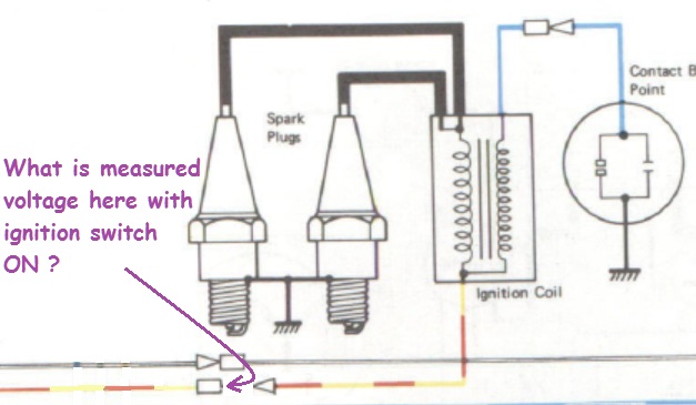

With the ignition switched ON, what is voltage at the female connector on the red/yellow wire going to the coil primary?
Given adequate power to the coil primary, the reason for lack of spark is likely related to functionality of the coil, or the secondary loop, or the points.

I am not getting any voltage on the red/yellow wire, and i think it is because i am missing the engine run/stop switch. so i can see the open terminals on the right grip. should i just take the 12v that i am using to feed the right grip and just feed it right to the coil? (using the red/yellow wire) i am trying to get all the wiring sorted before actually starting it because i dont want to fry the stator/regulator/rectifier.

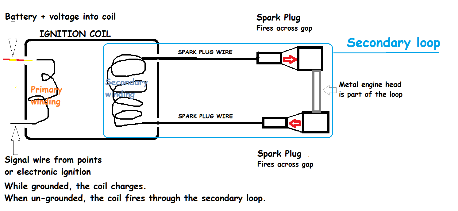

Any break within the secondary loop will prevent spark on both plugs.
A shorting plug wire is one of the possible suspects.
Would check connections of plug wires at coil towers (unless permanently attached), plug wires to plug caps, and plug caps to plugs.
It might help to slightly trim off a bit of the plug wires to gain a better connection to the caps.
If in doubt about the plugs, would use new factory spec spark plugs.

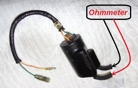

Could ohm-test the secondary loop, measuring resistance between the caps, or between ends of plug wires removed from plug caps.
The following diagram is for illustration only -- DON'T CUT the plug wires. :pinch:

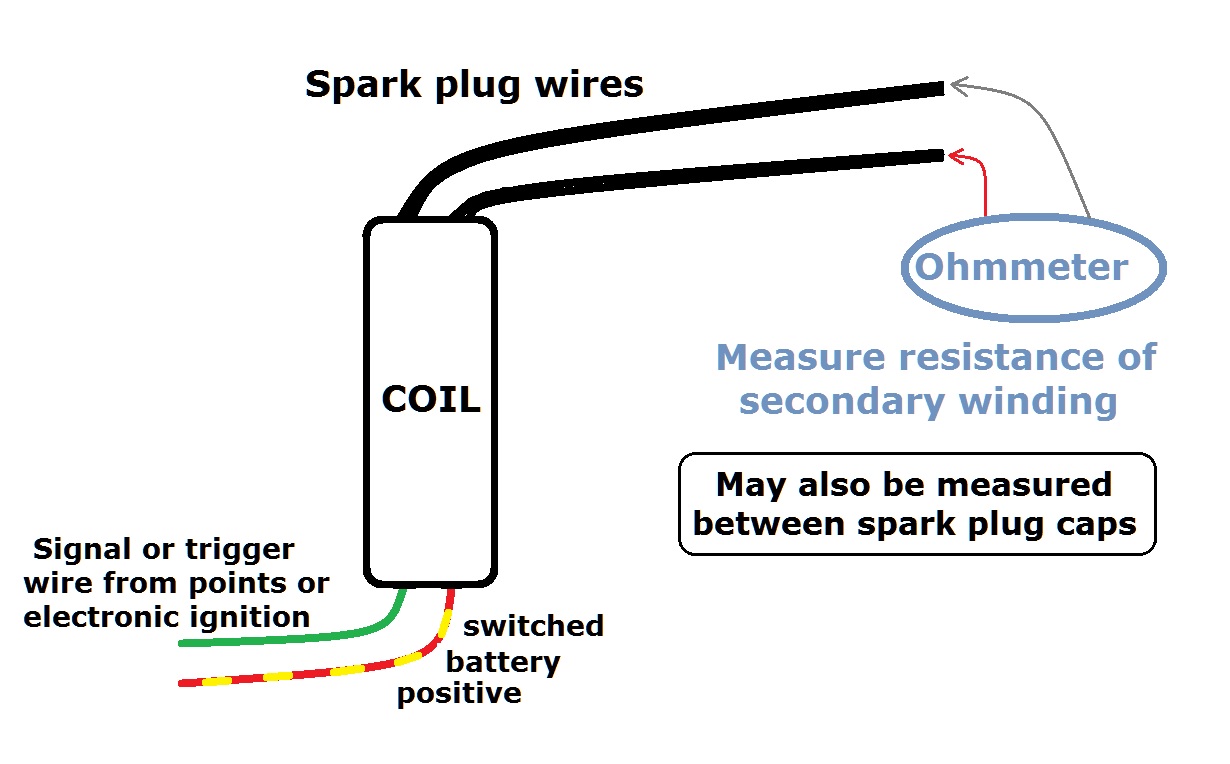

Here's a better illustration:
Given adequate voltage to a functional coil, and being satisfied as to integrity of the secondary loop, would then assure that the points are functional.
With reference to the points, closed contacts provide a ground for the coil's primary wiring (while the coil "charges").
When the contacts open, the ground is broken, which causes the charged coil to fire (discharge) through the secondary loop.
