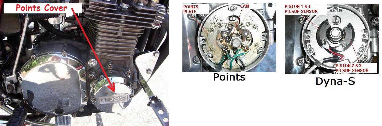

Pull the ignition cover (right side of engine). If you don't have points there you have an electronic ignition. An electronic ignition and the Dyna S ignition use 3 Ohm coils. 4 Ohm coils will work, but as bountyhunter pointed out, the spark will not be quite as hot.

The parts diagram at kawasaki.com shows 1980 KZ650-E1 LTD having a points ignition.

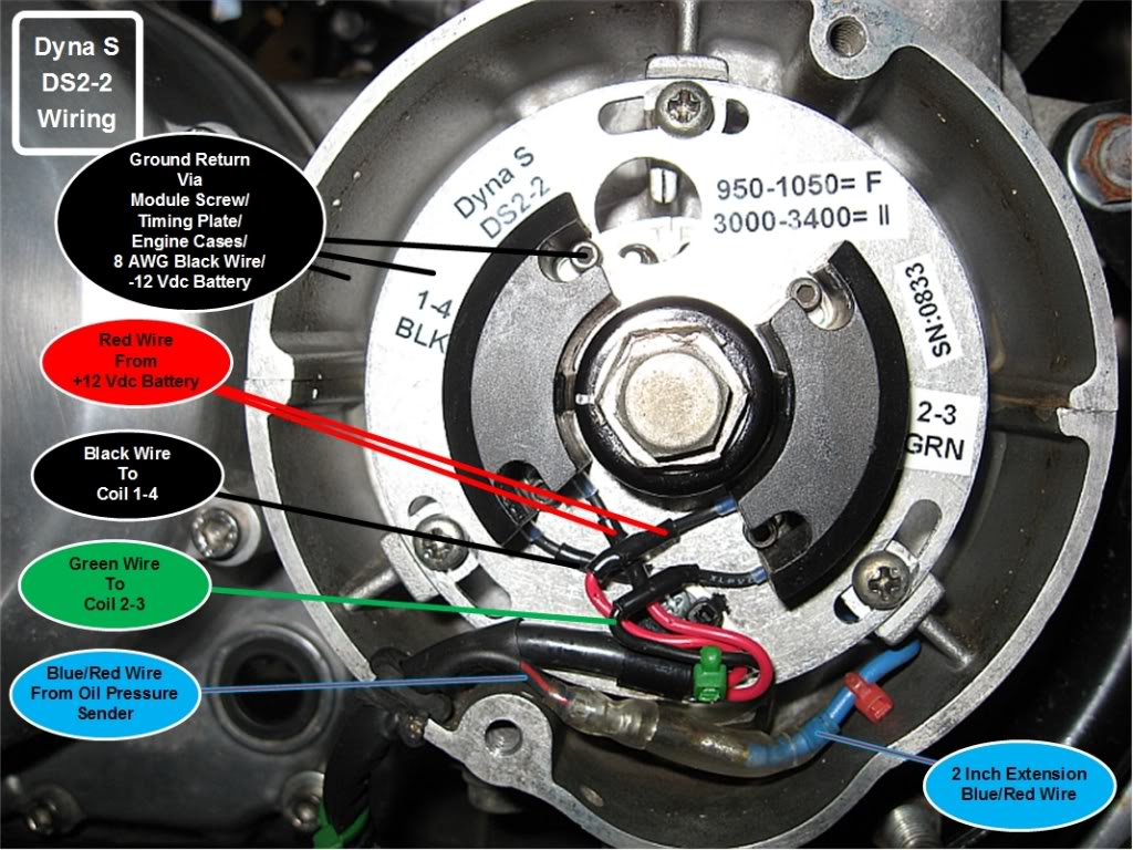

Many owners have replaced the stock points ignition with an electronic ignition such as the popular Dyna-S electronic ignition.
The above illustration is a KZ900.
KZ650 Dyna-S has another blue wire for the oil pressure switch.
