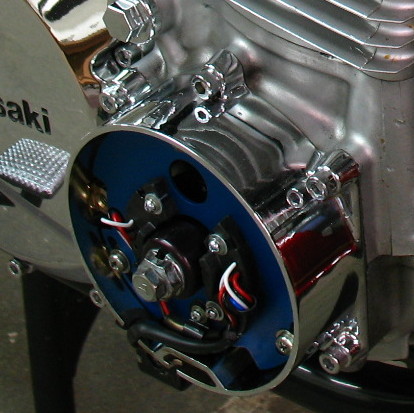

Your bike is basically the same as mine, is the ignition timing not adjustable?

chiaronate
That is correct. On the Dynatek system, the round blue aluminum plate that the pulsing coils are mounted to is slotted
at the three hold-down bolt locations to allow rotation for timing adjustment.
Whereas the Kawasaki plate has three bolt holes...no adjustment!
