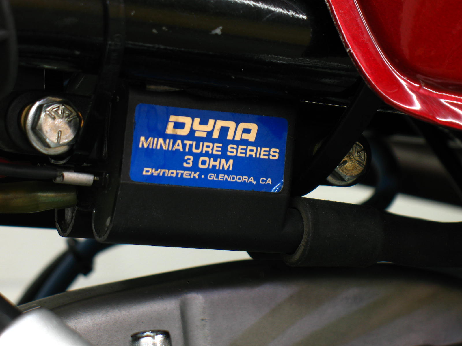

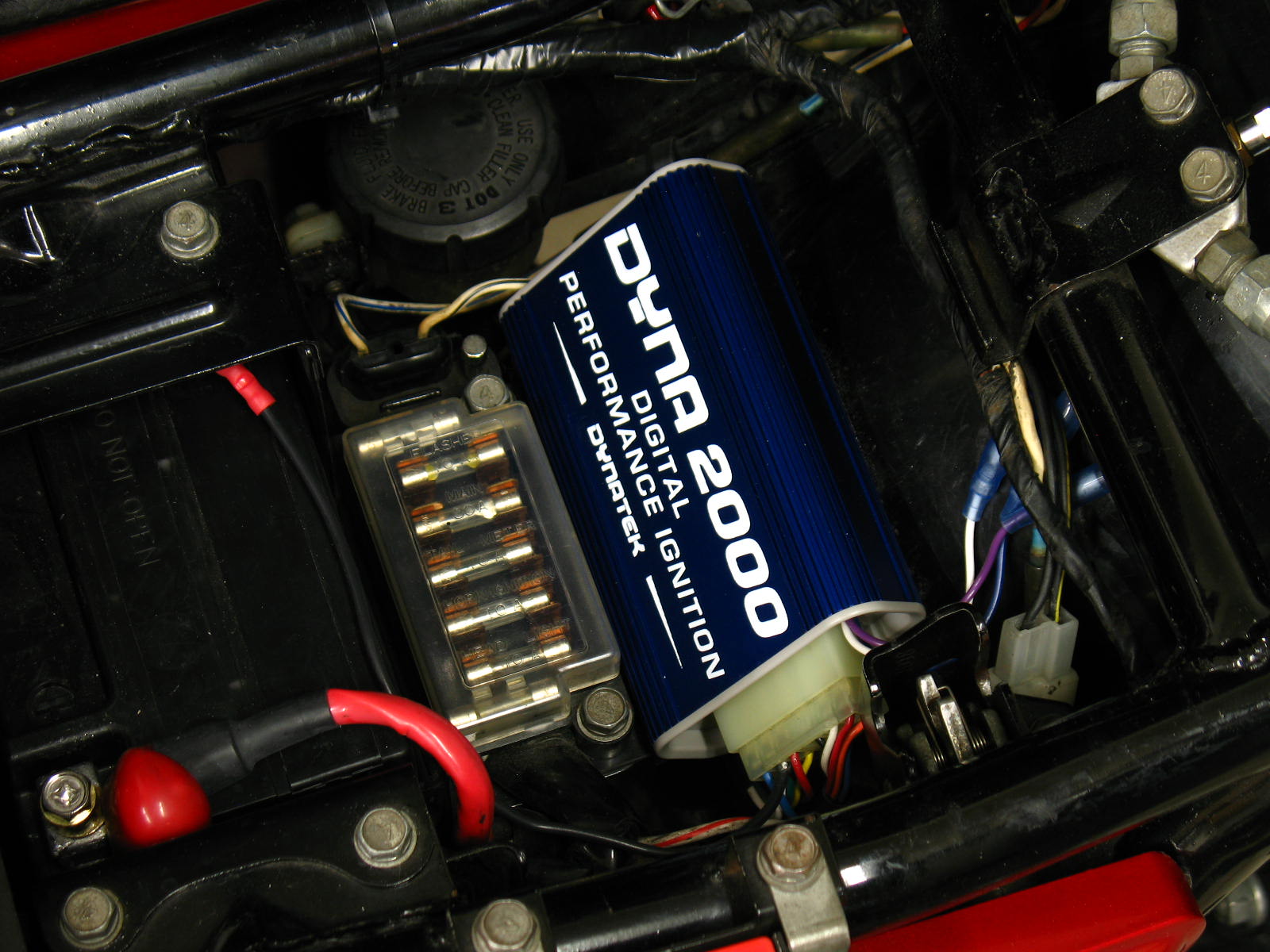

Haven't looked back, except in the mirror...

I'm with Daveo I didn't spend as much money as he did but the Dyna S and new coils has been worth every penny. It truly is a set it and forget it solution. With points you will always have to adjust them as because they wear down. Timing the bike with points always ended up with me cussing and I would rather spend that time riding. B)

Well the detonation is mostly in higher gears, accelerating at low rpm. It sounds somewhat like the metal ball rattling inside a paint can when you shake it. Hey daveo, were you having this same issue before the new ignition? Did it improve low-rpm acceleration and fuel mileage?
