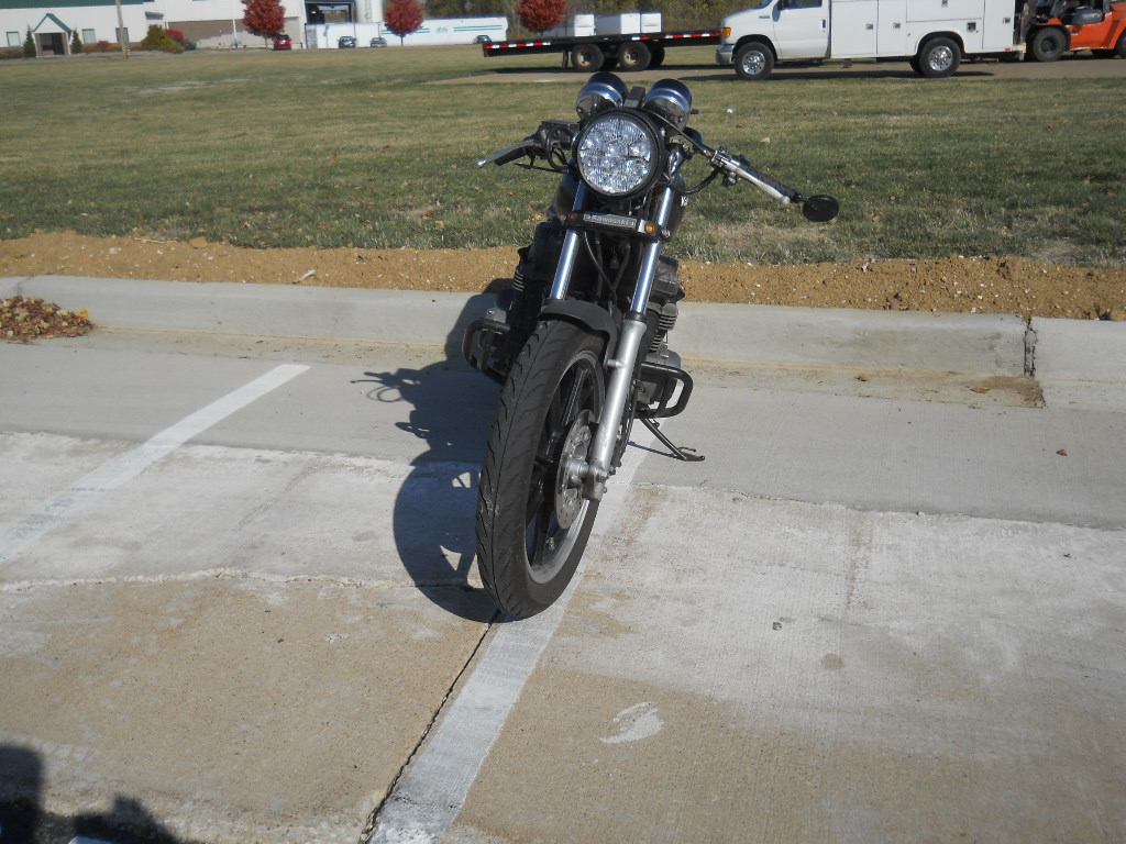

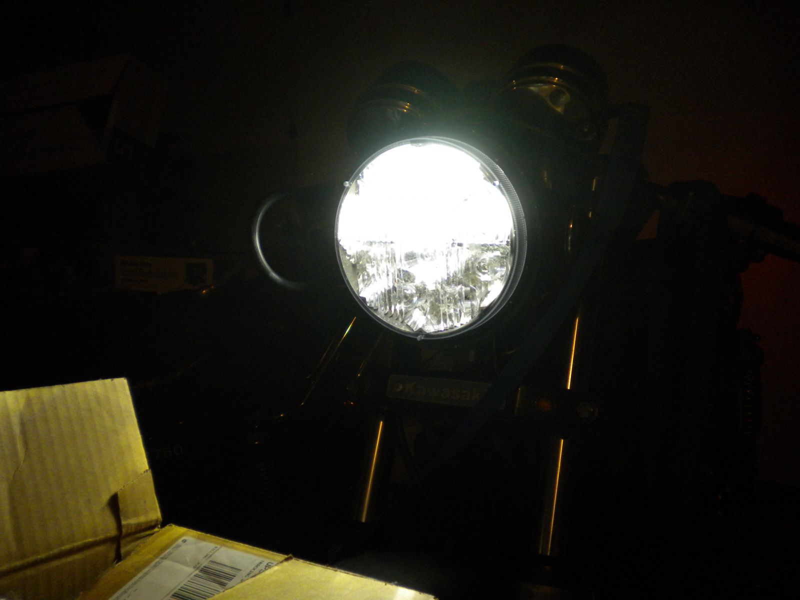

Re: any LED headlight replacements suggestions!?
14 May 2013 19:43
I have run the previous version of the Truck-lite 7" LED headlight for several years on a 80 KZ750-H1 and it works great, lots of light at night.
Flickers a little at idle but has not been a problem. Unique low beam.
