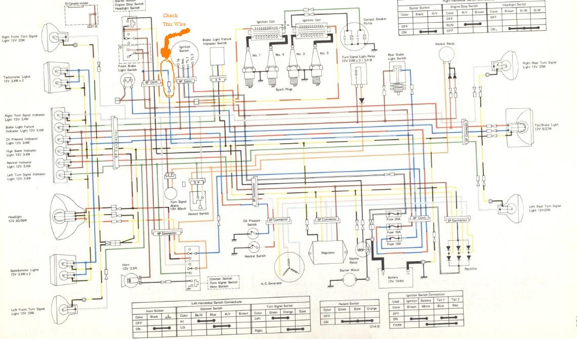

Did you check to be Sure that each fuse is good by measuring the voltage going both in and out?
On your wiring diagram check for the connection of the single blue/ white connector, and that voltage is there. This is for your head light. Should be in the head light bucket.

I got my head light issue resolved today. I checked the voltage at the fuses and I was seeing voltage going into one of the fuses on the blue wire, but not any on the other side of the fuse. Pulled the fues and it did not look like it was blown. Tested the fuse with a multimeter and it checked good. Put another fuse in anyway and the light come on when the key was turned on. I will be checking the carbs tomorrow to see if there is fuel in the bowls and also check the fuel level in the bowl using the clear tube.
