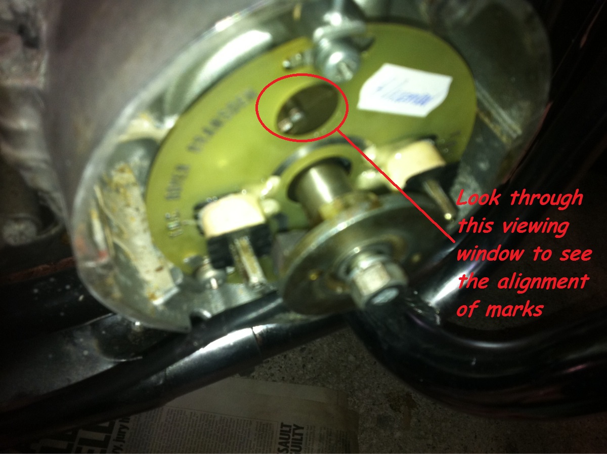

hi patton!
thank you so much, you've made this
gal very happy with your brilliant
pictorial guides!
yippeeeeer! i feel like shouting eureka!
i think i've grasped it now. in the uk
we say 'the penny has dropped!'
i need to reattach the big 17mm bolt
and then rotate the timing plate a smidge to line
the 'F' = fire to align with the engine mark.
i didn't even know that little mark was there!
on the fitting instructions from boyer, they
advise the following:-
so many degrees from TDC, it mentions
this other adjustment for the z1, z1000,
i don't know about kz750 ltd?
motorhead has been really helpful too,
many thanks. it's greatly appreciated ya all!
providing the bike starts after the static timing
is successful.

Re: kz750 ltd h2 1981 - will crank wont start fully?
13 Feb 2012 19:24
If they made the ignition system I would follow their advice. I have been performing my own tuneups on my KZ650-C1 for 35 years and never have I even heard of using a separate battery; it certainly is not required when using Kawasaki the stock ignition on my bike. All the strobe does is sense the firing of the spark plug (using the inductive pickup clamped around a spark plug wire) and upon sensing that it completes the power circuit from the battery that triggers the strobe light. I guess it's possible that the Bransden electronic components are so sensitive that they are affected when the strobe pulls power from the bike's battery. I wonder if the timing gets squirrely when the turn signals are used?

'F' stop is a long way off. please see my photos
today. the timing will be done tomorrow.
i'll bet the old gal will dinosaur roar!
many thanks for dropping in!
regards
Angel

patton and motorhead, have really sorted
my non starting bike out. my timing plate
