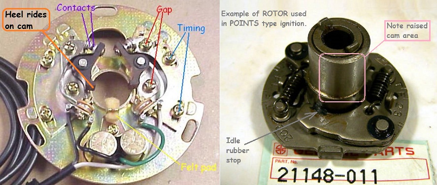

When the raised cam area passes under heel of the points, the contacts separate, which un-grounds the coil and causes the coil to fire.
Replied by Patton on topic KZ650
