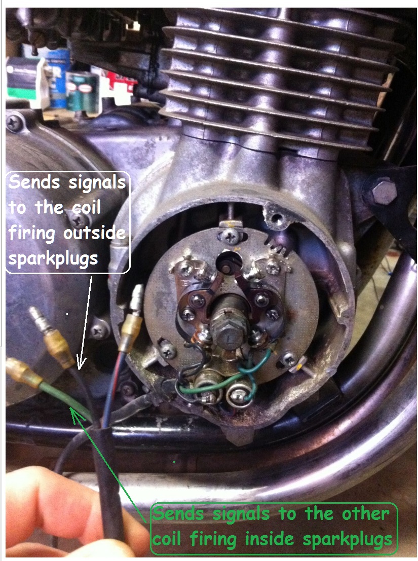

Points im guessing. Here is a picture.

yep those are points

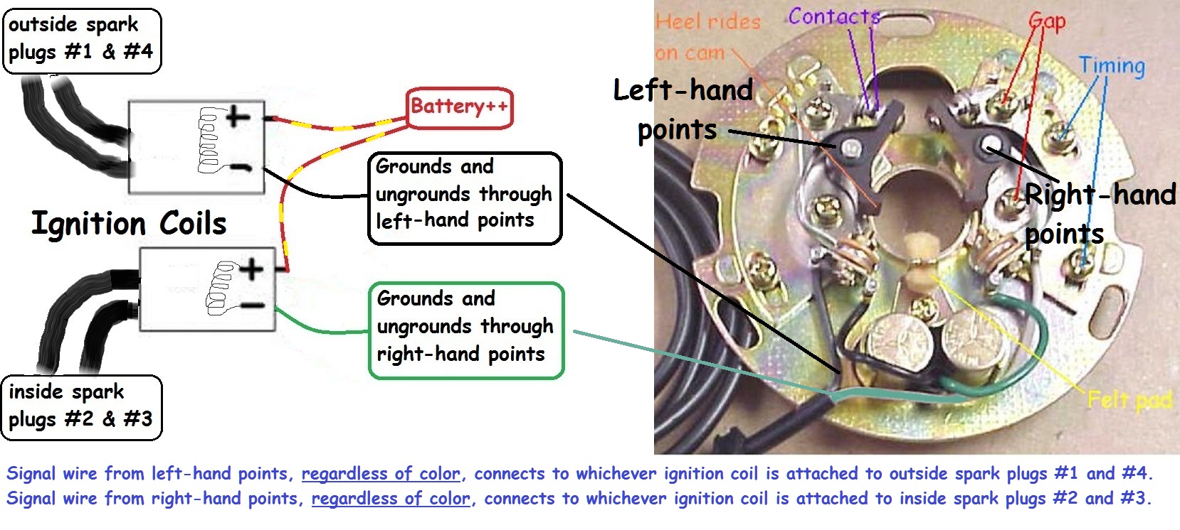

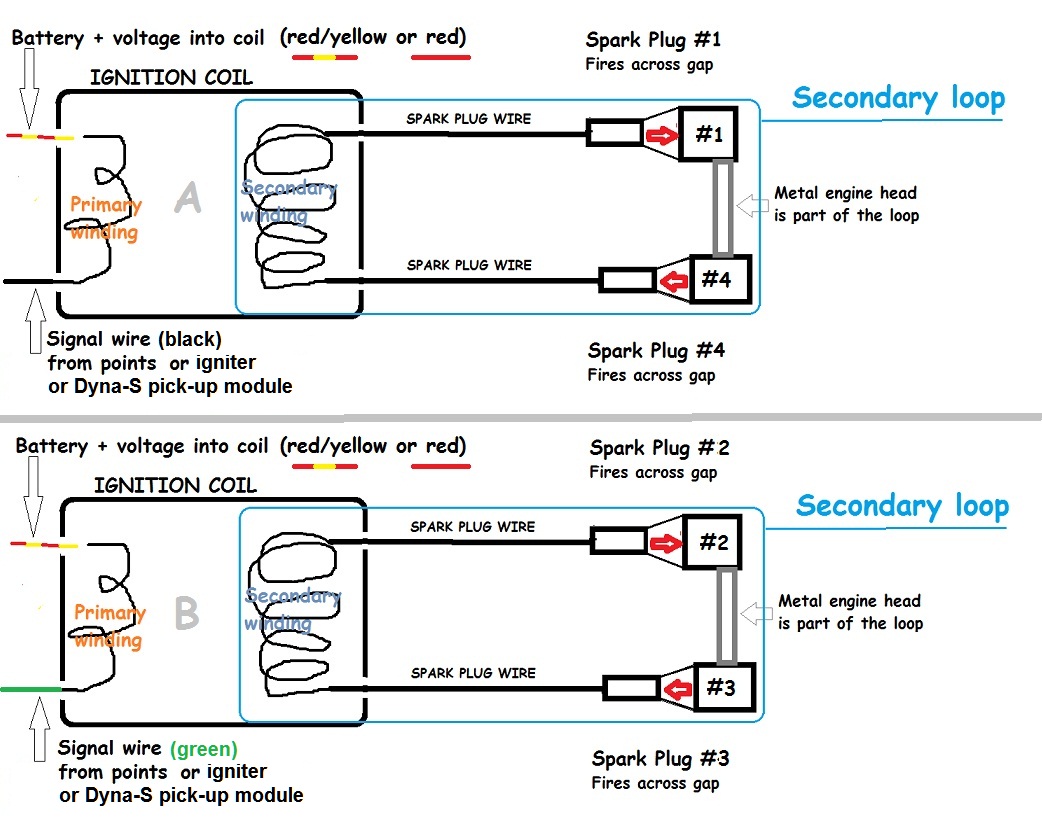

For the engine to run, its only electrical need is a healthy properly timed spark.
For now, may ignore the charging system (alternator, regulator and rectifier).
And also ignore the chassis electrical (lights, etc.).
Begin with a good fully charged battery.
A coil is grounded (and charging up) while points are closed.
When the points open, the coil becomes ungrounded and fires through the plug wires.
Many different conditions could prevent spark at the plug.

I need to pickup a new voltometer. What does the blue/red wire from the points represent. Also should i run the battery through the ignition switch before the points or straight battery to points? Thanks again
1977 650 Hardtail Bobber
1996 250 Yamaha Virago Bobber
- Posts: 18568
- Thanks: 2102
Re: KZ650
20 Nov 2011 18:07dizl27 wrote: I need to pickup a new voltometer. What does the blue/red wire from the points represent. Also should i run the battery through the ignition switch before the points or straight battery to points? Thanks again
blue/red wire from the points -- to oil pressure switch.
May remove the red/yellow wires from both coils, and provide voltage to the coils by running a hot wire from the positive battery terminal to each coil primary terminal (thereby replacing the red/yellow wires from the harness with the hot wires from the battery).
This hot wiring is like turning on the ignition switch, so don't leave the bike with the hot wires hooked up indefinitely which will burn out the coil.
Disconnecting the hot wires is like turning off the ignition switch.
Leave the black and green wires alone.
