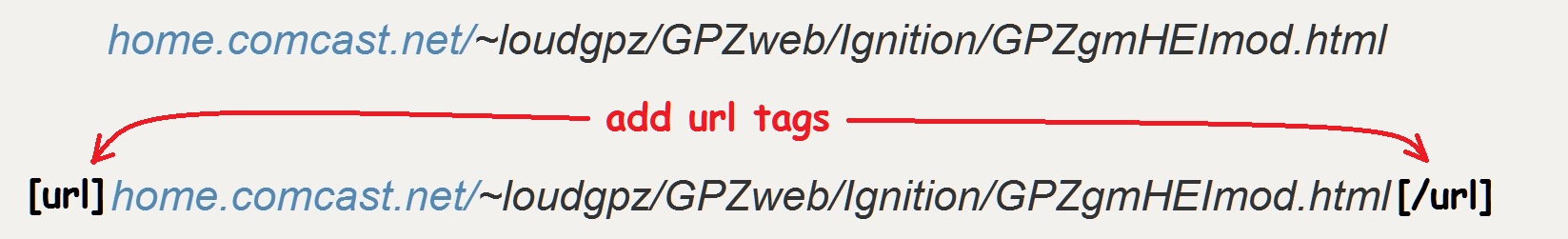

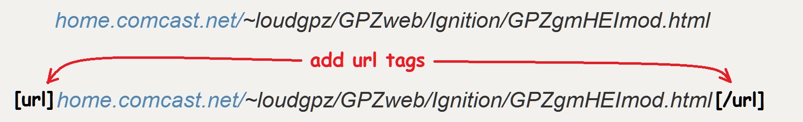

05 Sep 2011 06:14 - 05 Sep 2011 06:48For this particular link, may add url tags in the outgoing message boxotakar wrote: Here is the link for Lou's sight. You will have to cut and paste it.
home.comcast.net/~loudgpz/GPZweb/Ignition/GPZgmHEImod.html
which allows direct click without cutting and pasting:
