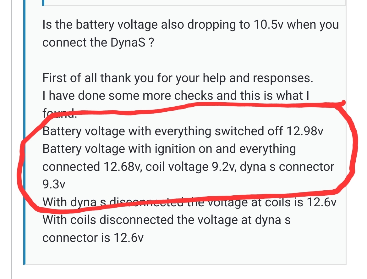

First of all thank you for your help and responses.
I have done some more checks and this is what I found.
Battery voltage with everything switched off 12.98v
Battery voltage with ignition on and everything connected 12.68v, coil voltage 9.2v, dyna s connector 9.3v
With dyna s disconnected the voltage at coils is 12.6v
With coils disconnected the voltage at dyna s connector is 12.6v

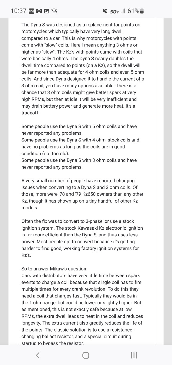

It just looks like the Dyna with the coils is pulling a lot of current.It doesn't appear as a voltage drop issue as much as the Dyna plus the coils is very very thirsty.
Your alternator will have to be able to counter the drain the Dyna puts on your electrical system.This may explain why you are blowing fuses.
I remember reading somewhere that Dyna doesn't really have a dwell. It supposedly stays on all of the time.(I'll look it up later)Yep, Lou mentioned that the Dyna sends power to the coils any time the Dyna is not firing.

I think I'm confused at way the measurements are being taken.
I'm not sure where their probes are and if everything is powered up and connected.
If their black probe stays on the negative battery post and they turnseverything on and everything is connected.
Then moves the red probe to the positive battery post.
Then red probe to the positive side of the coils.
If they get the voltage drop between the battery and the coils then I would believe the positive wire has a voltage drop issue.
They could have their drop on the ground side of the coil as well.
I read the included text in the red circle as them keeping their probes on the battery at all times.

F64
The negative lead was connected to the negative terminal of the battery at all times.
The positive lead was used to measure the battery voltage with the igniton both off and on. 12.98v (ignition off) and 12.68v(ignition on)
The positive lead was then moved to the coil terminals and then to the connector going to the dyna s. 9.2v (coils) and 9.3v (dyna s connection)
So in summary, when the voltage read 9.2 at the coils the battery voltage was at 12.68
What puzzles me is that if the dyna s is disconnected so its just the original connections going from the kill switch to the coils then the voltage at the coils is 12.6v and conversely if the connection going to the coils is disconnected so there is just power going to the dyna s then that too is at 12.6v
Its just when the coils and dyna s are all connected together that the voltage drops to 9.2v
