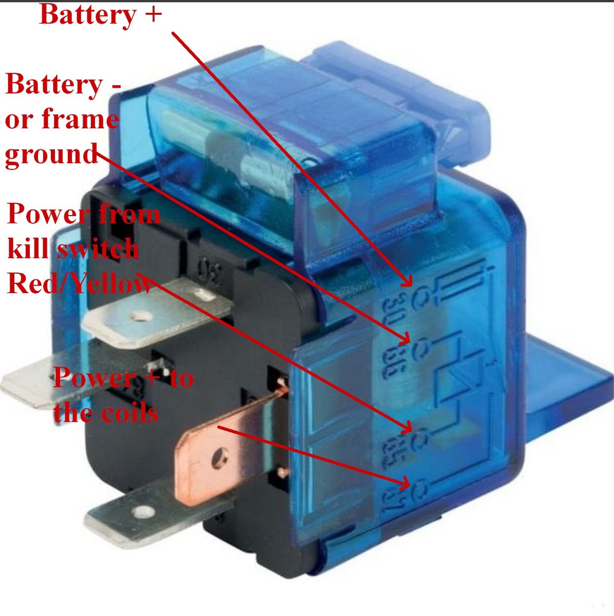

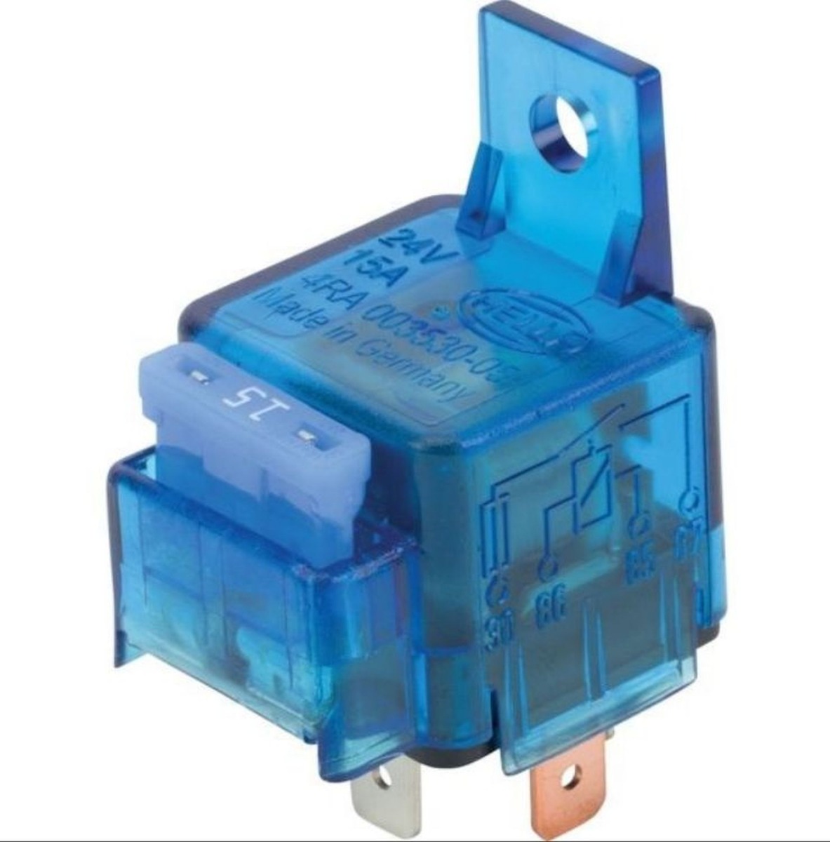

Hi all, is there a part number for the relay used with the WG coil mod?
I look on line (ebay) but see diferent spec. I dont want to buy a non suitable part.
Great idea.
Thanks
Great idea.
Thanks
- Posts: 4420
- Thanks: 2270
Re: Wired George Coil mod?
02 Feb 2021 10:34Evobobber wrote: Hi all, is there a part number for the relay used with the WG coil mod?
Great idea.
Thanks
Search: HELLA 4RA 003 530-001
