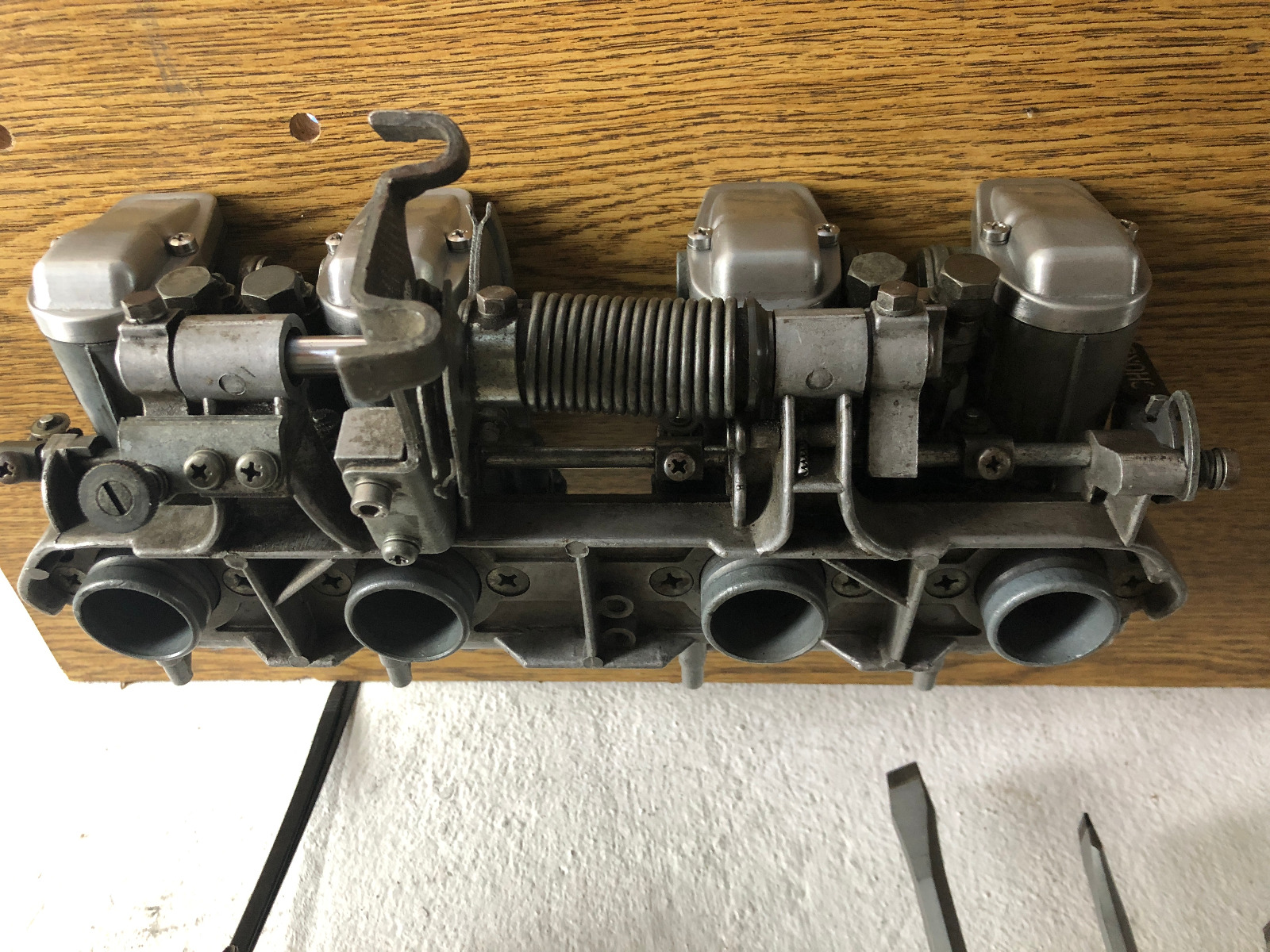

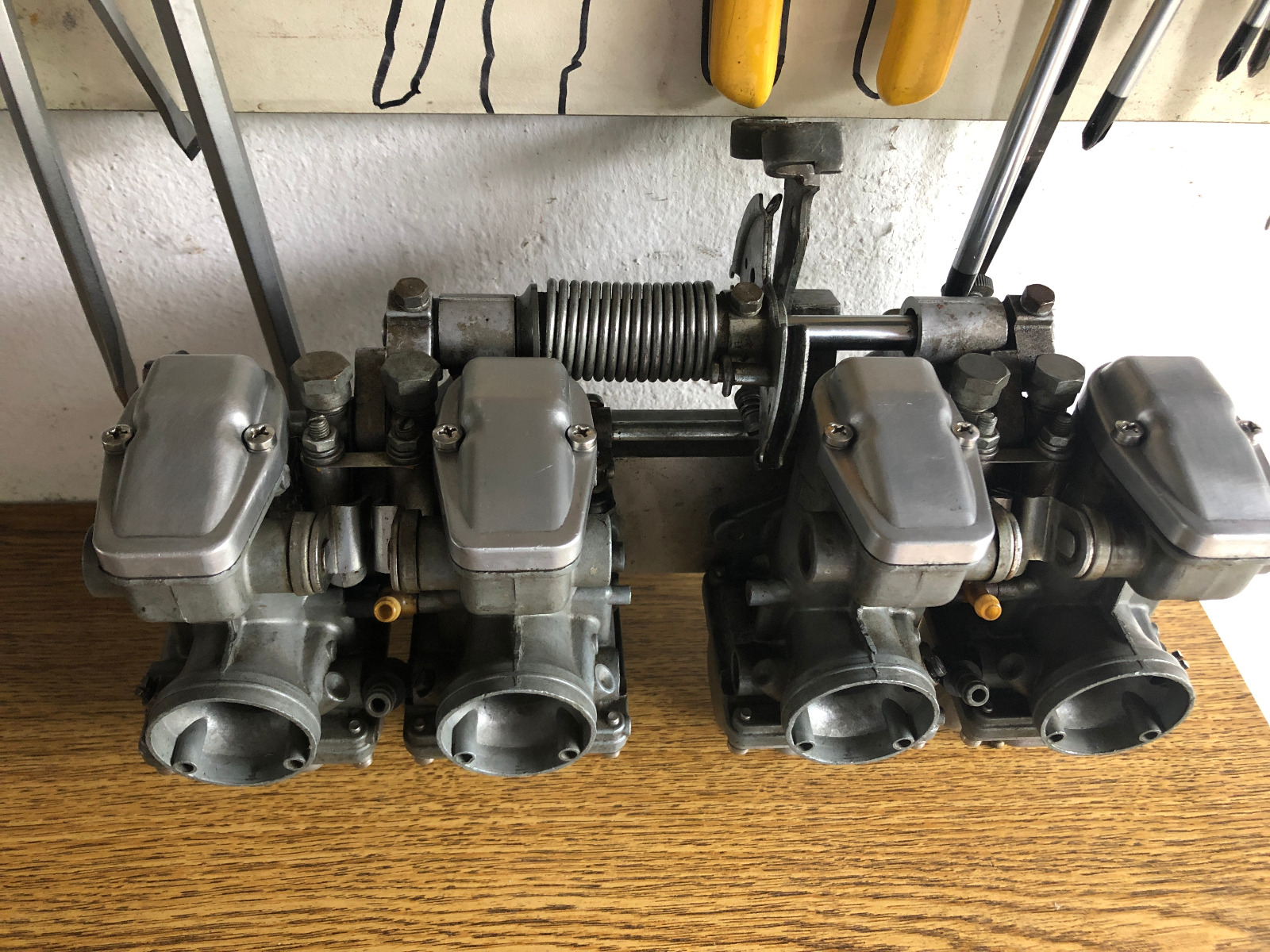

Hi everyone,
a few days ago I managed to pick up a Z1A or Z1B VM28 carburetor setup at a pretty good price.
I’ve always wanted to run these old 28mm carbs on my Z1000A2 (a combination I’ve never actually tried in all these years,I`ve just used to run carburetors like that on the Z1000 using only open velocity stacks—or just the airbox's internal screens—without the large airbox housing itself.)

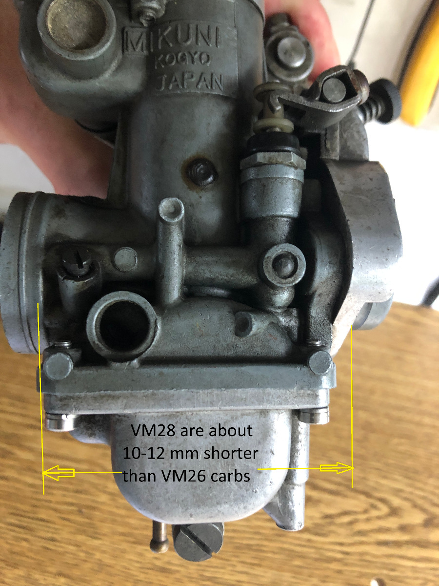

Now I’m facing a problem: The "old" 28mm carbs are about 10–12 mm shorter than the later VM26s (from the Z1000) and VM28s (from the Z1R, MK2, and ST). Consequently, the intake rubbers between the airbox and the carburetors might be—logically—too short.
Has anyone here ever run or installed these "early" Z1- carbs with the Z1000 airbox on a Z1000 ? Are there perhaps "longer" intake rubbers available for the airbox connection?

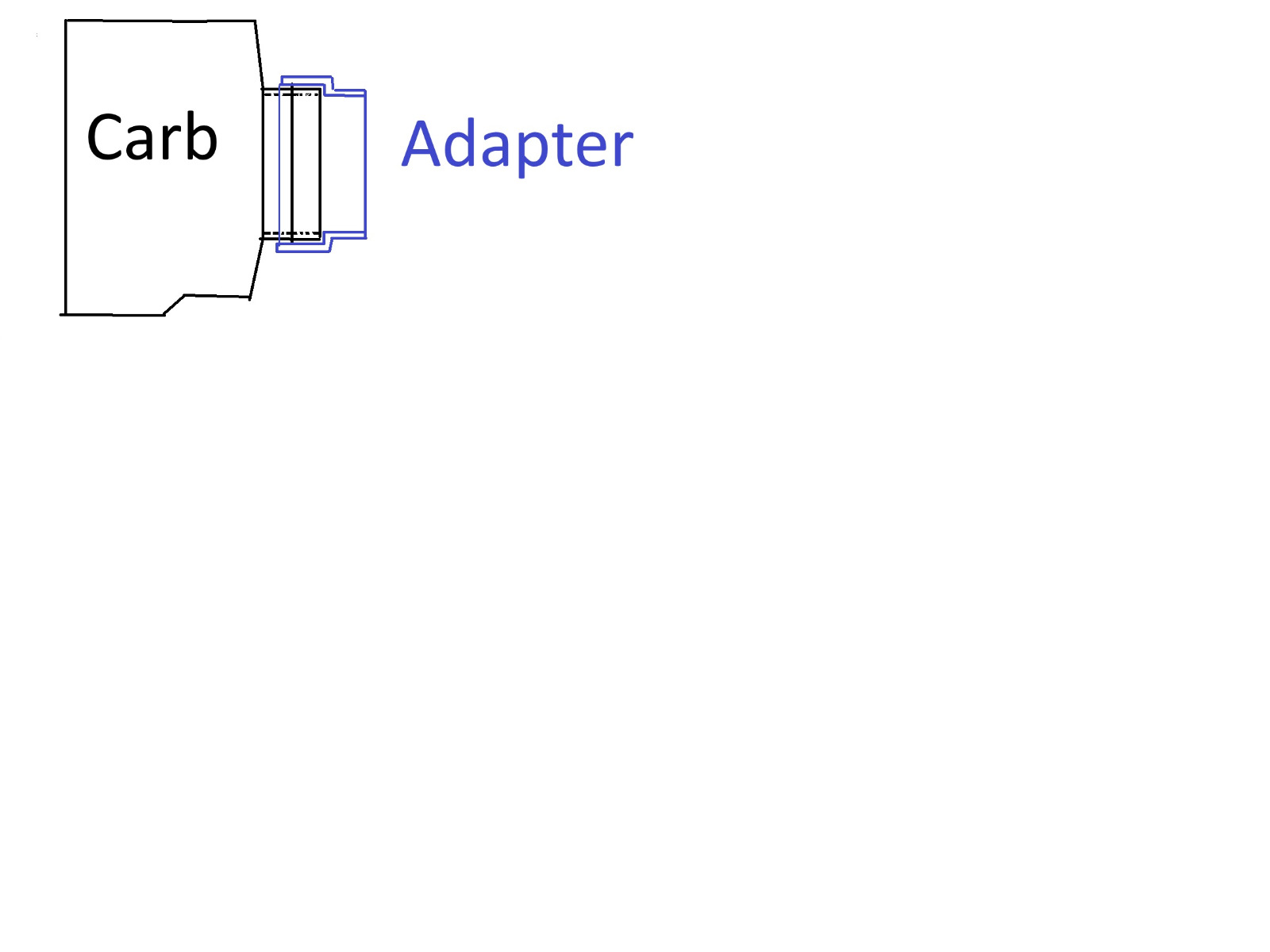

Hi Wookie, unfortunately, that’s no longer an option for me; as part of closing down my workshop here, my milling machine hasn't been operational for about two weeks—so I have NO way to do any milling anymore (sigh)... ((I’m still hoping someone buys the machine; otherwise, I’ll unfortunately have to dismantle and scrap it...))—One other possibility would be to turn some "extensions" on the lathe to fit *behind* the carburetors; we'll see how things pan out... I'm still a bit undecided!
That—sketched out simply—would be one option: if I were to machine four such adapter spacers on the lathe, I could make up the missing 10–12 mm without having to cram the airbox forward... Let's see how the carburetors run the day after tomorrow, and then I'll take action accordingly.

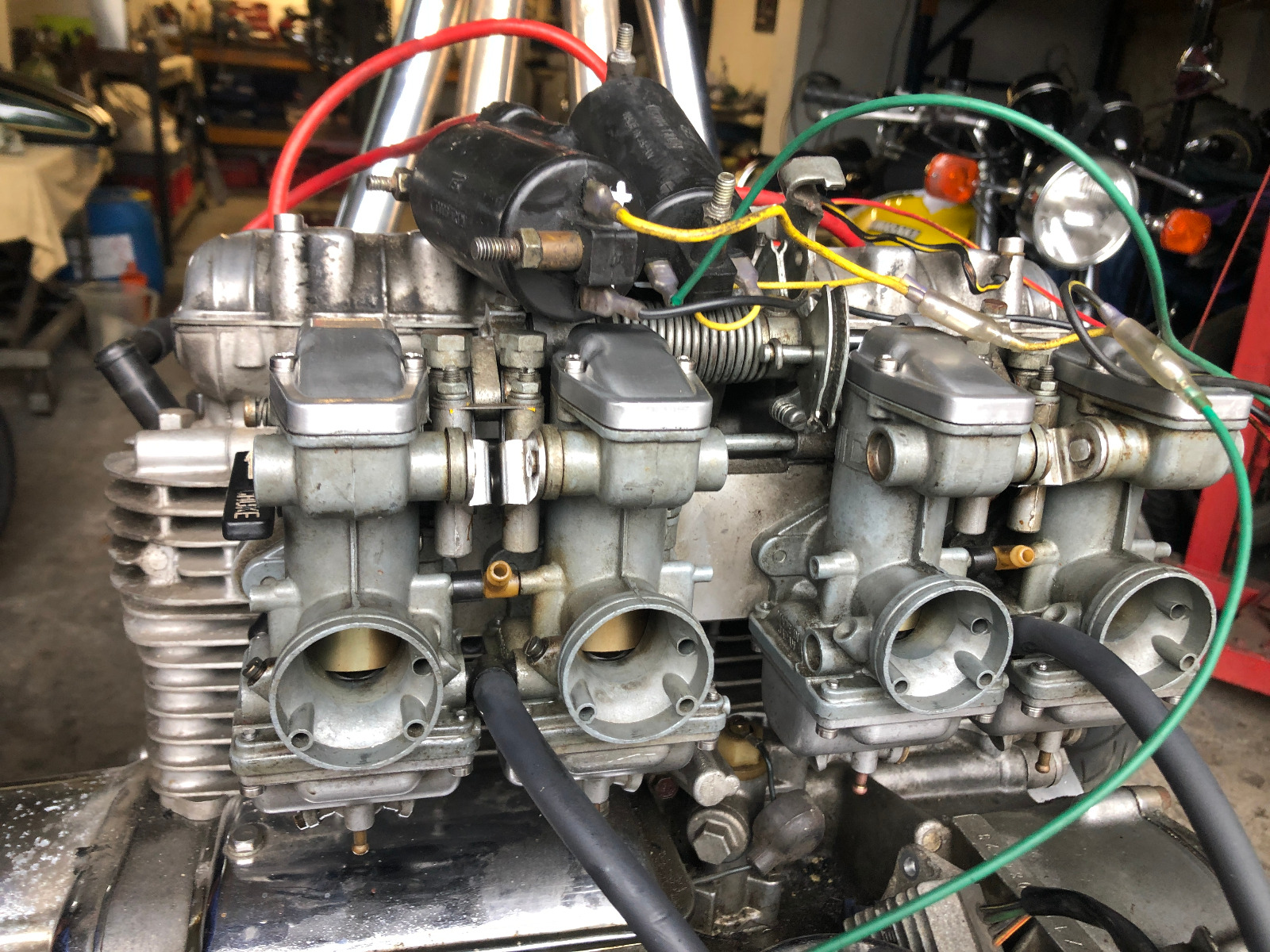

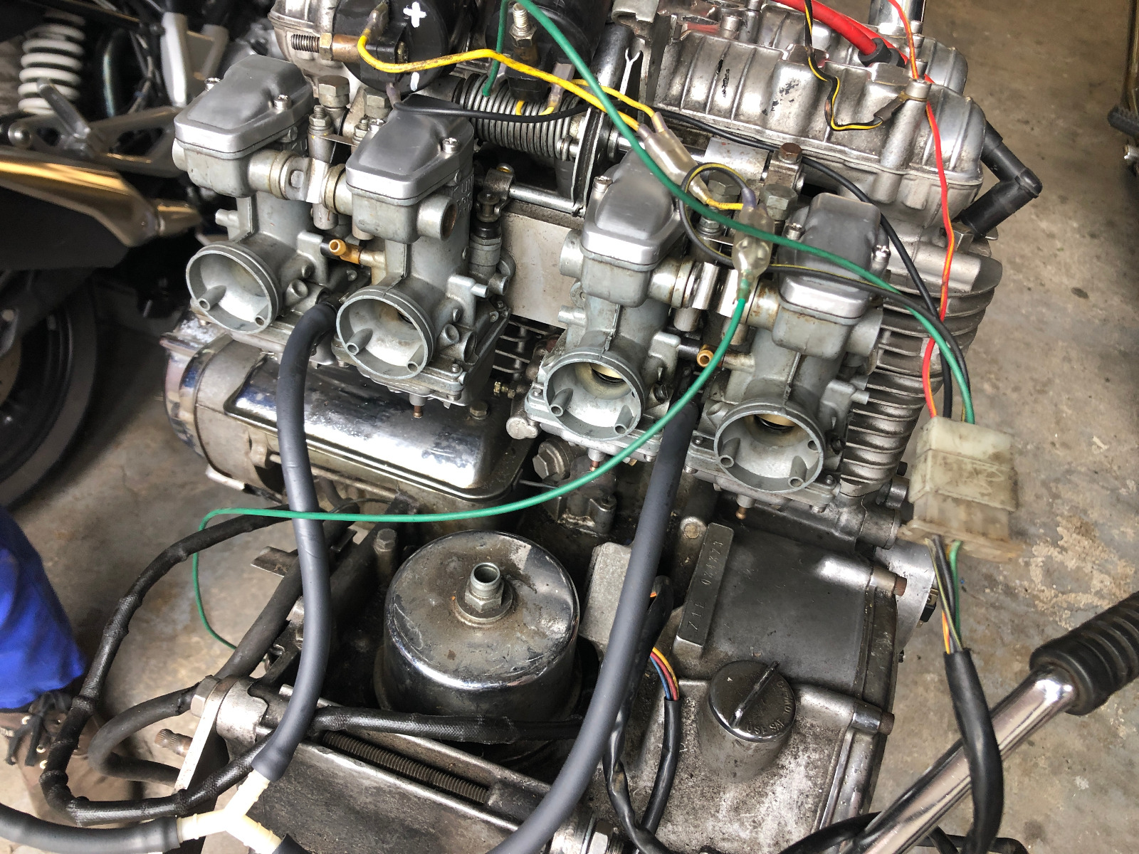

I visited my longtime Kawasaki-loving buddy again today;
he happened to have a 900cc engine set up on his makeshift test stand.
We hooked up my 28mm carburetors (I had already performed a basic static synchronization and set the float levels, with the idle mixture screws backed out two turns).
And—lo and behold—the engine fired up immediately on the second turn of the starter. After a very brief warm-up, it ran smoothly and beautifully with these carbs, both at idle and when the throttle was snapped open. A surprising and fantastic result. (There was a tiny bit of fuel seeping from the left T-connector, but it isn't loose; I think it will seal itself up again through contact with the fuel... otherwise, I'll replace it! The choke plungers also appear to be sealing well.)
Indeed, a NiZe-surpriZe !...I was absolutely delighted!
Now I can get to work cleaning up the exteriors of the carburetors a bit more and fabricating the adapters for the airbox... my plan is to have them installed and ready to ride by the start of the next biking season in March '27.
