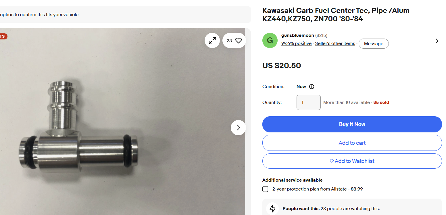

This is what I bought, I would also suggest some quality "O" rings (not the Chinese ones that come with the fittings)
For 1977-83 Kawasaki KZ1000 KZ650 Carburetor Fuel Tee Rail 92005-1010 92005-1009 | eBay UK

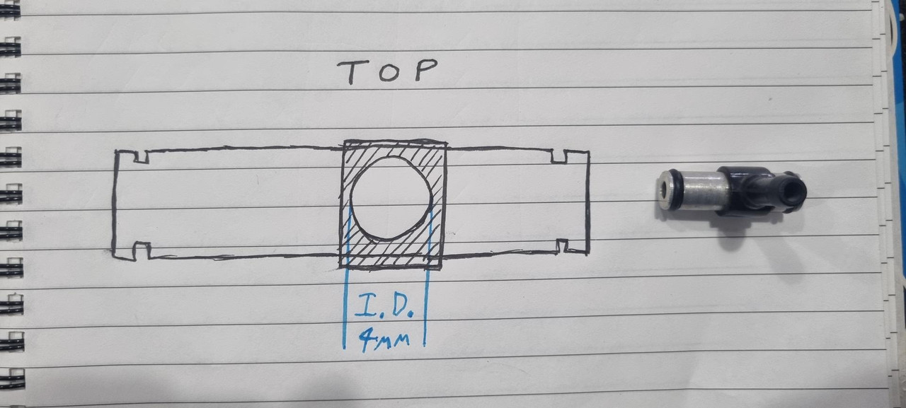

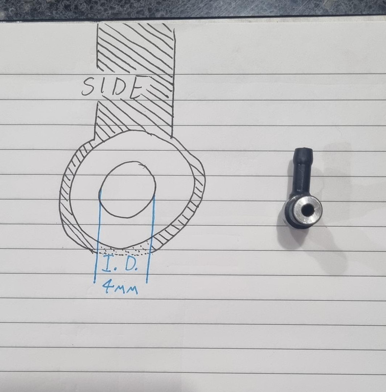

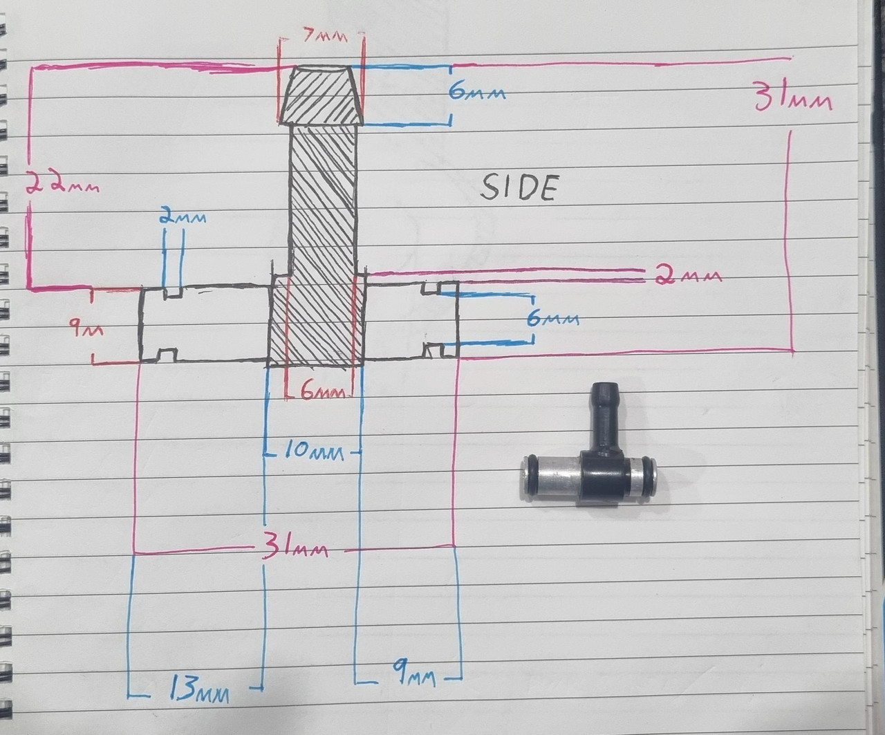

28 Aug 2026 18:48
That would be nice if its the same fitting.
Heres the measurements. I did my best to be as accurate as possible.

The 750 Tee is extremely similar. Only difference is an overall width of 32.8mm O-rings are the same.

Hmmm interesting. I wonder if the 750 fitting would have enough material to machine it down to 31mm.
Does it have around 1.8mm to spare? Maybe shave a bit off both ends?
If so im willing to try it. I've temporarily fixed the leak for now. But I 100% need a more permanent solution.
Edit:
I just realised ive put down overall length 31mm but when I add the separate sections I measured, they add up to 32mm. So its probably not far off. Will look into it further.
Edit:
