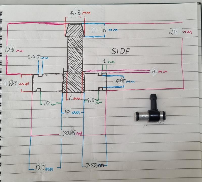

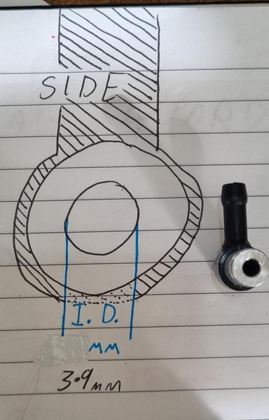

I'm chatting to a machinist at the moment about making up a new piece. If its a success il share links and contact etc so others can order one if they need.
also I was able to use my caliper to measure it this time. Man, my eye balling was way off. Haha. To be expected. Measure twice, cut once.
heres the more accurate measurements for the tee

That Tee uses the same O-rings as the 750. That means that the 750 Tee will work on your bike, assuming it's not too wide. Find an aftermarket Tee with enough length to be shaved down as needed and you should be good to go.

I'm actually chatting to the same guy who makes the 750 tee. Same guy from the link you posted. So cheers for that.
Fingers crossed he can make it up. Would be a huge win for us baby z owners to be able to buy this unicorn part.

So, it turned out my digital calipers were off.
measure twice cut once is great if your tool is accurate.
sigh. Take 3. How frustrating.
Sometimes I wonder how I even get my pants on in the morning.
