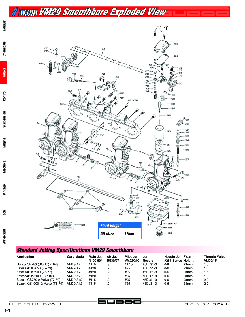

This is from the Sudco Mikuni book for reference. Floats were all done to exactly 23mm as advised in a previous post.
