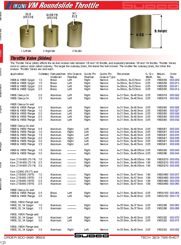

This is from the Sudco Mikuni Manual :
You have to take a slide out of your carbs and measure it, then see what may work. There are several OEM Kawasaki slides on that list.
Suzuki also used Mikuni, but unless someone with more knowledge on Suzuki carb spares speaks up that may be more of a gamble. I am not sure why only Kawasaki is on that list.
Mikuni quantify the cutaway size as fuel flow VS throttle setting.

29 Jul 2026 07:17 - 29 Jul 2026 07:27Mikuni is showing the % difference in fuel flow (wet state) VS throttle setting so it would be hard to express the same thing in AFR (burned gases)I have 1.75 cutaways write on them! Do the 2.0 can make a great difference or probably just raise my 10.5 to 11:5 ?!
It would be hard to tell what kind of difference that would make.
Measure the slide first and see what you have to work with off that list and how much its going to cost. Those slides might end up to be $50 each if you can find them.
How is the bike running now? Can you notice when its rich?

I just did a quick search on that Mikuni VM28 part number but it is only offered for individual bodied carbs with the idle slot - not the one you need.
I did find one listing on Ebay for the early Z1 (search vm28/210) at 3.0 cutaway ($42 Can each) but he only have 3.

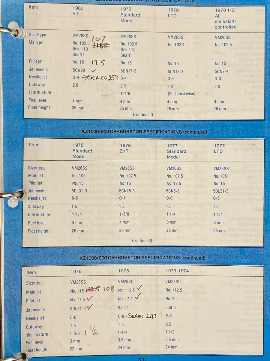

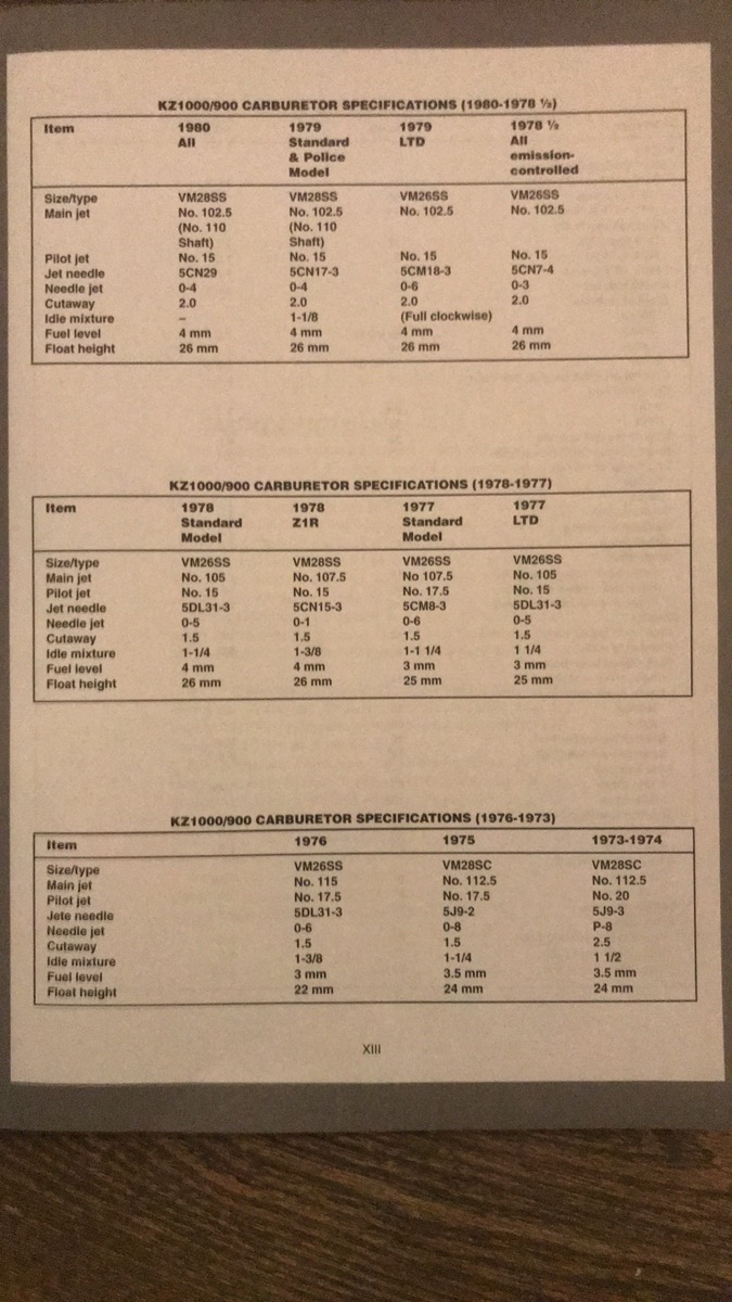

29 Jul 2026 07:41 - 29 Jul 2026 07:54Maybe someone on here might have spare slides at 2.0? That 1.75 was a custom part for the bike model tuning which can vary by model or year.Yes thats what I found !! Thank youu very much
Just found this stuff :
See some 28's at 2.0 and 2.5 cutaway.
I don't see any Kawi 28's at 1.75? Is it possible you have some Suzuki carbs? Maybe off a 750?
