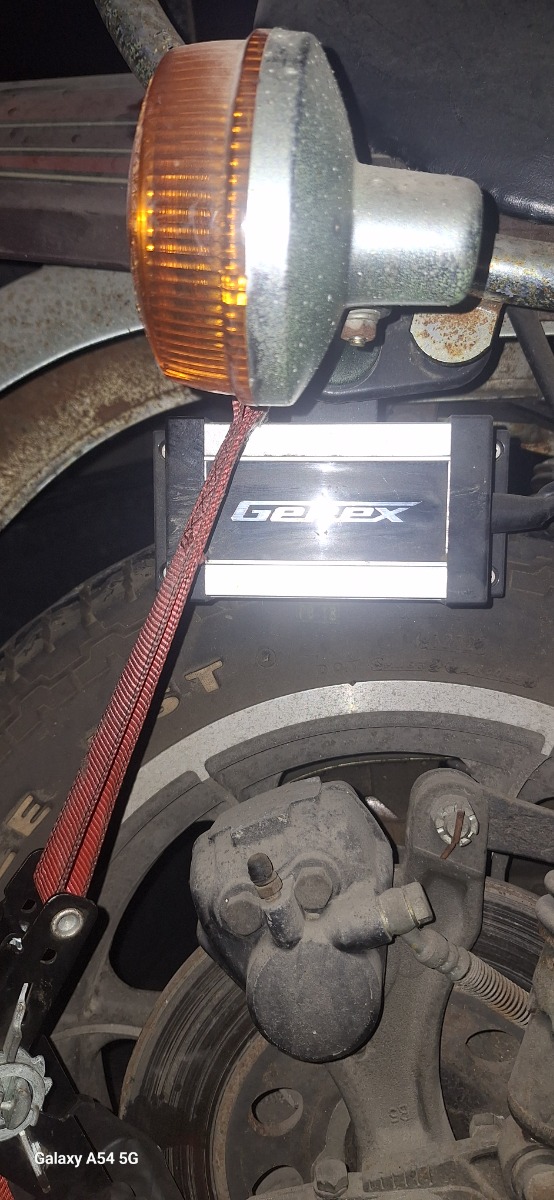

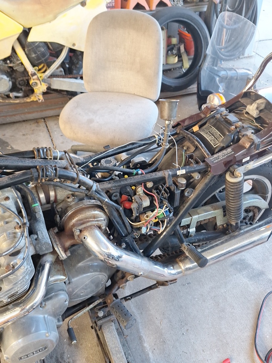

Yes, Gerex ignition with coils and spark plug wires. It's set up a little hokey with the duct tape and zip ties.
I'm waiting on a Caswell epoxy tank sealer after cleaning out the tank of rust.

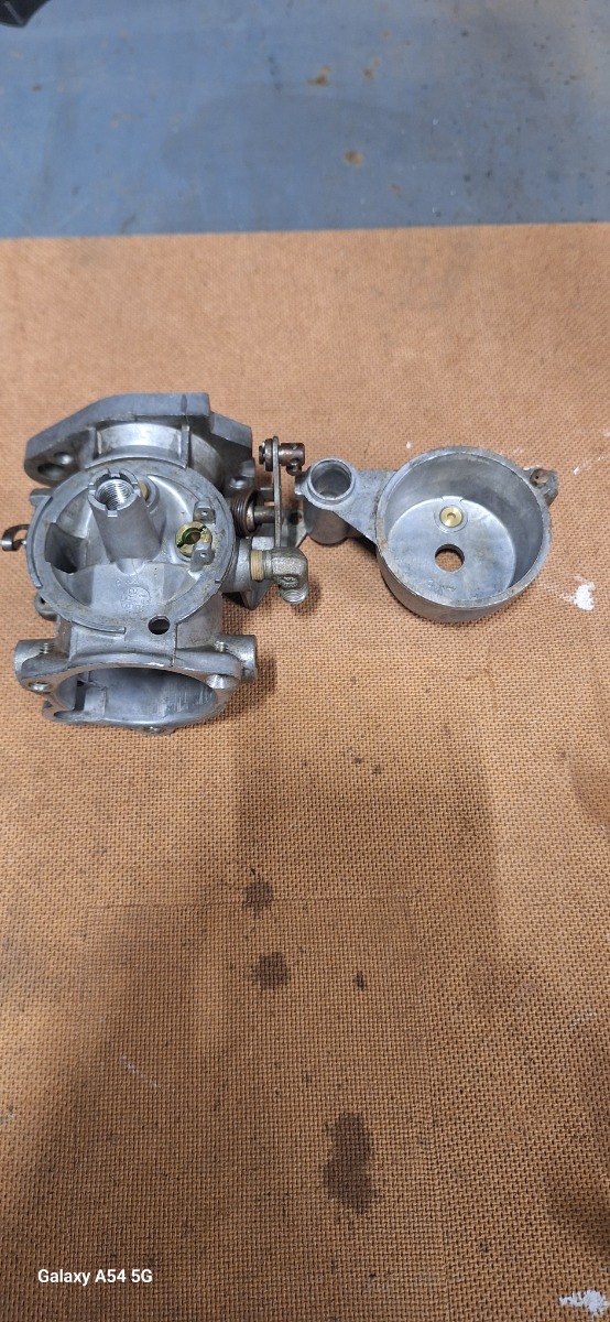

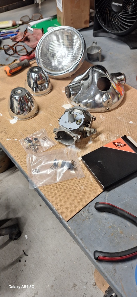

I'm waiting on a carb rebuild kit after taking the carburetor out and cleaning it.
I'm still deciding about a fuel pump and regulator replacement, plus maybe a pingle fuel petcock to prevent fuel starvation, hence the ultra lean fuel ratio the turbo can produce under boost. The Zenith/Bendix carb on the bike was set as rich as it could go. Maybe overcompensating because the top end was clearly rebuilt through viewing the cylinders with my endoscope and the base gasket.
Waiting on parts, cleaning the rusty chrome with 0000 ultra fine steel wool and chrome cleaner. Still pitted, but shiny. That's what happens when even though it was in a shop, it's near the ocean.

I took a chance on the J&P 38 mm Bendix carb rebuild kit hoping the bowl gasket was the same as a 42 m carburetor gasket, and it was.

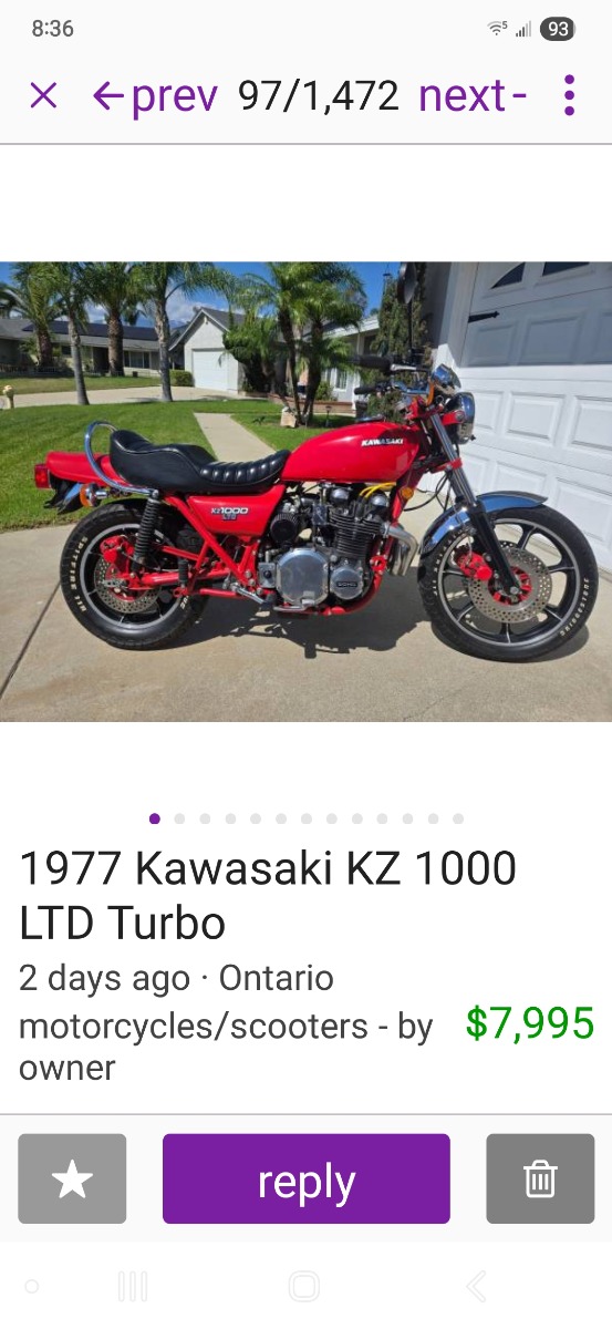

The red turbo cuz he 1000 LG is awesome bike way cheaper than it should go for look at about craigslist Los Angeles

I did get the bike running a couple of nights ago. Gravity can, big gap (.067") on the plugs. Reset gaps to .039" the next day, and it started much easier and ran much better. I'm still deciding what fuel pump and regulator to use. There's still a long way to go before I get it on the road again -- brakes, fuel tank, etc.
These turbo setups are new to me, so I'm still learning.
I'm ordering and waiting for parts, cleaning up what I can in the meantime.
Oh by the way, I uncorked it to start it. Not as loud as an uncorked Kerker, but still shakes the ground.
Until the next update, Rock on!
