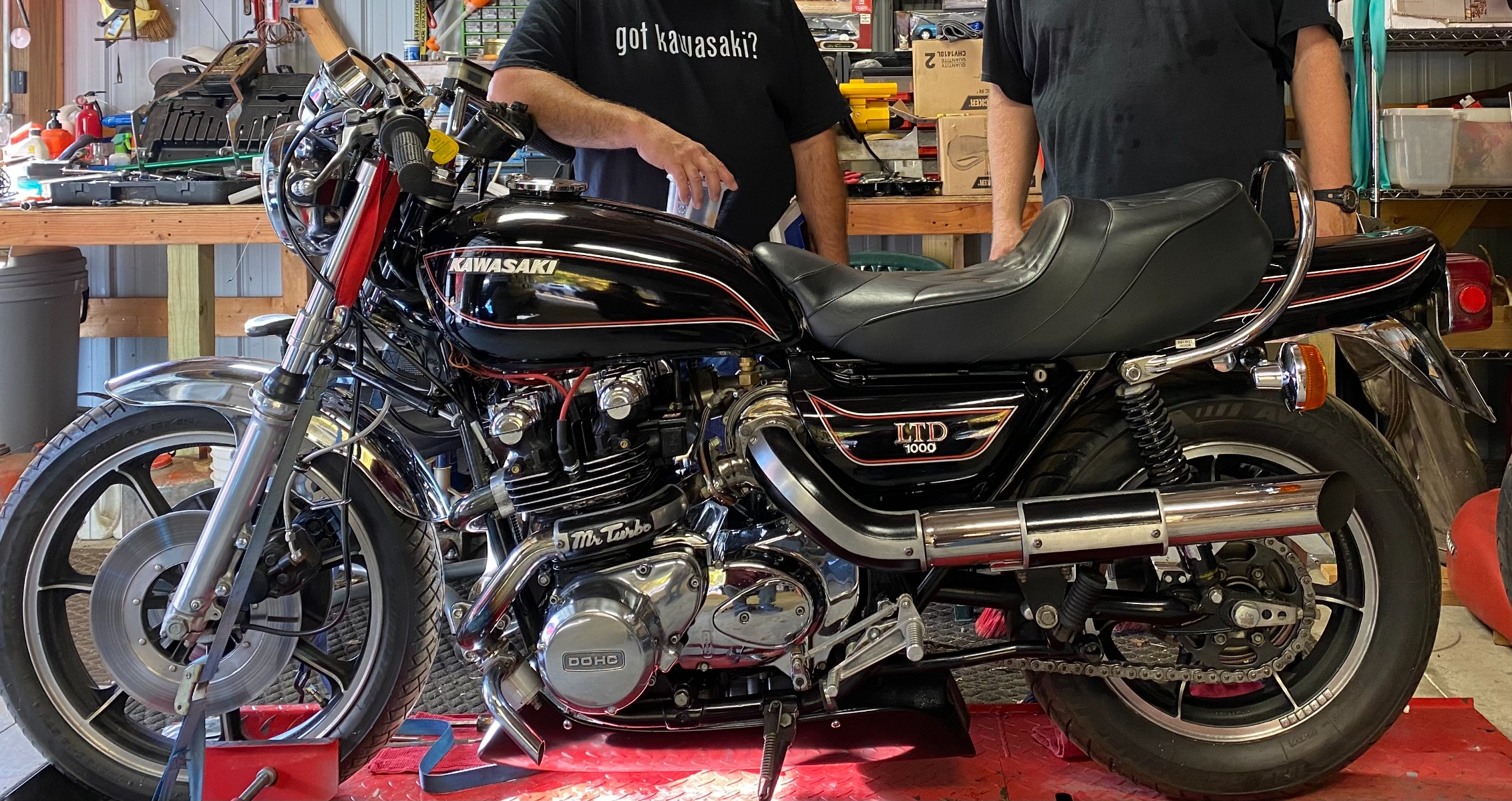

PS I also use a Pingle fuel petcock to control fuel flow
Last edit: 02 May 2026 16:52 by Street Fighter LTD.
- Vinsky
- Posts: 122
- Thanks: 131
Re: Turbo Pack fuel pump and regulator
02 May 2026 18:56

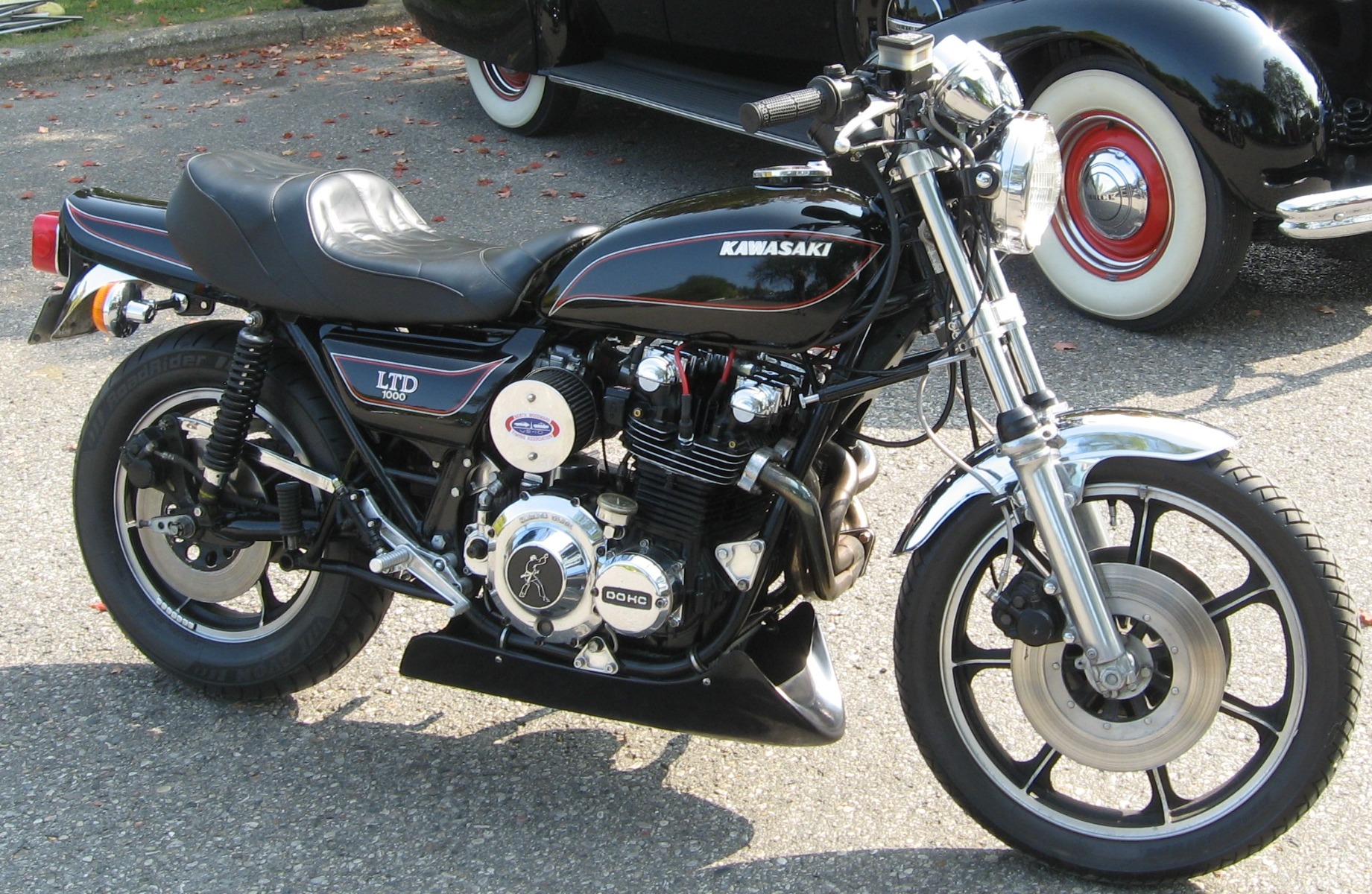

Is that a Gerex ignition box on the left rear side? Smart to keep that box cool.
