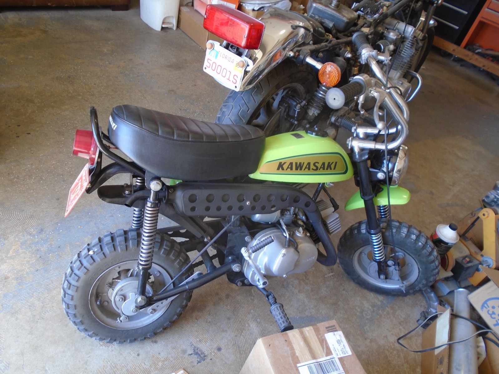

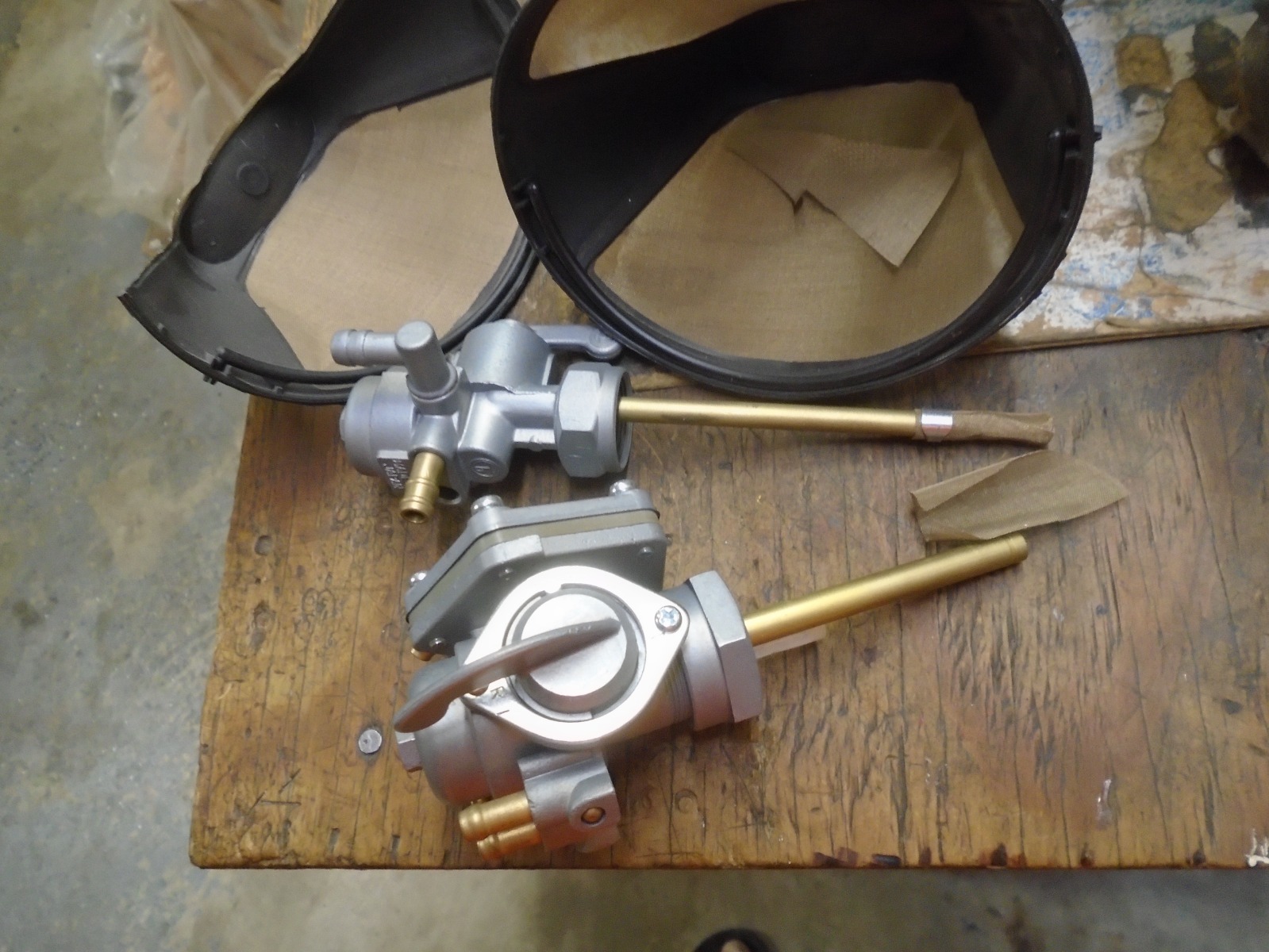

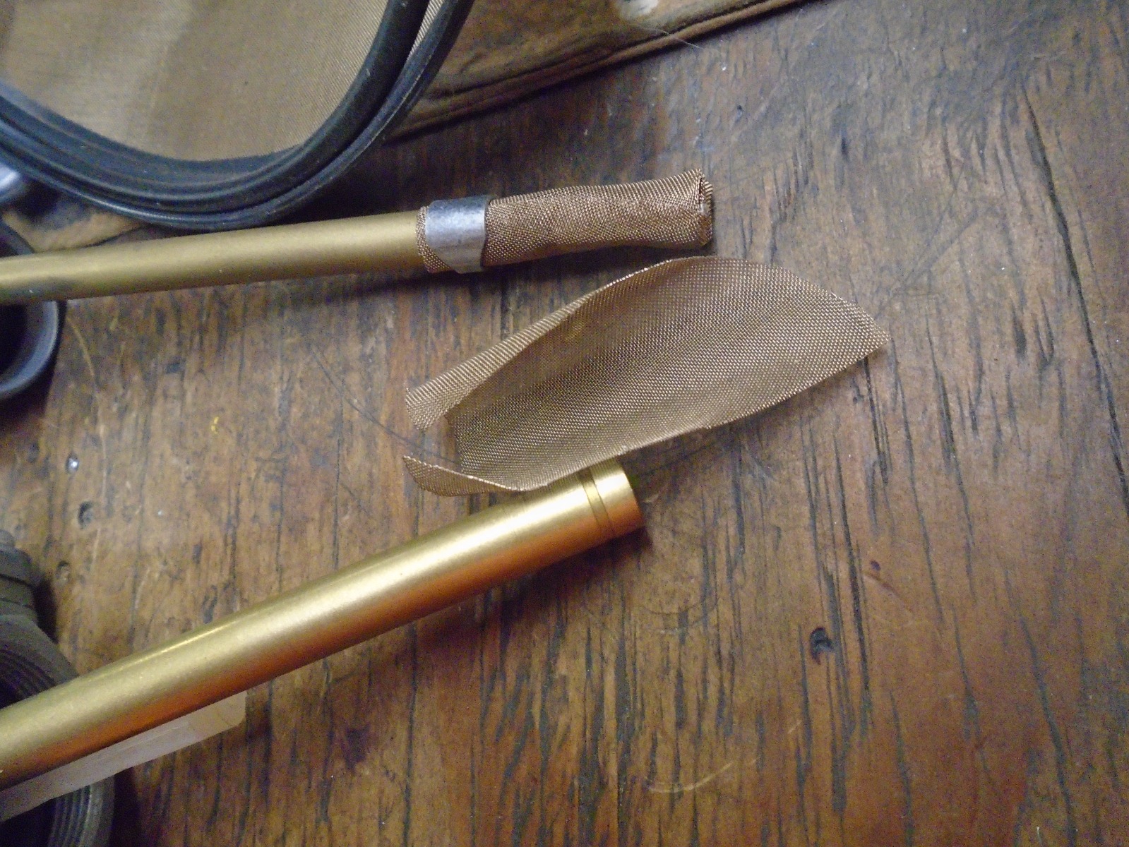

Info if it helps. Because i work on such a variety of machinery, sometimes one has to adapt and overcome for NLA or things never offered separately without purchasing the whole unit. My take on "pre-filtering" before crap can even enter the fuel path. I've been "rolling my own" filter socks for years using Cuisinart Stainless Steel mesh coffee filters. Cut it, roll it and smash over the end to seal it. Then use an appropriate band to clamp it if used on a petcock brass tower. Because i do a lot of the John Deer tractors, also for them. They didn't originally come with ANY filter on the pick-up tube and all it takes is a piece of leaf/stick to stop fuel flow altogether. Soo while not "directly" related to original topic of inline filters, still applies to undisturbed fuel flow. Even made one for this Kawasaki 1971 MT1 i restored. Multi functional tech!

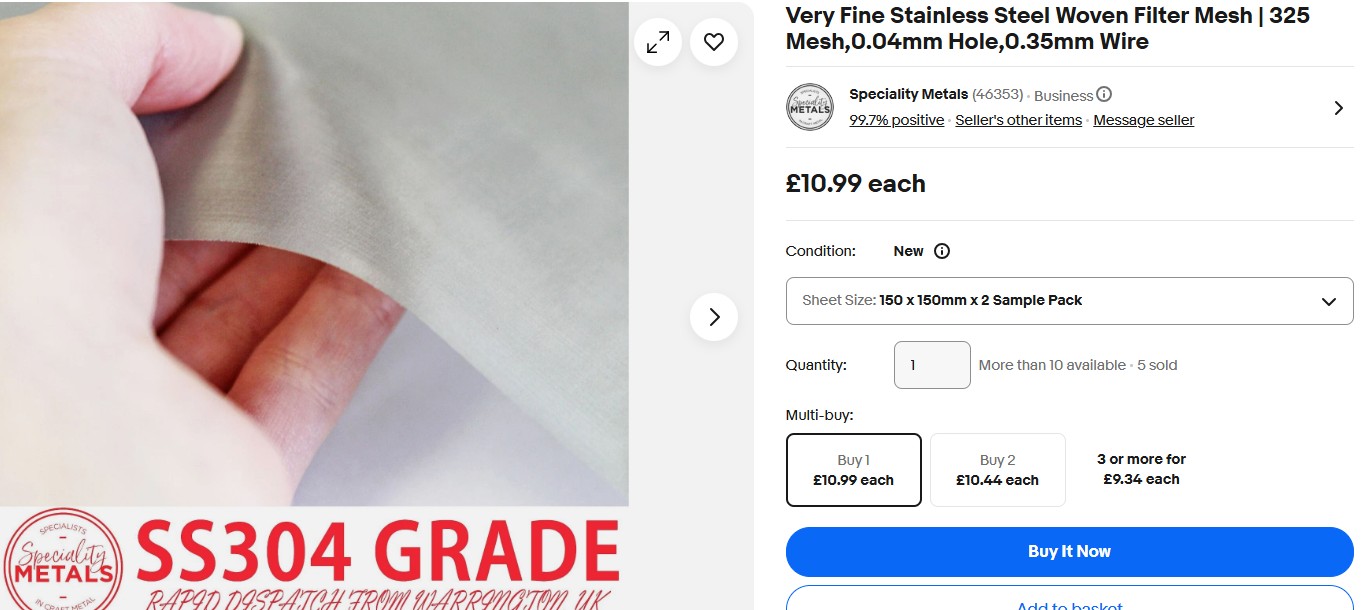

I used this to filter my cerekote clear (less than half the price of a 325micron filter from cerekote)
