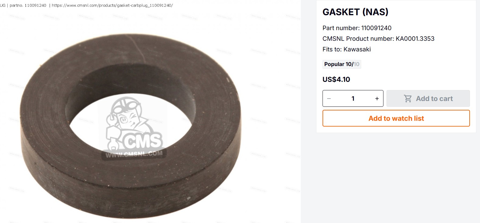

- Posts: 6553
- Thanks: 4141
Re: Pilot air screw
02 Mar 2026 12:24GD4 this missing part is the belowNot sure if this will be of any help or not, but both the plug (part# 92066-1087 at $4,74 per) and the o-ring (part# 92055-1059 at $8.96 per) are both listed as in stock on Partzilla.
www.partzilla.com/catalog/kawasaki/motor...p19/carburetor-parts
- Posts: 6553
- Thanks: 4141
Re: Pilot air screw
02 Mar 2026 12:27That's interesting Clay, mine has hard plastic rings whose only purpose seems to be supporting the gasket over the plug recess as the gasket seals around the plug recess ??Aw-ha. You're talking about the pilot bypass drilling plug, get it now. You said center in photo, regardless. Just set it in casting and use an original square o-ring or a similar round oring that fits tight around the carb casting insert. All this does is seal off possible suction from air/fuel, not that critical. They weren't plastic but rubber, duplicate along all 4.
