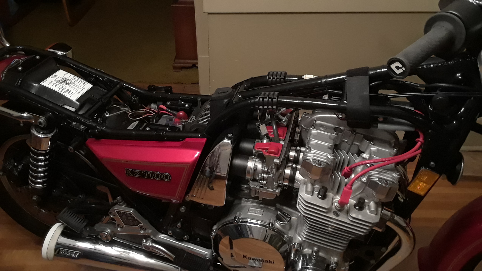

Wow, that bike is incredibly clean.  Well done!
Been playing with her jets, and loving on her engine's, for twenty-five years... 🥰

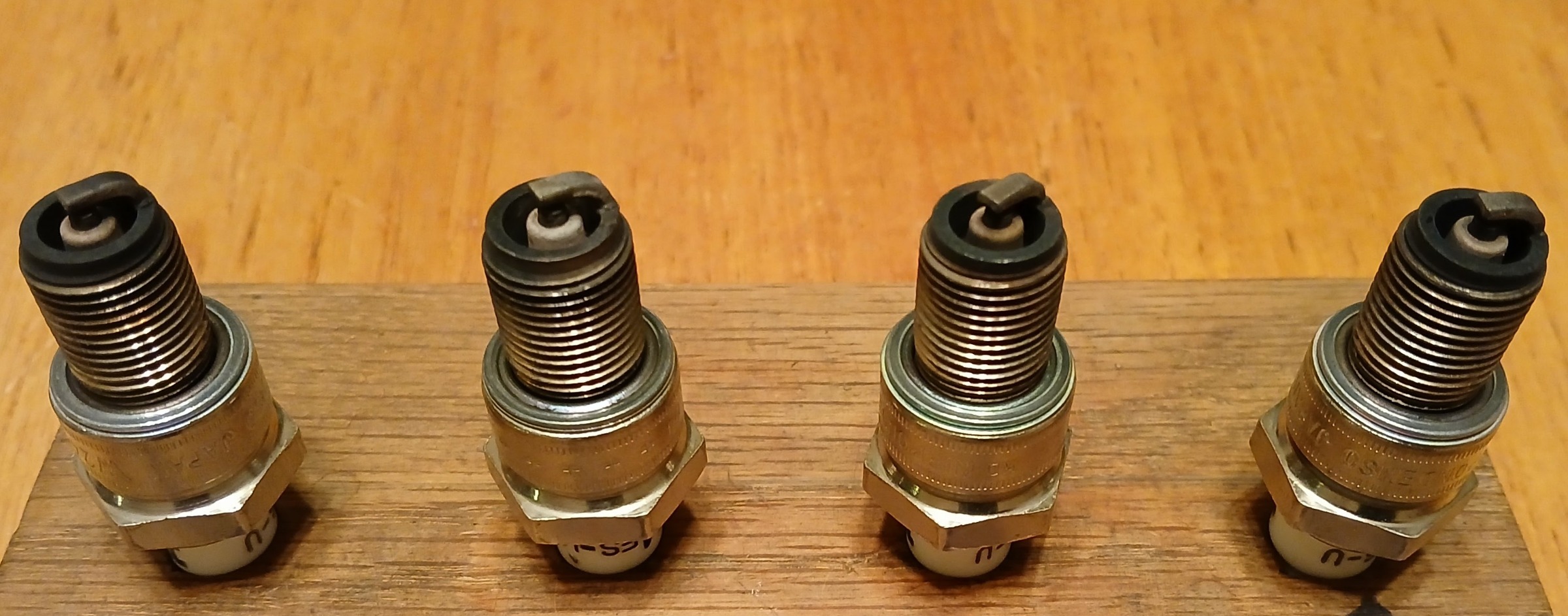

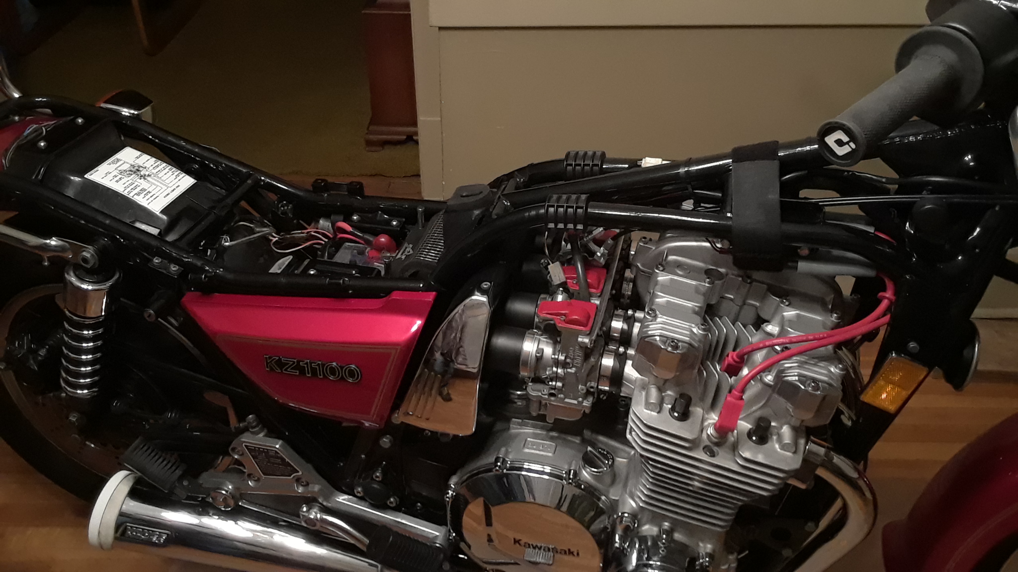

Just could not let our recent Spring-like West Michigan weather pass by without getting out for a couple short rides.
It was a great opportunity to focus on tuning the carbs, and to finally give my Gunson Color Tune a go.
70 miles on fresh top-end.

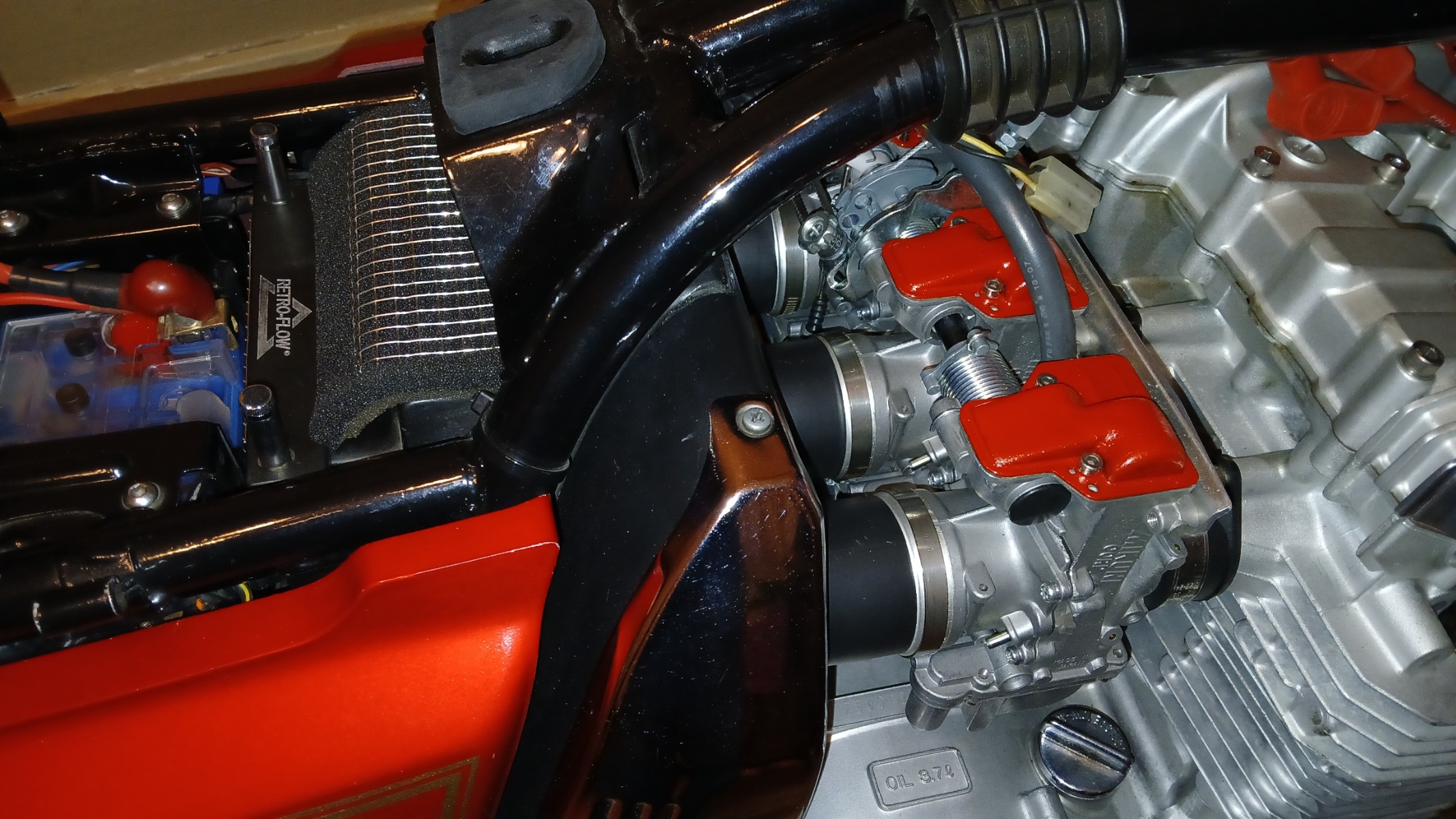

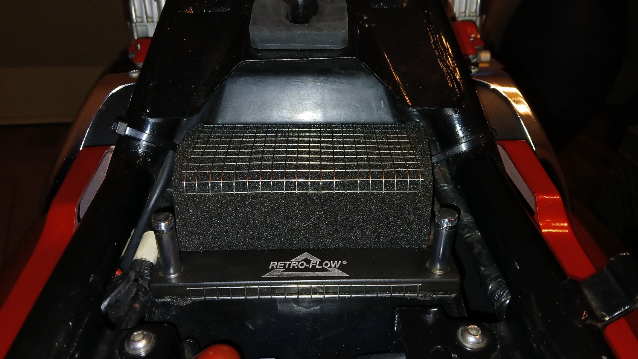

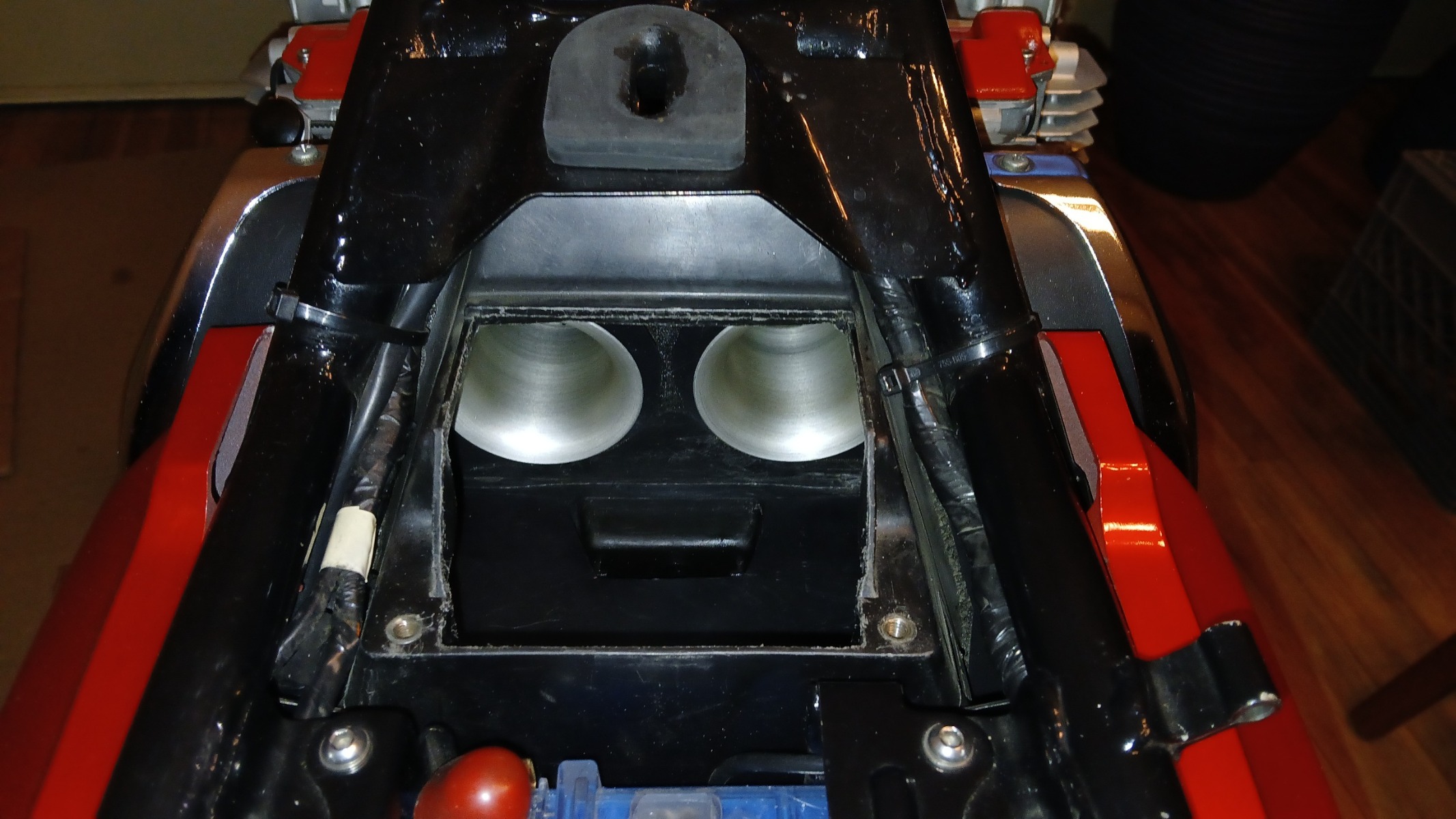

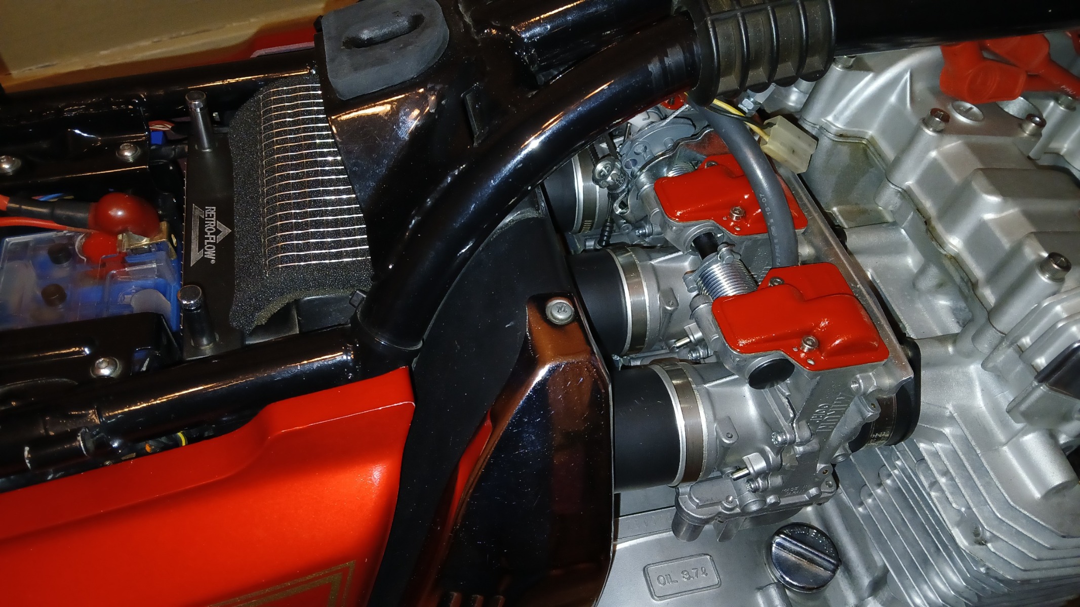

Still loving the air box/velocity stack setup.  Ten years on!
Can see it's time for a fresh cam cover gasket

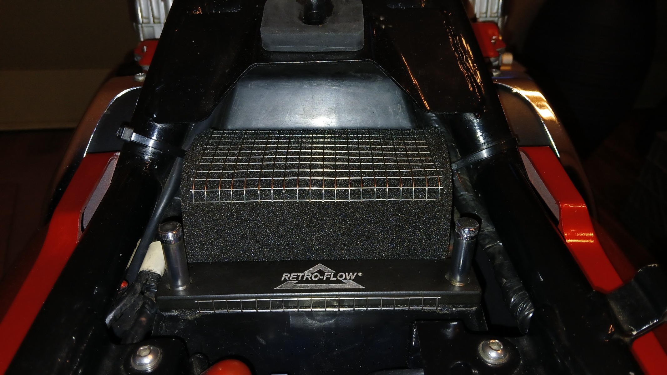

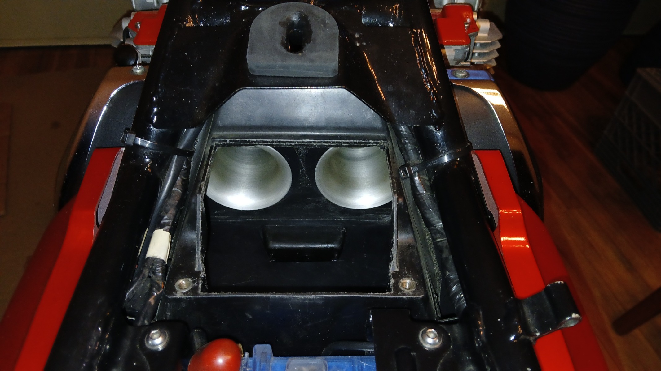

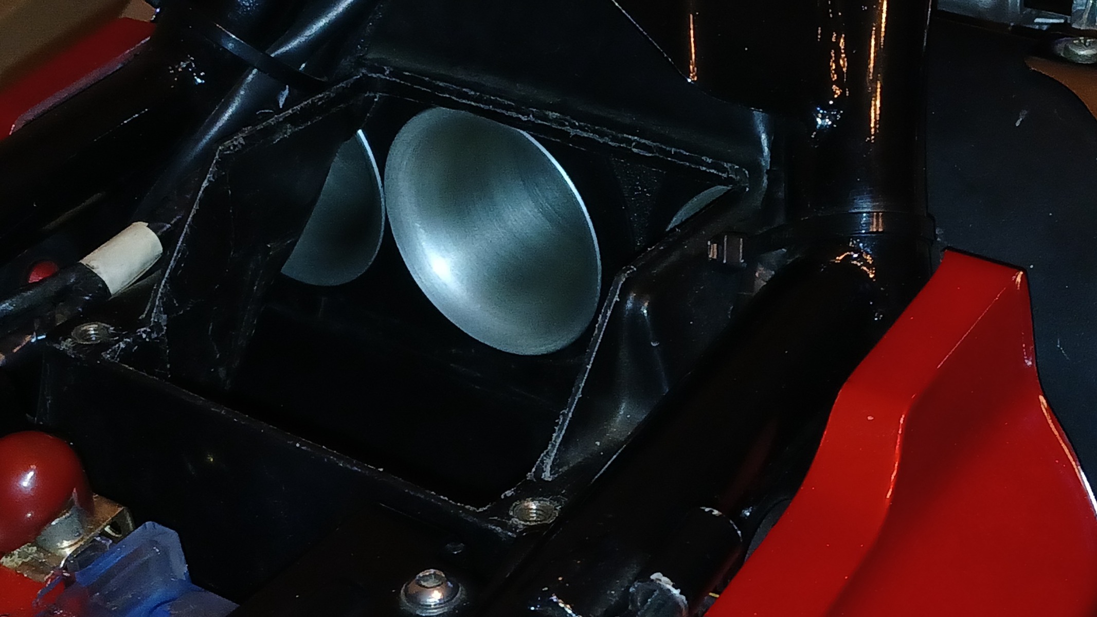

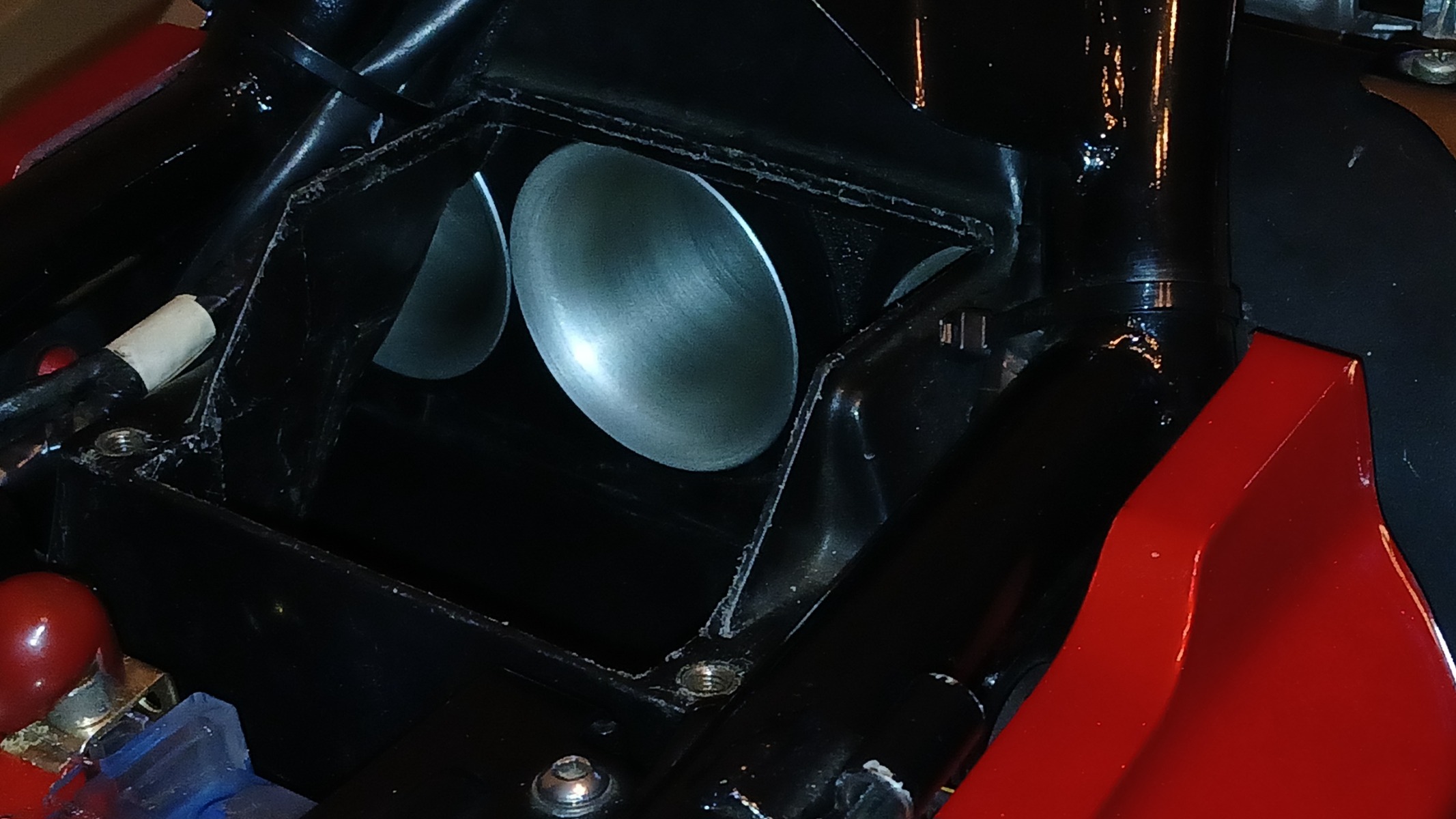

How long are your stacks?
  • daveo
  • daveo's Avatar Topic Author
  • Premium Member
  • Premium Member
  • Posts: 3161
  • Thanks: 895
Re: Fresh Start Pilot Jet Size
17 Mar 2026 20:49 - 17 Mar 2026 22:20
#922309
The Mikuni KRS-004 stacks are 3.14" or 80mm overall, which is similar to the Kaw. KZ1100A rubber air boot length, btw.
These stacks are easily removed (in pairs with filter attached) through the air box intake opening, as there is insufficient clearance on the engine side.
