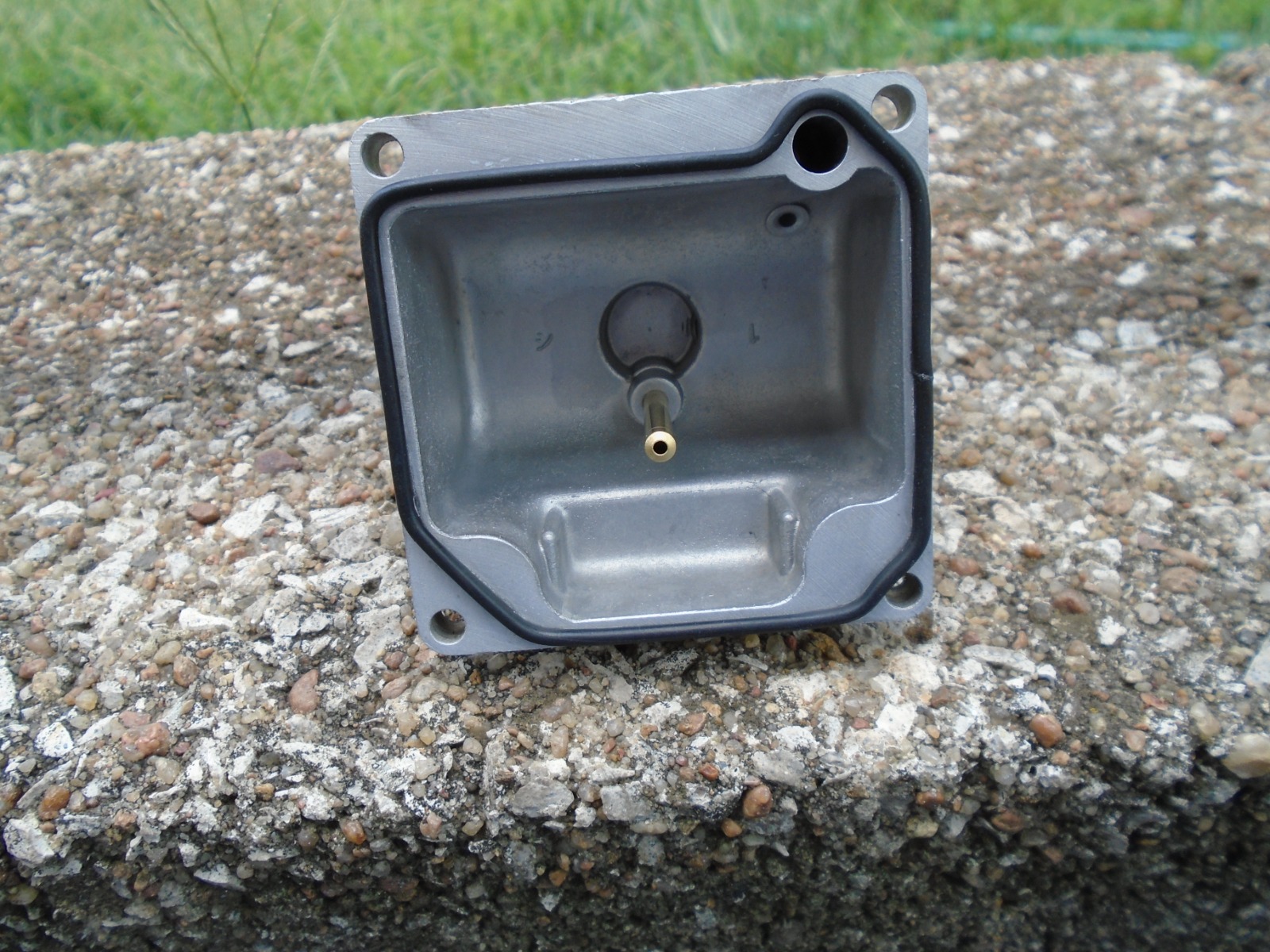

04 Feb 2026 08:54 - 04 Feb 2026 09:00 #921219 by Injected
Replied by Injected on topic 1200cc engine, VM29 carbs, Pods, what jetting?
FYI : The labyrinth O ring gaskets on RS/TM/CVK are 2mm OD, the groove they sit in is about 1.6mm deep X 2.2mm wide. Shown is a float bowl from a 1985 Canadian version GSXR750R which were early TM series 29mm flat slides.
The only downside of the rubber gaskets is when the are wet with gas they swell and will not go into the groove unless you heat the rubber to remove the gasoline. A few minutes with a heat gun usually shrinks them down enough to go back into the groove. Its a pain to do but if you don't the gasket will pinch somewhere and you will have a substantial fuel leak.
