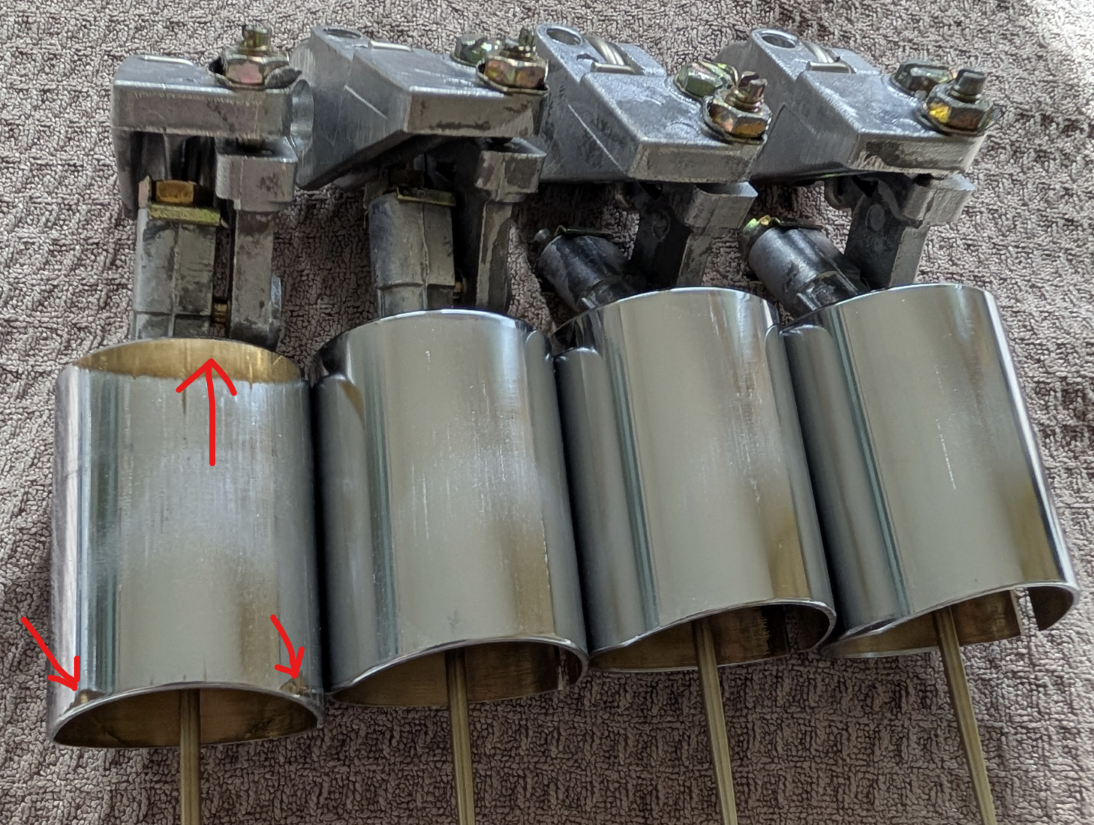

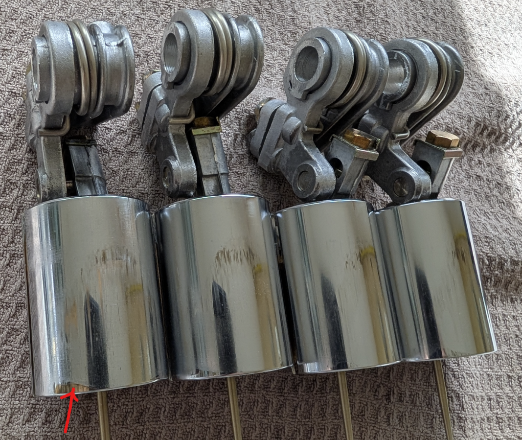

28 Jan 2026 11:09 - 28 Jan 2026 11:13 #921018 by Nessism
Damage on one slide.  Send it?  Or replace?
EDIT: the photos make the other 3 slides look worse than they are.  All 4 have scuffs on that one side, but only one has wear through the chrome.
Last edit: 28 Jan 2026 11:13 by Nessism.

01 Feb 2026 07:46 - 01 Feb 2026 08:23 #921100 by Nessism
The new 1.5 slides came in.  When swapping them over, I noticed that the worn slide was secured with one screw that was allen head.  Not the stock screw.  Can't say this caused the problem, but it's suspicious. Maybe one of the original screws came loose, allowing the slide to flop around?
