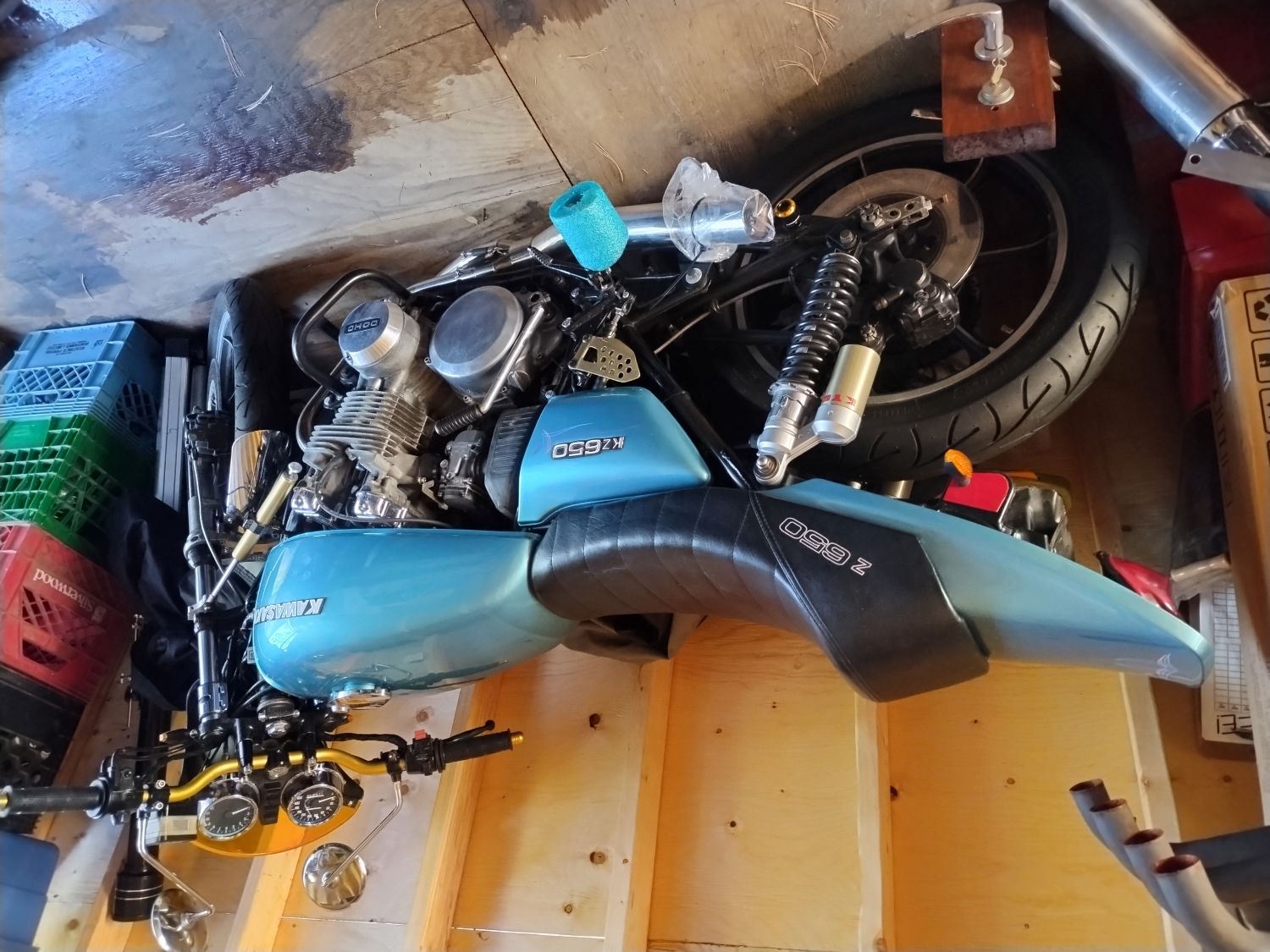

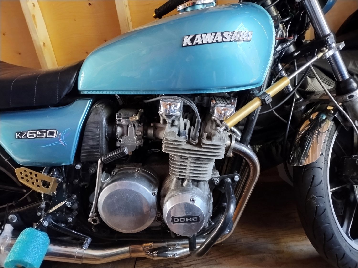

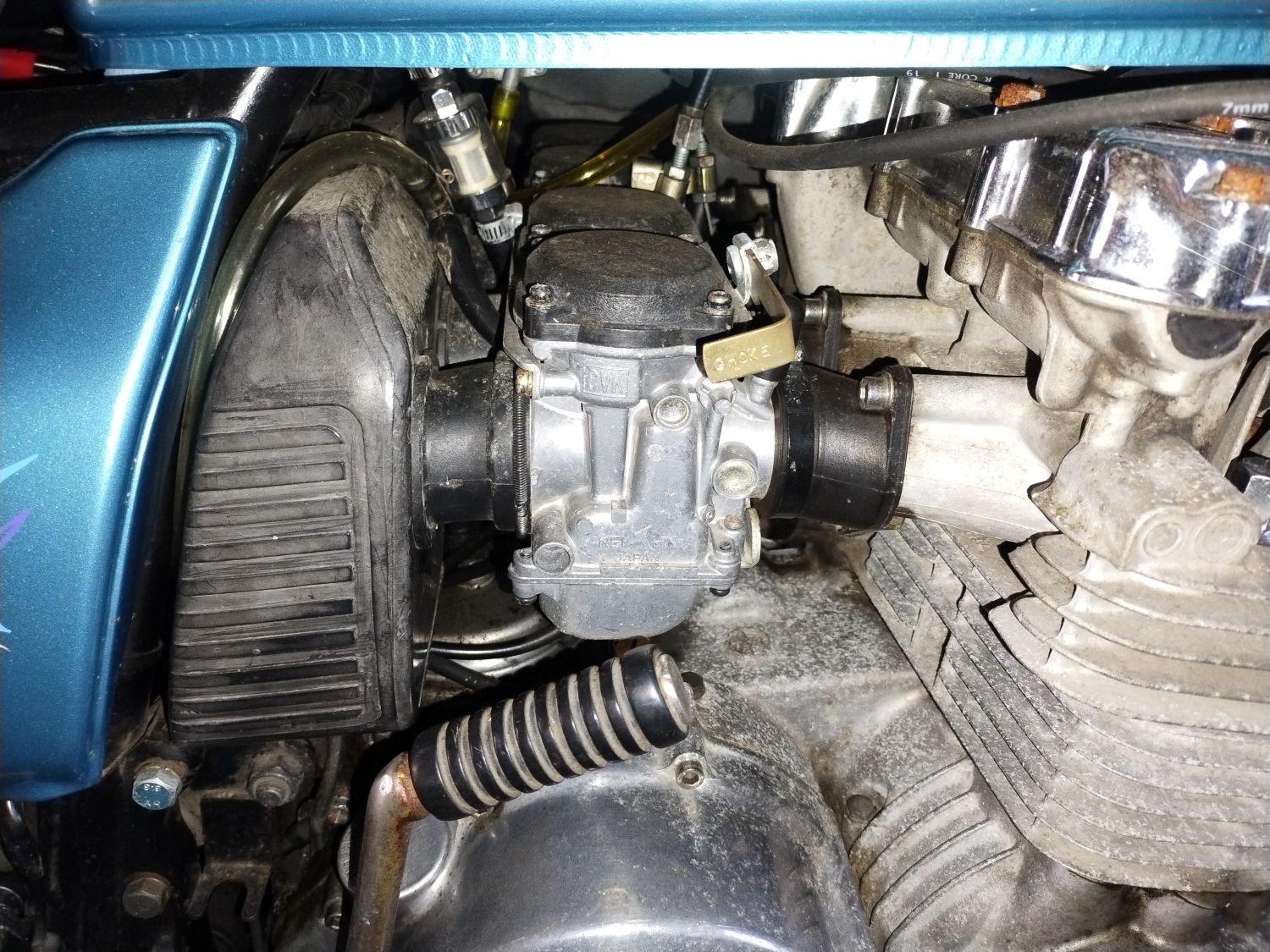

She rides very well with the CVKs.
Carb holders (ZR-7S) need to be put on, and air box boots, holes enlarged in the airbox, so not so easy to swap back and forth.
Mine with CVKs:
Mine with CVKs:

That's very cool, reassuring infact. Thanks for the pics. I should see a few parts showing up in the mail this week. Carbs will get an Ultrasonic cleaning first. Can I ask you your jetting. Is it around 45/115 ? PABLO started with 45/112 but then he moved to a 4into1 so I don't know if he changed the Main again. THANKS again
