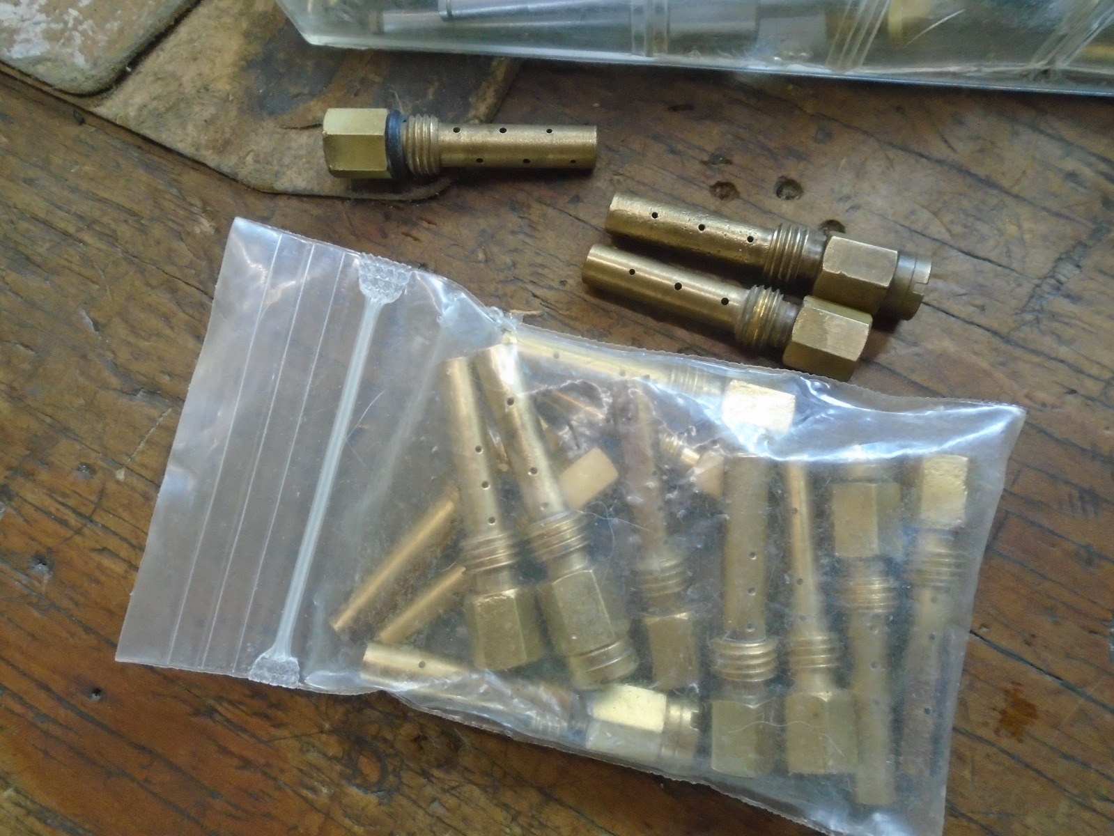

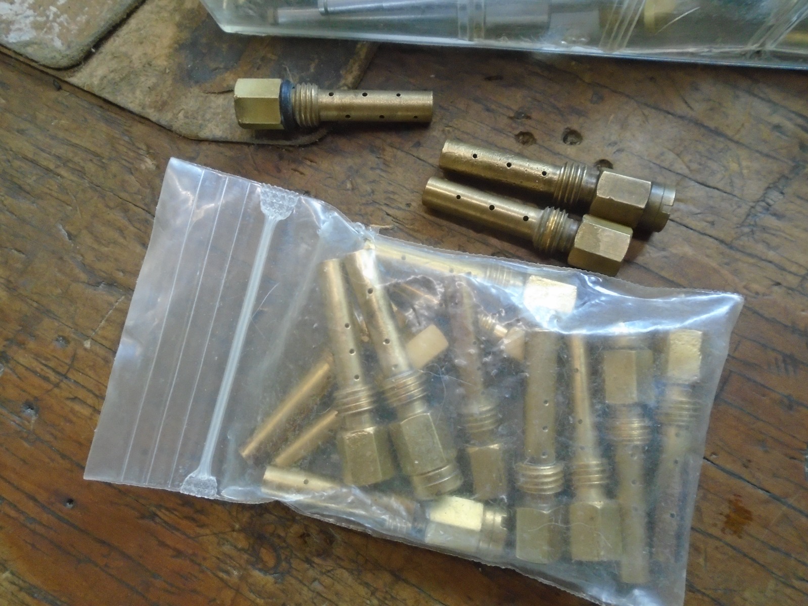

If possible can someone post a photo of the main jet holder?

Here's a photo, hope it helps Gd. While they all look similar, they have different air bleed hole count/location depending on application. What are You fishing for?

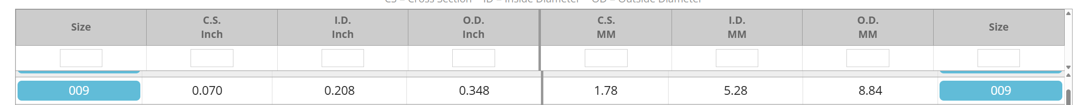

30 Aug 2025 23:10I use -009.
Thank you, Ed, for the explicid info in inch and metric sizes !!!

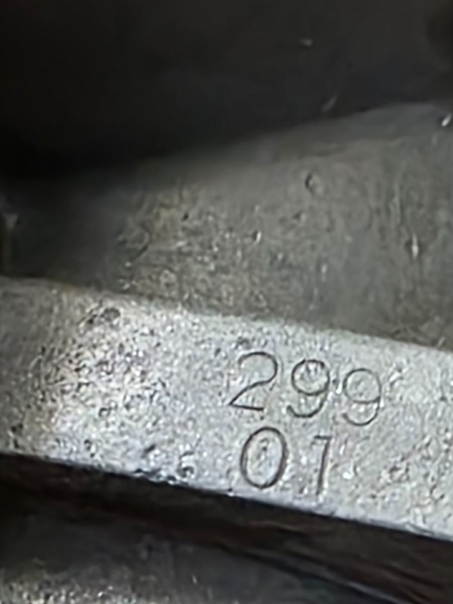

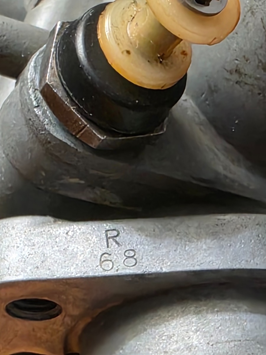

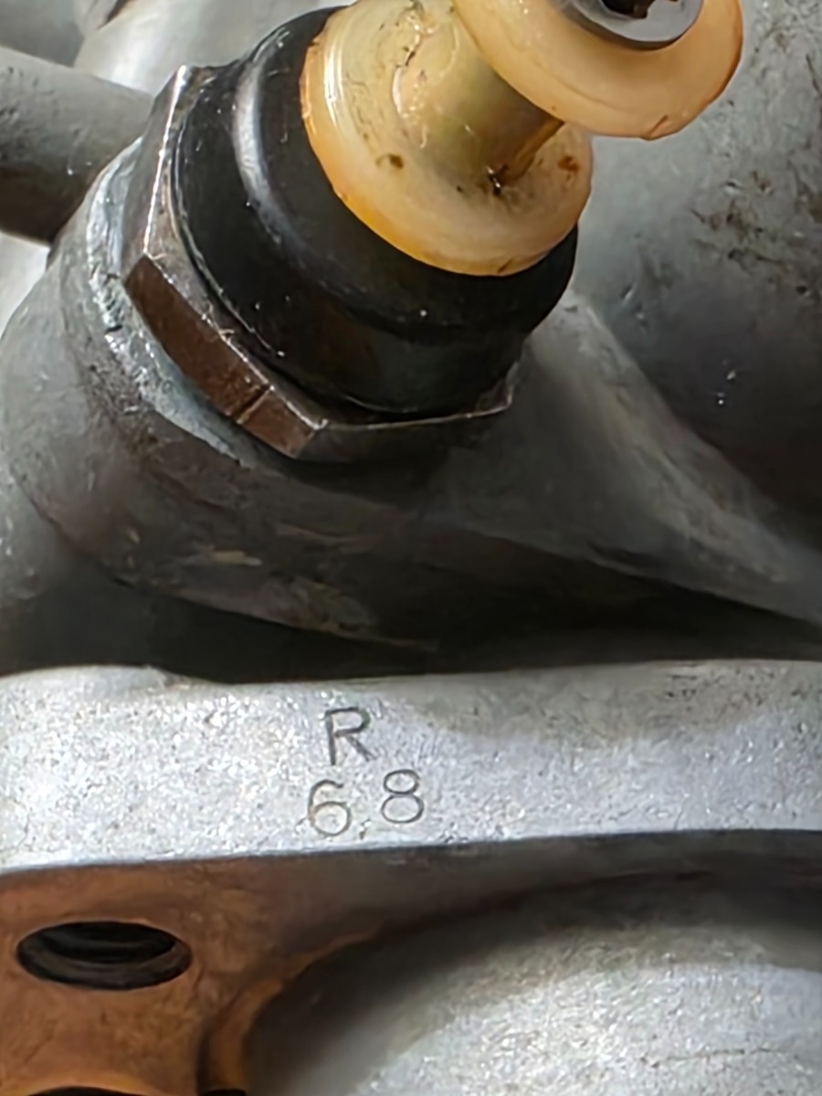

GD are you sure you have the Kawasaki VM's. Those main and pilot sizes are what the Suzuki GS1000 8-valve used, not Kawasaki. Do you have Air and Fuel adjusters? Can't remember but think they also used/shared the same 5CN8 jet needle. Jetting, what exhaust and airbox/individual filters will dictate. Verify they are truly the VM26 Kawasaki version please, check numbers on flange and share please! And i wouldn't recommend changing out those fuel adjust screws unless damaged or pitted.

R6.8 is in front of choke plunger and 299 01 is stamped on the opposite side

I have some info that the 299/01 ID were used stock on the 77 1000 A models. Your current main and pilot jet sizes are smaller than info I have for stock settings. Info I can find is as follows
main jet 107.5
pilot jet 17.5
jet needle 5CN8 set to 3rd slot from top
needle jet O-6 (thats an oh not a zero)
slide cutaway 1.5
pilot screw (fuel) 1 1/4 + or- 1/4
main jet 107.5
pilot jet 17.5
slide cutaway 1.5
