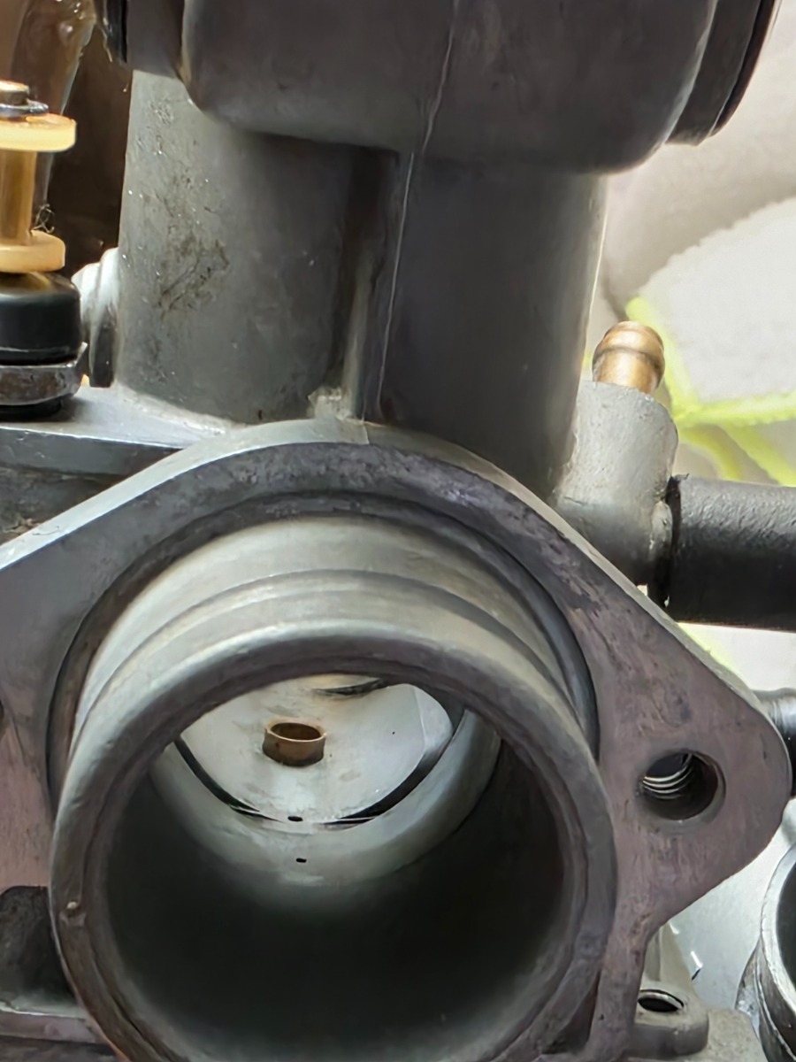

From what I can see the needle jet is somehow pressed into the main carb body , but it seems this might be a wear item in which you might need to remove and replace. I am afraid I am getting into a area that is beyond my knowledge.

You should be able to press them out from above. When I am rebuilding / cleaning a set of carbs I tend to pull them all apart and then decide upon which parts need to to be replaced and which just need a cleaning. It is then at that point that I will order what I think is needed. I do agree that some of the brass items can and do wear, but for the most part I have been able to reuse the parts as long as I keep all parts for each carb to themselves and not mix between them. In Mikuni talk they are a series 258 needle jet which in the past were offered in different sizes to work with different jet needles.

Use a round punch that fits INSIDE the jet. Don't press on the thin edge, or you will bend it.

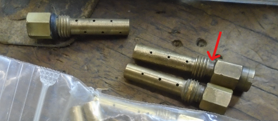

Borrowing Clay's photo...
Some jet holders use O-rings, and others don't. Look for the space here. If the threads go all the way up to the hex, no O-ring is needed.
