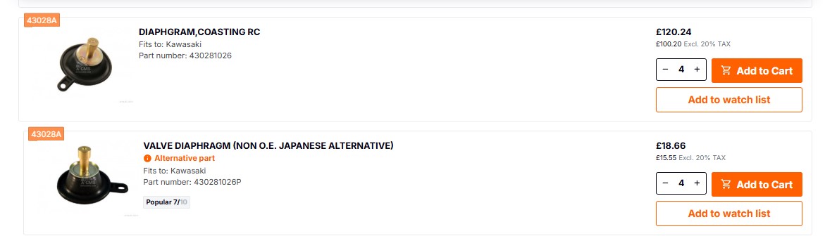

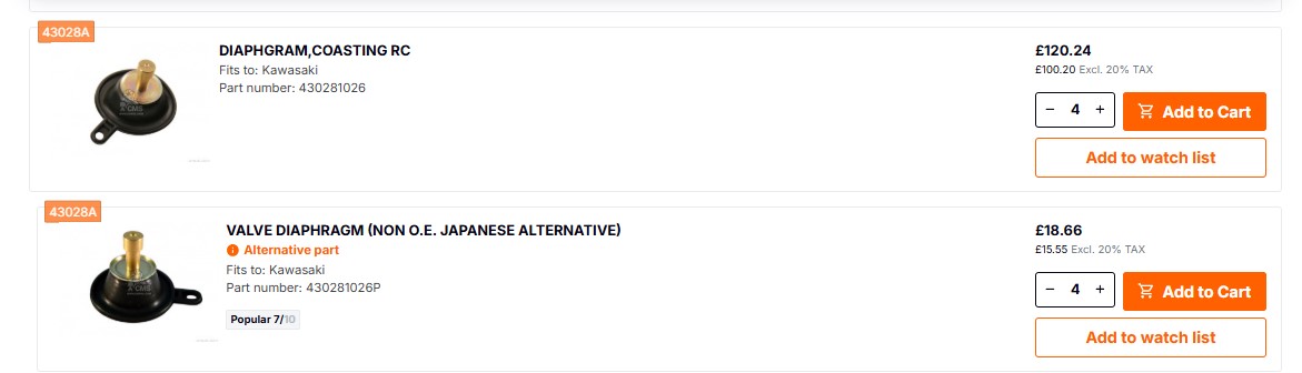

Also might want to check all those Air cut diaphragms underneath the 3-screw covers. They can get pin-holed or mushy. Unfortunately they are super hard to find. Believe someone is remaking them though?

26 Aug 2025 06:22 - 26 Aug 2025 06:29It seems a bit "hit and miss" which years and markets had the enrichment valves - however as this guy is in Europe CMNSL have OEM and aftermarket if needed (check out that price difference !!!!) - I suspect the OEM version is cut from Unicorn's foreskins !!!!!Also might want to check all those Air cut diaphragms underneath the 3-screw covers. They can get pin-holed or mushy. Unfortunately they are super hard to find. Believe someone is remaking them though?
