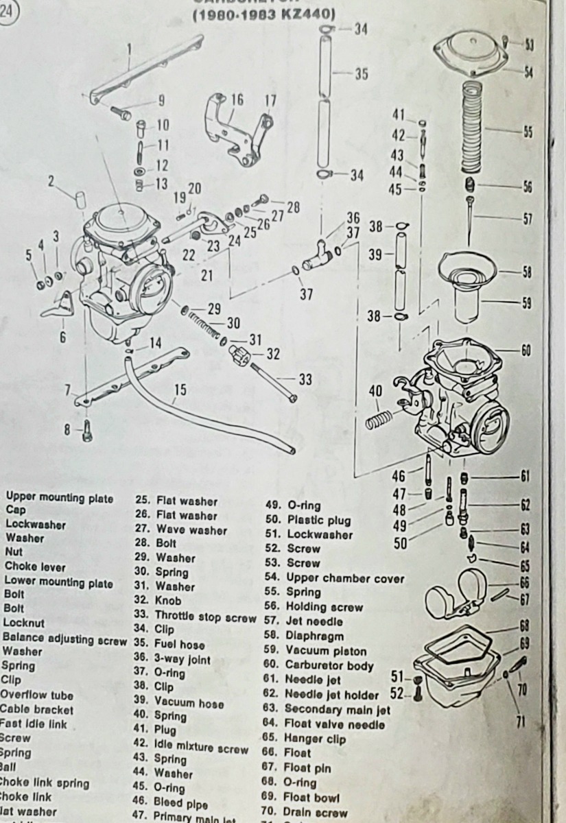

In the "Filebase" here on KZR, you will find the factory 440 service manual for your bike, available for free download. Inside the manual, you will learn that the 440 came with Keihin CV36 carburetors.
These carbs are very similar to the CV34's that were used on many different model 750 bikes. All the O-rings are the same (I have a kit).
Please do NOT attempt to rebuild these carbs by buying some cheap junk china "carb kits". The proper play is to take the carbs apart, clean everything, reuse all the brass jets, and replace the O-rings. It's cheaper that way also.

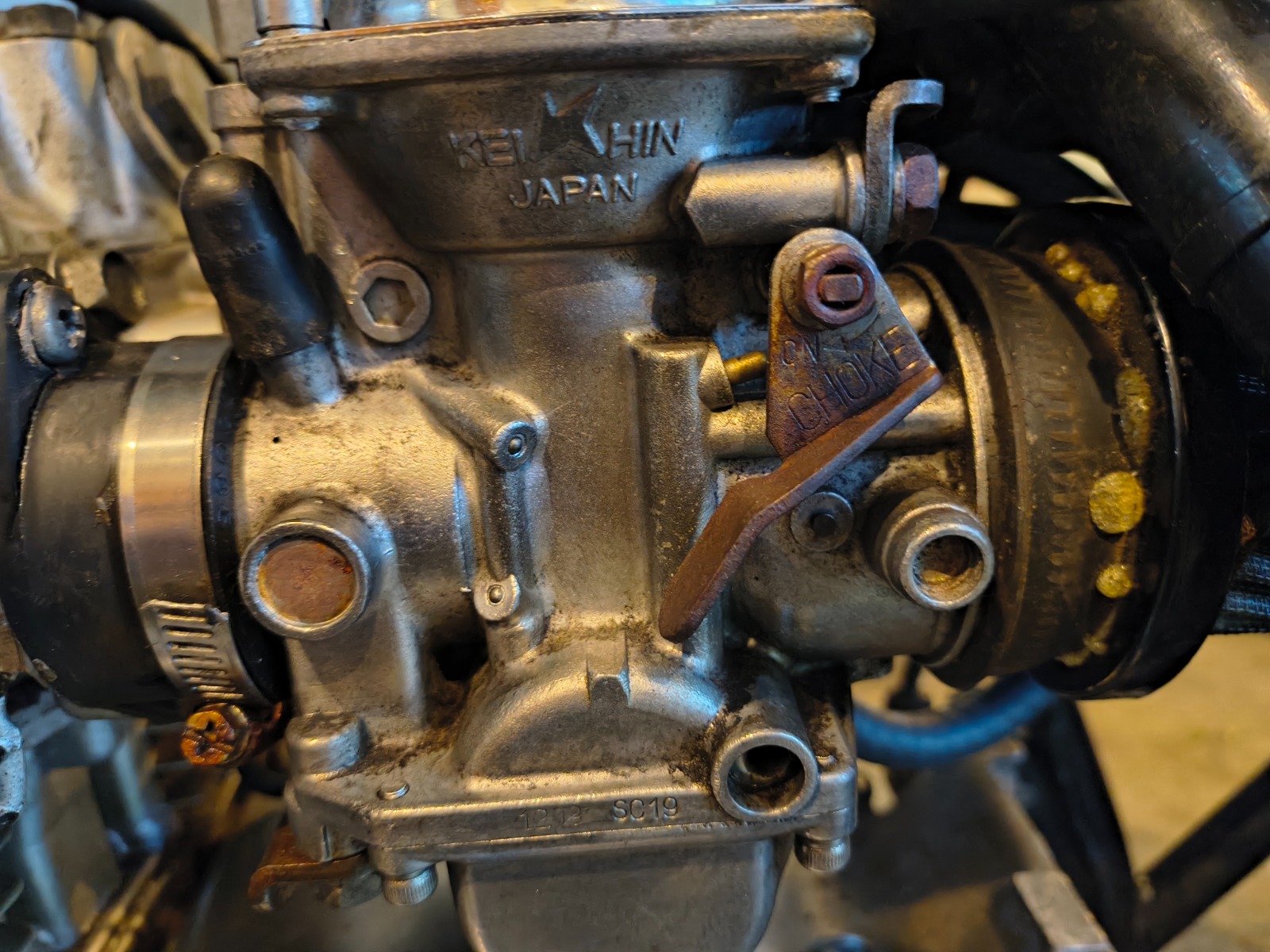

Thank you, I want to use OEM parts only just confused on what carbs I have. Also this bike has been modified to pods runs rough when ideling but mid range and high range is good. Carbs are not marked like the manual states .

You need the following O-rings...
#71 (qty 2)
#37 (qty 2)
#45 (qty 2)
#68 (qty 2)
#49 (qty 2)
During the rebuild, be sure to remove #48 pilot jets and #46 bleed pipes, and use a small wire through them to make sure the tiny holes are open.

The Kawasaki manual says the carbs are marked as what model number they are like cv34 or cv36 I just don't see that on either of my carbs.

15 Aug 2025 04:33This is true of nearly all the carbs of that era, even the ones installed at the factory. The model and size will not be stamped on them. The only way to know for sure is to educate yourself on the sometimes very subtle differences, or depend on guidance from somebody who has already done that.The Kawasaki manual says the carbs are marked as what model number they are like cv34 or cv36 I just don't see that on either of my carbs.
