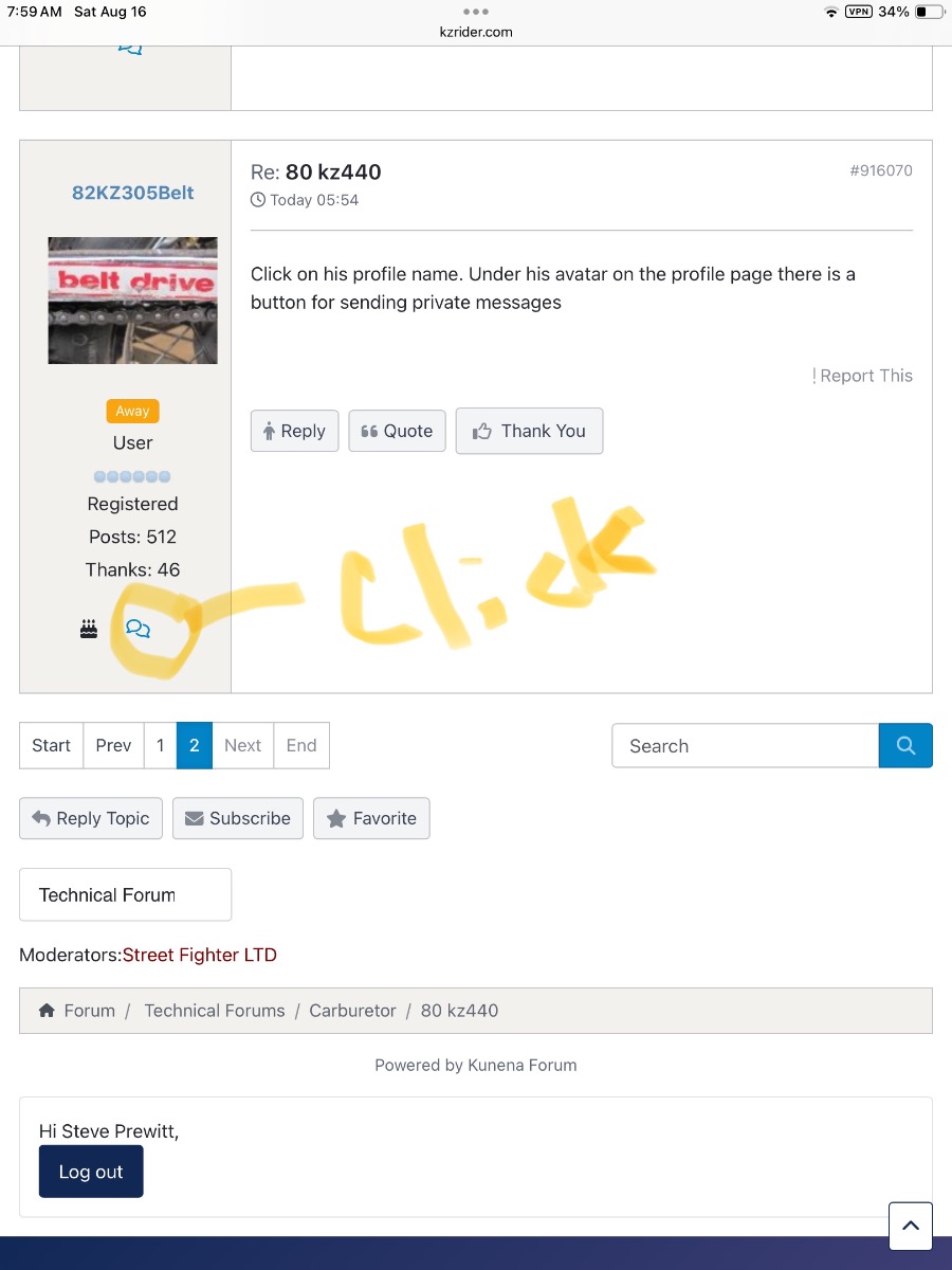

Click on his profile name. Under his avatar on the profile page there is a button for sending private messages

Or you can click  the text balloons on any post he has made.
