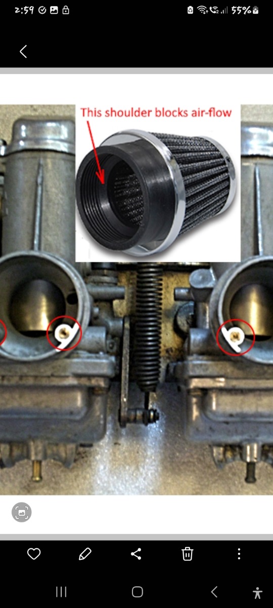

Assuming you have quality pods and not shite ebay cheap crap with a lip on the inside that covers the pilot intake and you have decent voltage to the coils and decent compression it'll run fine on the above settings.

The pods look like cheap eBay junk to me. They do have a lip on the inside.

Cut the lip out. Or fit some proper k&n's that actually work.

Because you are using k&n's there is a bogging at around 3k rpm.
Air corrector jets resolve that bogging.
They need to be fitted in the intake port on the opposite side to the airscrews. One in each carb.
Circled in red here.
The only other thing that could cause the issues you are experiencing is if the ignition auto advance is not operating correctly. Can you see the ignition advance using a strobe.?
