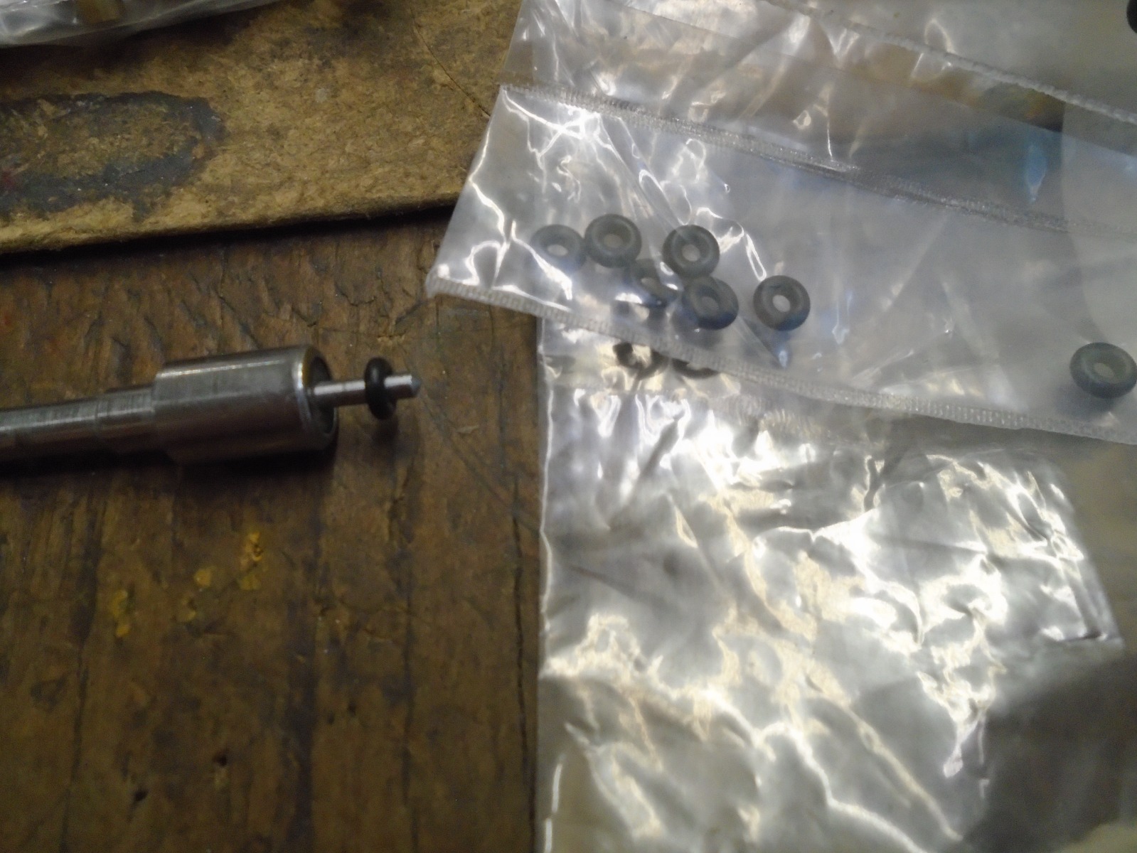

I know ZED1015 is "mentally" going to spank my lily white bottom for this but i oring the protrusion of the choke plunger and have been doing it for over a decade. Never had any problems, or complaints. If nothing else it immediately curbs a misbehaving plunger to take it out of the quotient. Goofy i know but costs about 2dollars to complete. Oring is a 1.5mmID x 4.5mmOD and 1.5mm Cross Section/thickness. I superglue them to the existing pad after i clean the gunk off. This will raise the assembled height about a MM but not any issue. Are Your 28SS's Pumper or Plain?

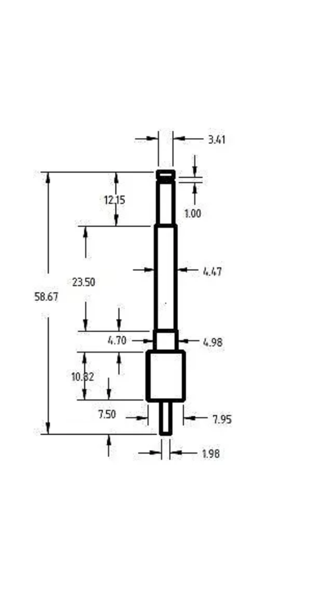

I have 28ss kz1000A carbs !!! I ordered from ebay 4 plunger for vm24-26-28 carbs

  These one
