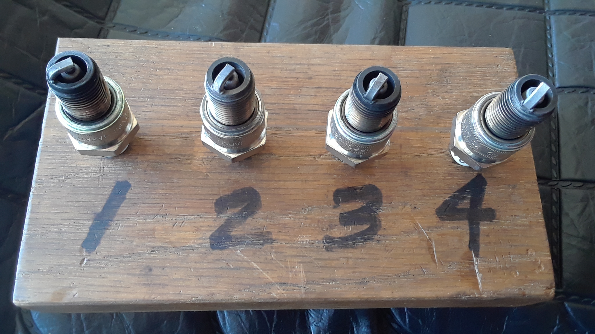

15 Apr 2025 11:55 - 15 Apr 2025 14:12I've had a persistent issue with cylinder #4 running lean.
Didn't matter what spark plug or plug wire I installed, or what jetting adjustments were attempted on the carburetor.

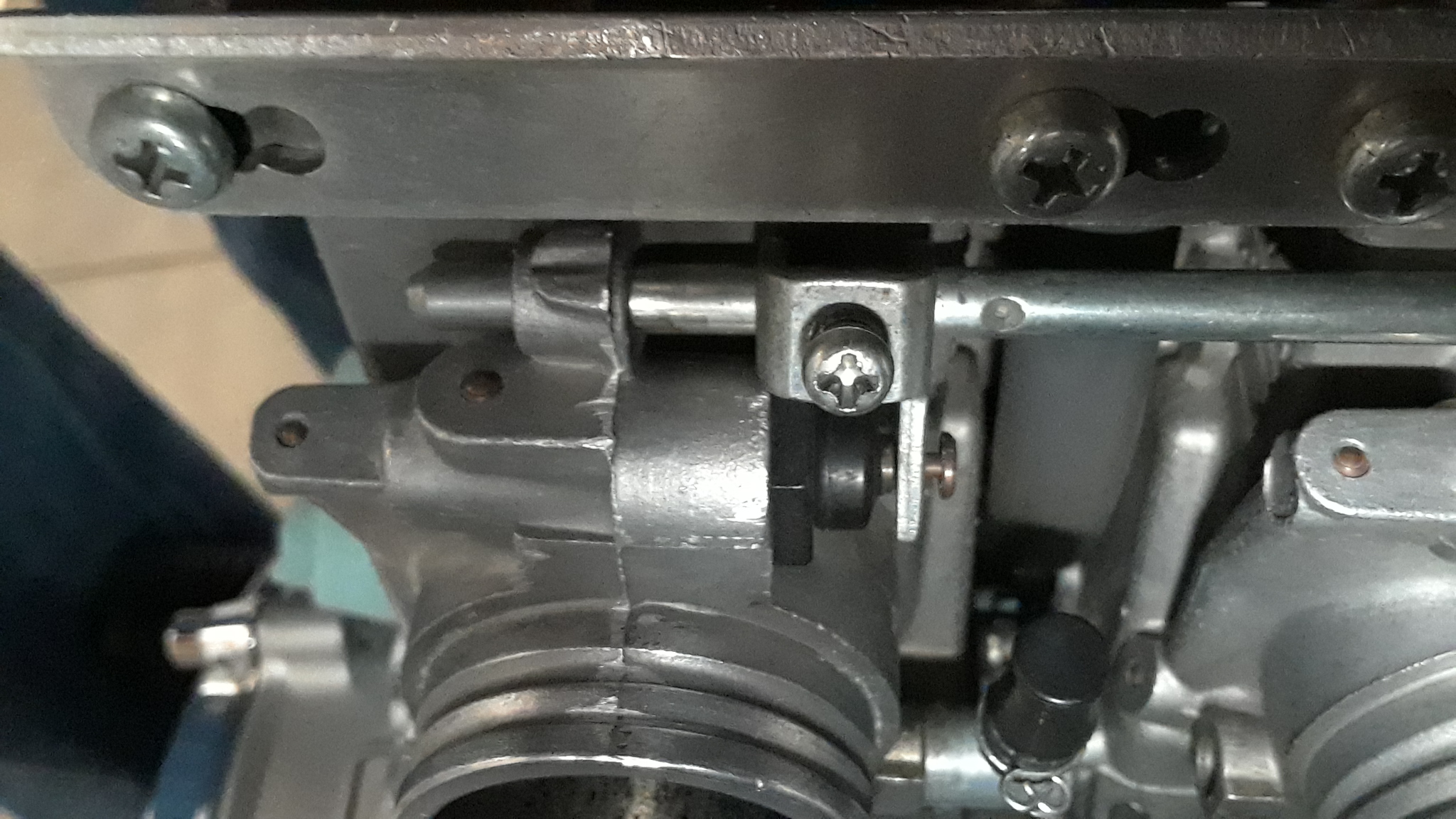

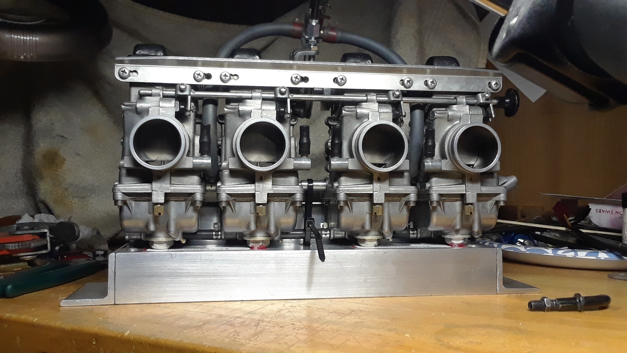

While viewing the image below...
I noticed something about the choke rod.
The #4 finger bracket kept that choke plunger closed, but it's misadjustment allowed for the others to open...slightly.
The finger brackets have been carefully reset to apply equal pressure.
After a short ride it looks like I just may have caught the goose!
