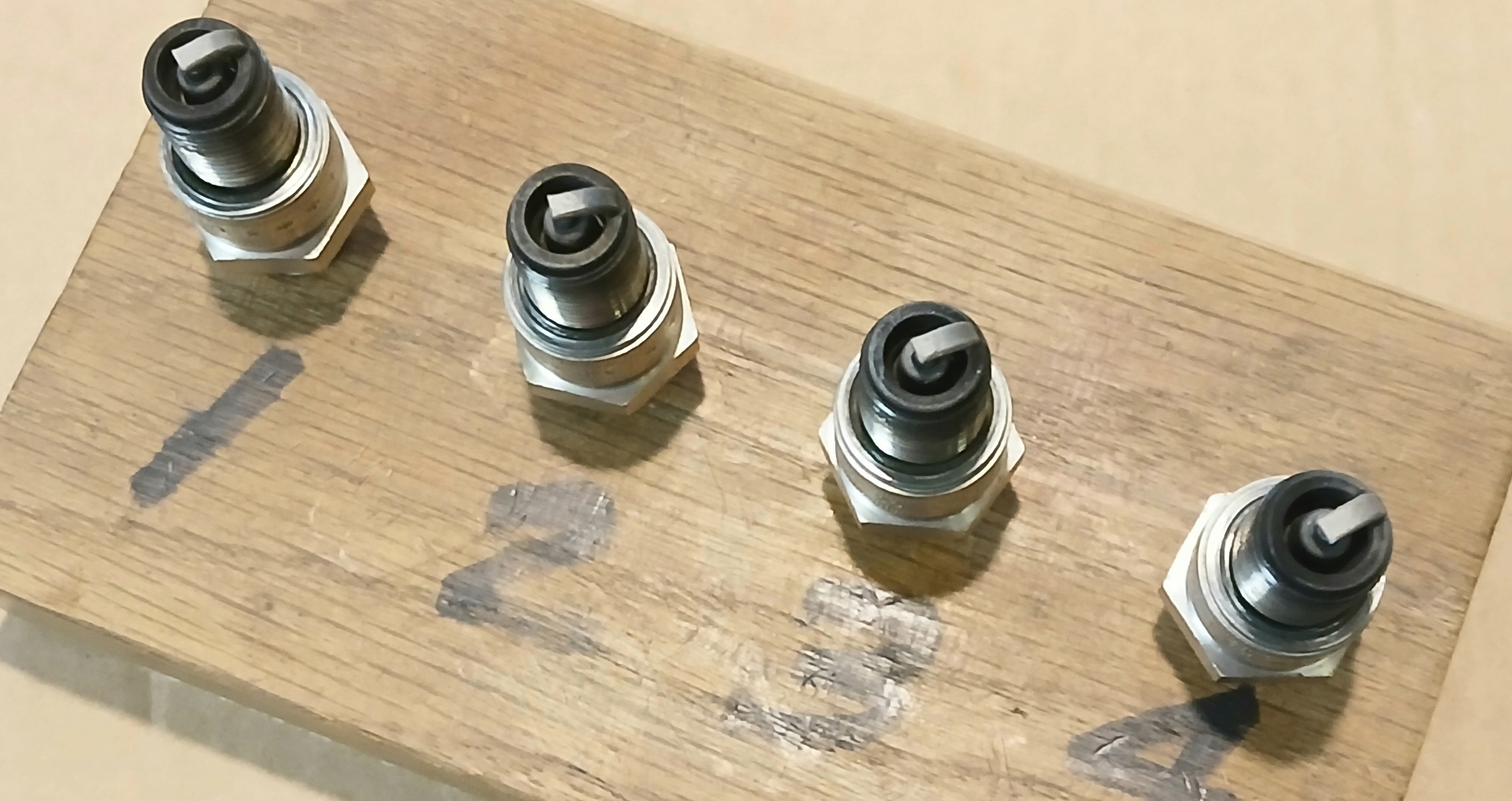

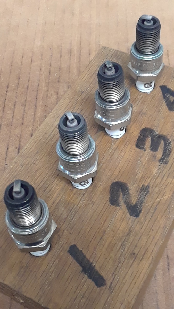

I changed pilot jets from 15 to 17.5 and the main jets from 122.5 to 125 in my RS34 carbs.
These subtle changes really smoothed out the idle and boosted engine performance!
It produced an even color to the spark plugs, but also richened them up a bit much, I think.
Relative spark plug condition with .8 air jets installed and fuel screws about 1/8 turn out:
Like to lighten them up a bit and improve the color.
I'll try the .9 air jets again, and lower the jet needles if that doesn't work.
Almost good enough...for the time being.
