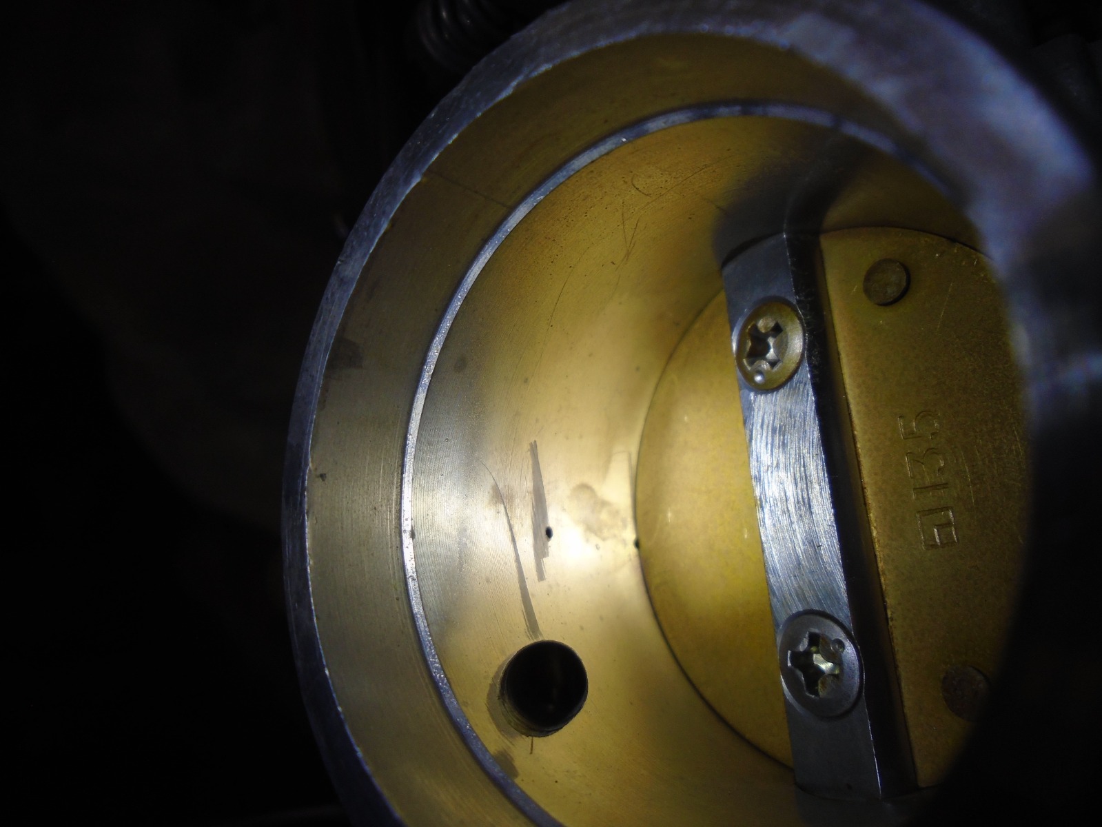

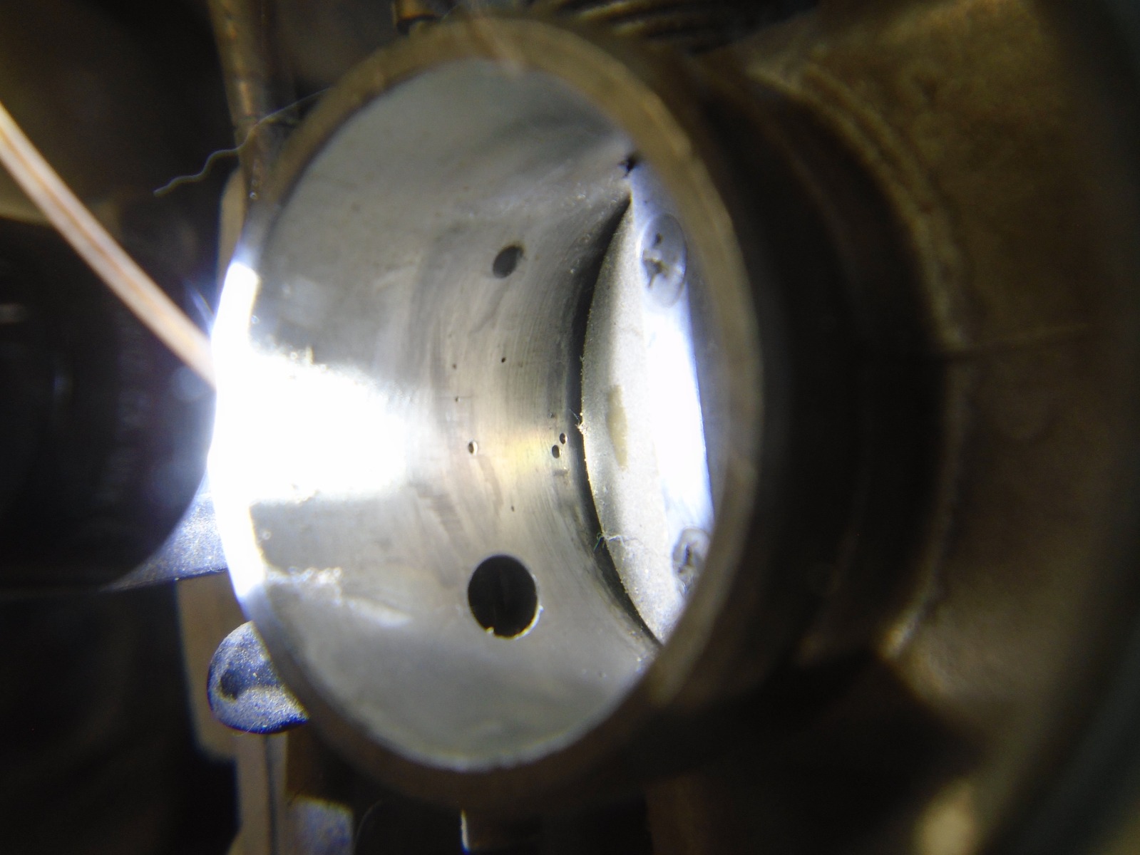

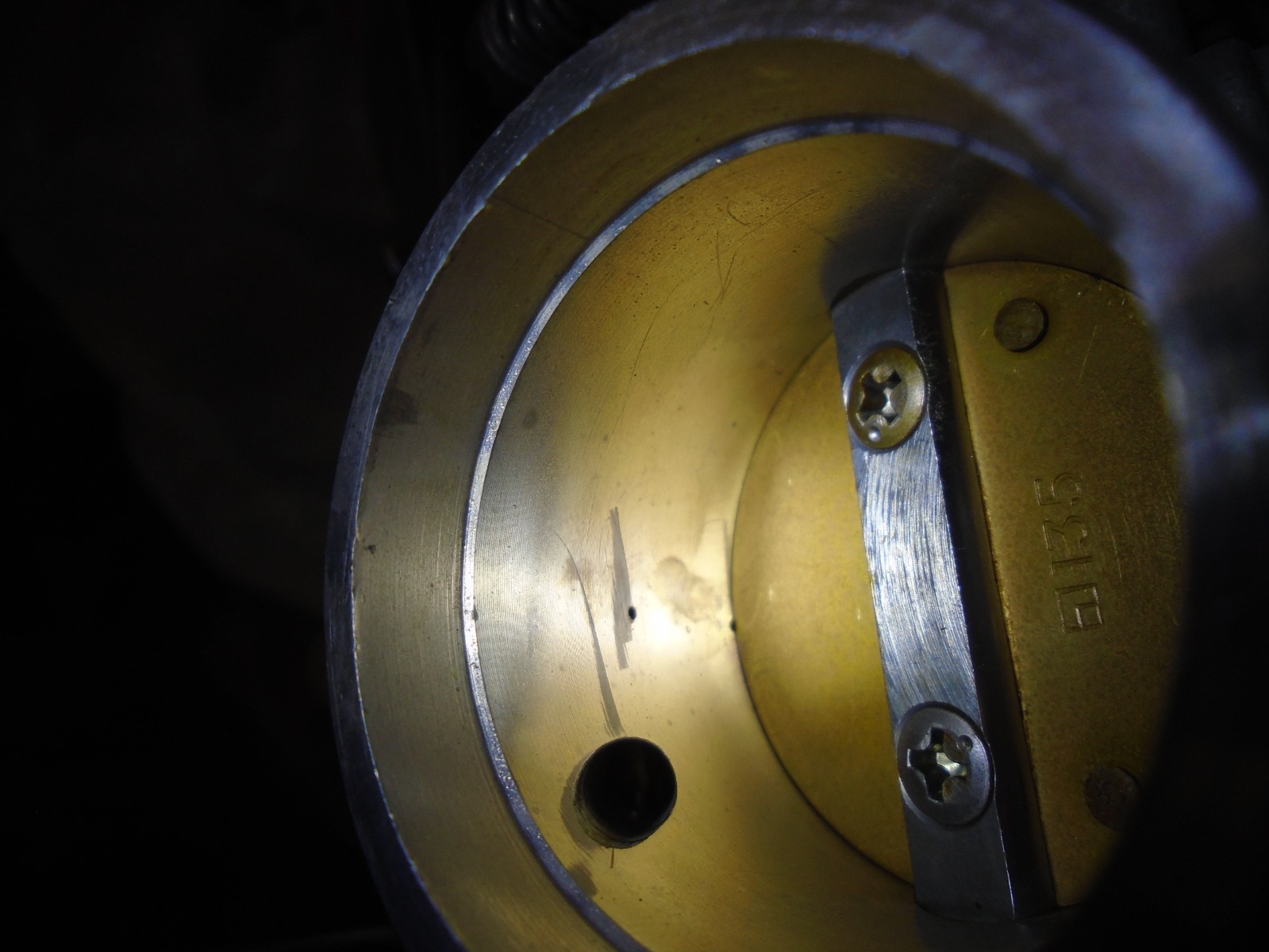

To get a thorough understanding of operation, pull the bank back off. Flip assy over so you can visually witness intent and operation of what those screws/springs are accomplishing. As everyone mentioned the "master" carb is the one with the idle thumbwheel, every other individual carb is based on this one. Be mindful that too tight of adjustment on others, where throttle plate is "overly" closed, will push that initial idle master plate out of whack. So..turn all the 3 screws out/in till plates are open, somewhat exposing the "pilot bypass" holes in venturi. Bypass holes are the small holes drilled right behind the main hole where fuel needle tip pokes thru into venturi. Set "master" carb plate visually. Use the hole that the pilot fuel adjust would poke thru as your guide. You want the throttle plate intake side leading-edge to expose approximately HALF of that hole. Duplicate same "exposure/opening" for each carb. Use a handheld magnifying glass if needed!! You will find if this initial step is done correctly Your sync will be almost perfect and only fractional adjustment required. And not mentioned but vital!! If using a cheap set of mechanical vacuum gauges, don't really trust those, use YOUR EAR!

29 Mar 2025 04:02
Like this, note leading edge of plate sitting loose above that first hole behind pilot adjust opening hole.
