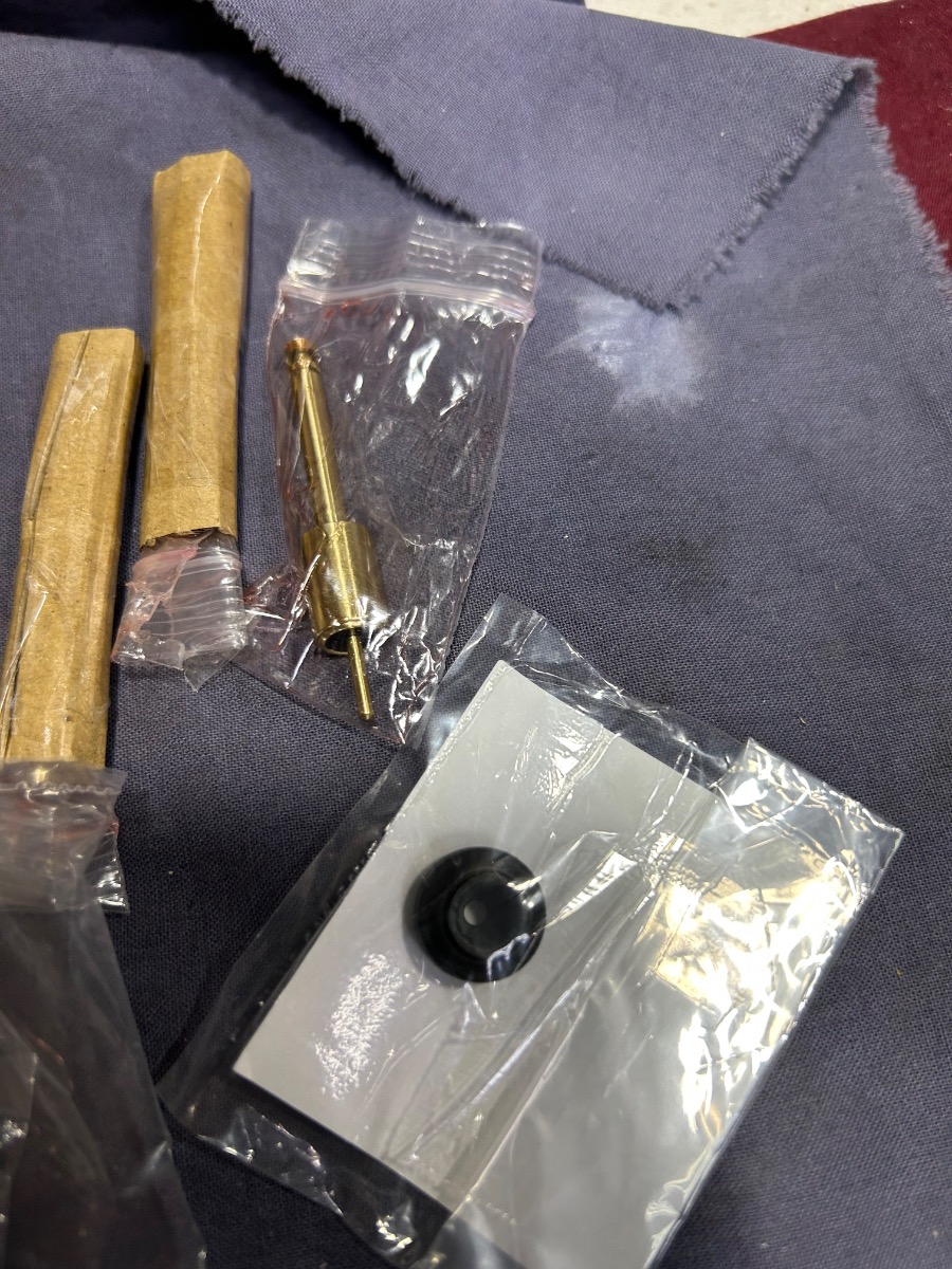

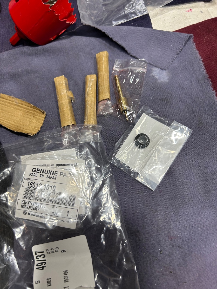

Got the plungers back from @zed1015. Thank you!!
they look amazing. Got the little rubbers too, so it’s carbs weekend ahead.
will surely need help, so I’ll keep you posted.

Solved! I guess the repaired plungers ended solving the entire situation.
engine starts, runs and behaves like a champ.
no idle holding, no overrun, no hesitation and I got (for a moment, as im breaking it in) over 7000 rpm, so that problem is solved too.
thank you so much for your help.
