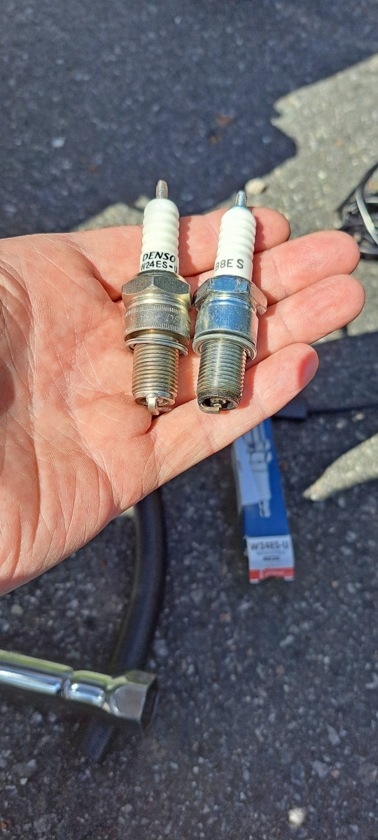

Additional question: these spark plugs are brand new. Can they be cleaned and reused?
This will clean off all contaminants etc and simulates the conditions the plug experiences in the cylinder under normal running conditions.

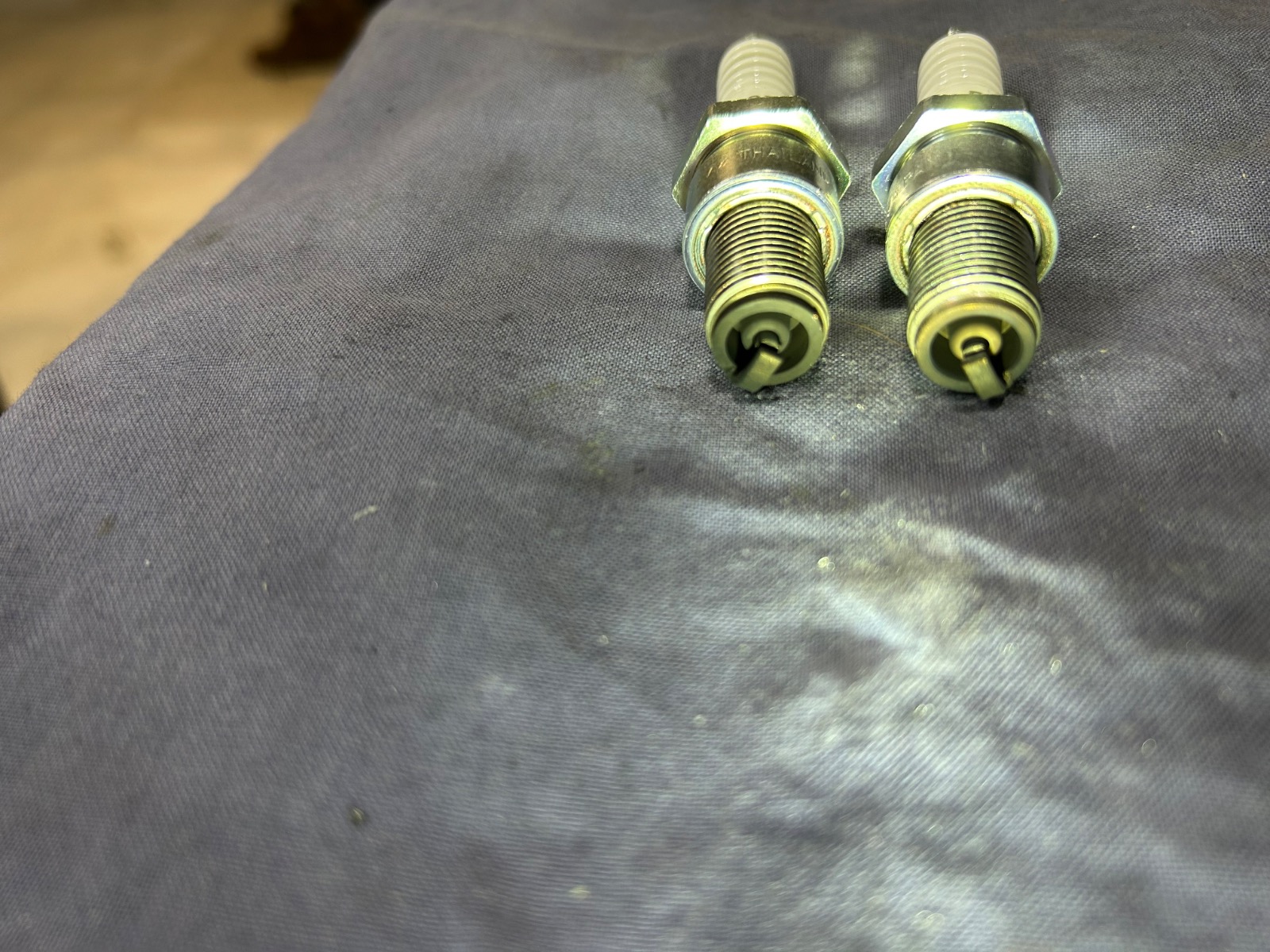

Reporting back with new main and pilot jets. So with the new 122,5 (main) and 37,5 (pilot jet), I think I have gone 180 degrees in the lean way. Now:
- Difficult to start
- Does not accelerate cleanly from idle, but bogs a bit and then catches up
- Absolutely clean plugs (no soot, nothing)
- Idle is a bit erratic
- Gets completely hang around 3000 rpm
- When running, gets explosions on retentions, some explosions when starting as well
I have tried to adjust pilot screws to enrichen it, going to 3 turns open, and it runs a bit better, but still same simptoms.
Question: Would the pilot jet have such a huge impact? I'm thinking that the larger pilot jet would help with the idle acceleration bog, and enrich everything
Thougthts?

The pilot carb circuit controls good engine running at idle. Normal range for a pilot jet is between 1 and 2 turns out. If you are going more than 2 it means your pilot jets are too small. Try one size larger. Conversely, if you are less than one turn out your pilot jets are too large and you should go one size smaller.

Yes! This is exactly what I just did, and the bike starts and idles perfectly again. I will not be able to try it until Friday, but sounds really nice again, and after 5
minutes of stationary running one plug (only had time to look at one!), looks pretty good

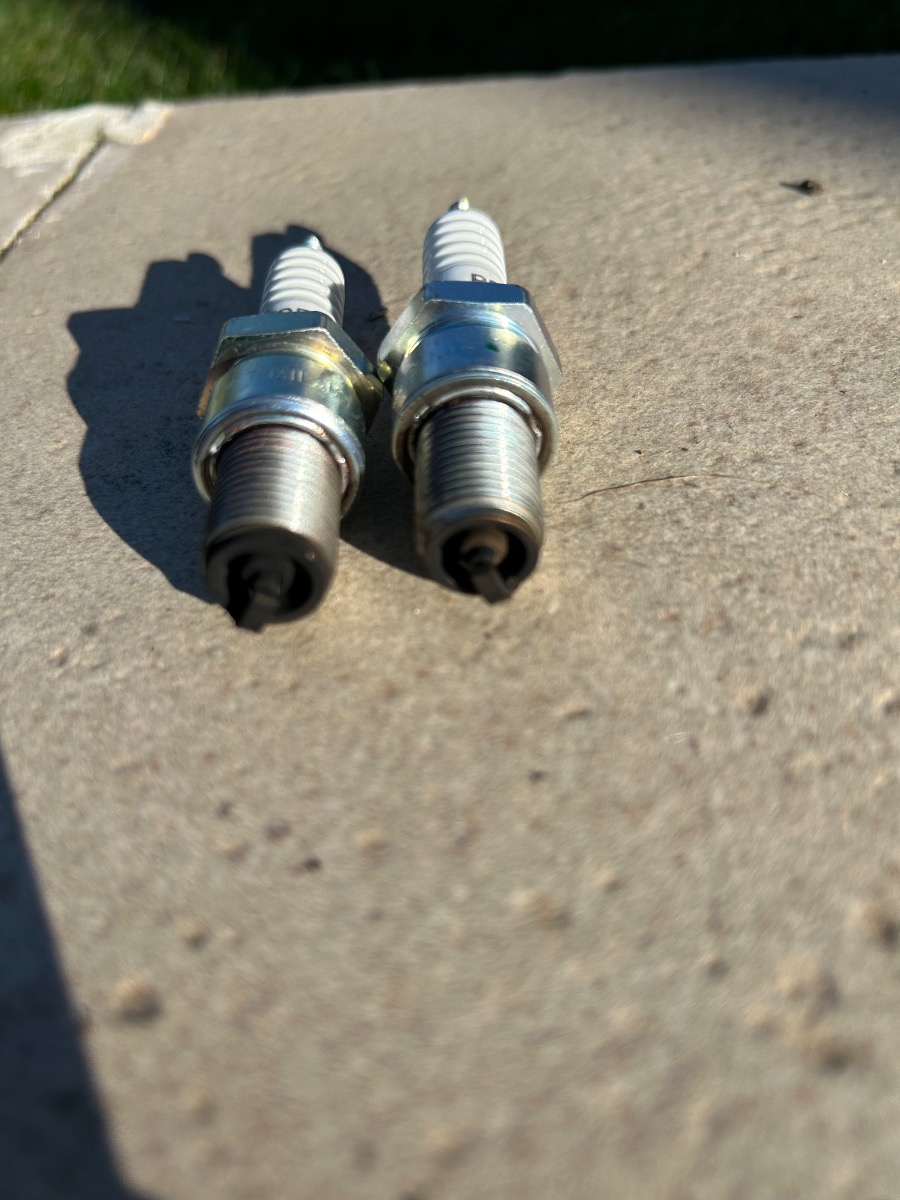

17 Jan 2025 05:32 - 18 Jan 2025 02:23Morning guys. Changed jets to smaller ones and pilot jets to larger ones. Pilot screws 2 turns out.
im getting less sooty plugs, but still a little bit. See pic.
bike starts not as well as before, and runs kind of ok; but still has a pronounced “hanging idle”. See video.
one more thing; bike will not go over 6000 rpm when running; but will do at a standstill. As engine is breaking in, I have only tried this once. I’m reading a thread I’ve found on these same symptoms.
With the above info; do you think it’s a pilot screw regulation issue now?
im a bit lost now!

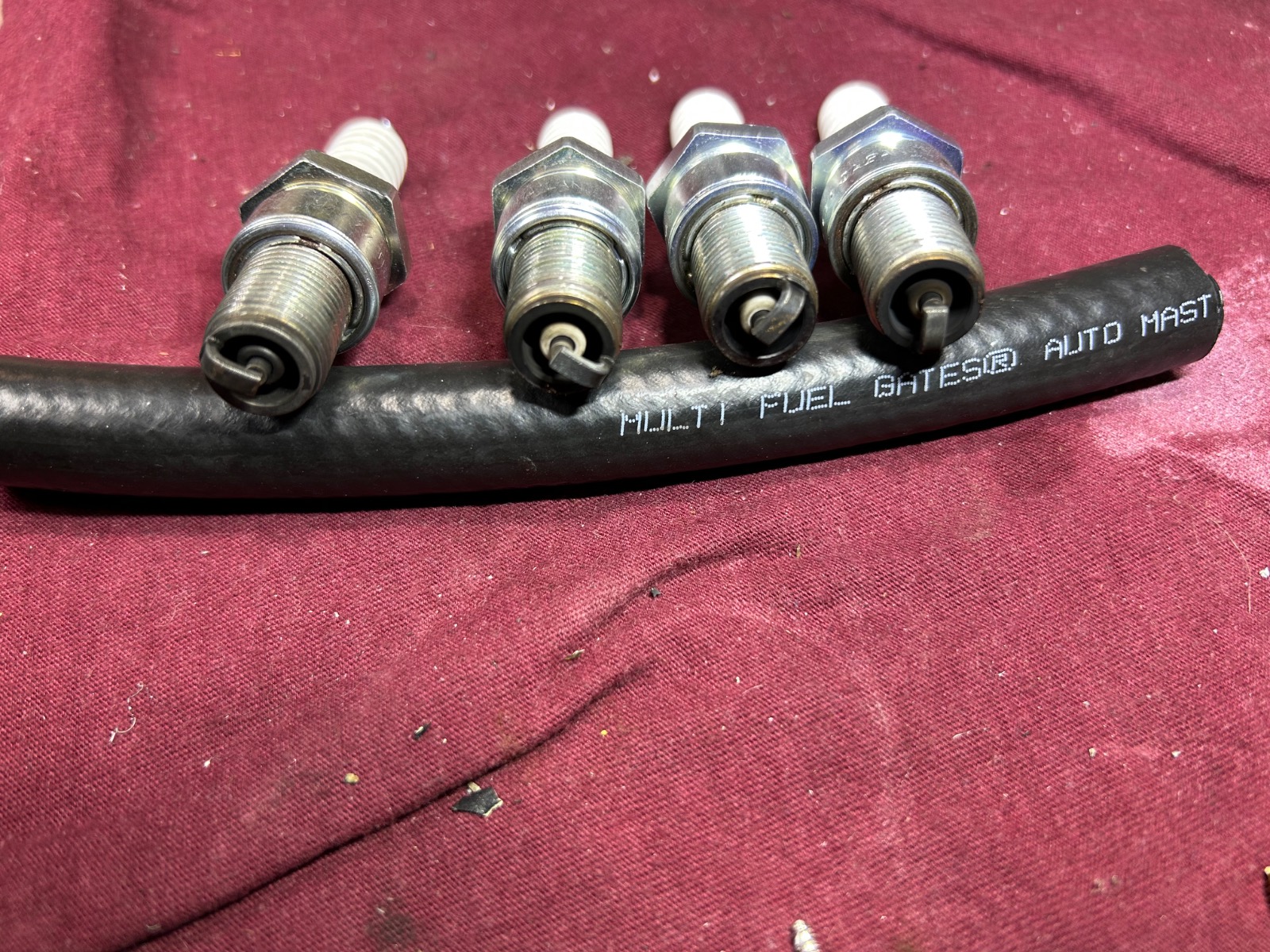

24 Jan 2025 11:15Still a bit lost. I made sure the air box was completely sealed, as the lid was loose, just in case; but no big change.
i took off spark plugs and I have a sooty one and three whitish ones. The exhaust header in the sooty one seems to be not as warm as the others (water will vaporise instantly in the 3 whitish but takes a second on the sooty one).
Symptoms remain almost the same:
- idle comes down slowly when hot
- will not go over 6000 rpm under load
I am going to check the fuel level of the sooty cylinder, and try to balance them agai, just in case.
i am thinking that perhaps the 6000 rpm level has to do with the main needle; as it originally was in the second slot from the top, and it is now in the third (as per the standard setup).
Will keep trying…

What does your AFR gauge read at 6000? Rich or Lean??
At that RPM you should be on the main jet (considering 10K redline) the jet "needle" is for transition from 1/4 to 3/4 throttle.
Do you have your throttle marked off?
You need to mark it off with a white paint marker (1/8, 1/4, 3/8, 1/2, 3/4 etc) Look at any Mikuni tuning guide, it tells you what jets work at what RPM/throttle range.
This is very basic carb engine tuning that's documented all over the place.
If you have a hanging idle make sure your throttle cable inner sleeves are spray lubed up. If it still hangs you may be lean or have a vacuum leak.
PS - There is no use in tuning till you fix the choke plungers because you will have to adjust the jetting afterwards.
