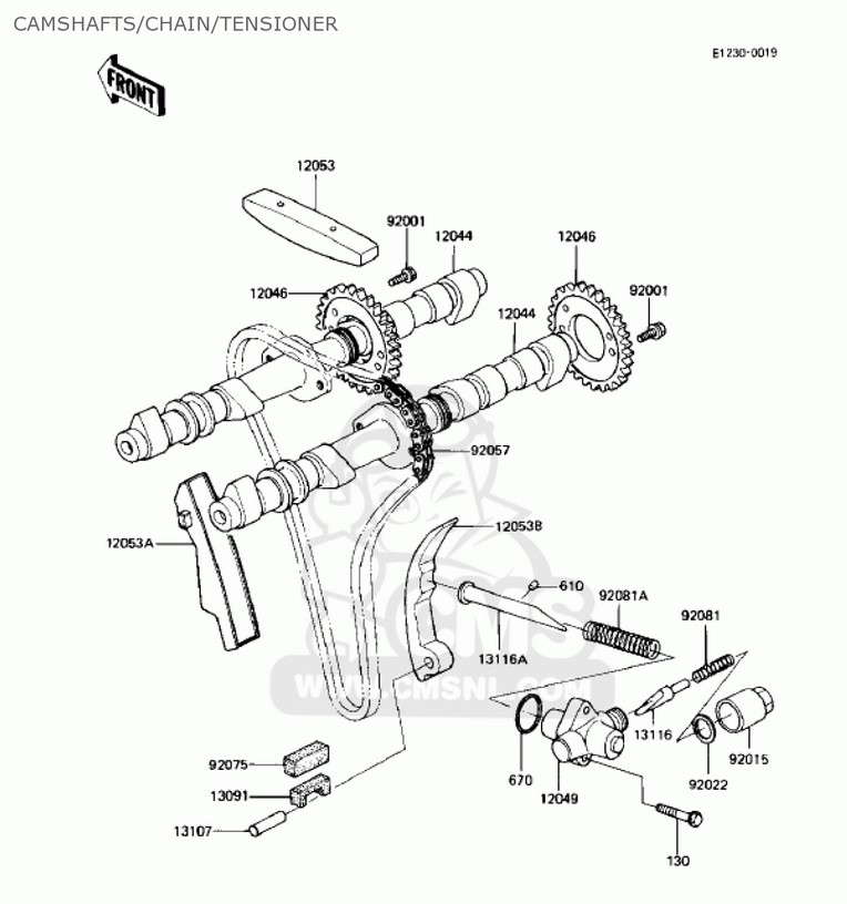

24K miles is not a lot but it may be a age related issue, rubber/plastic in hot oil does not age too well.
Here is what the cam chain assembly looks like :
Not much that can go wrong with this arrangement, same as on the 750's of that year which I have rebuilt so I have dealt with that setup. Pretty bullet proof, but you can still have issues with any moving parts especially those that see friction.
I am not saying that this is the issue but it is one possibility.
Another possibility is the automatic cam chain tensioner is not adjusting correctly and has backed off just a fraction. Those wedge faces can incur notches over time that will make them "hang up" and not adjust fully (I have also encountered that) I suggest taking it apart, inspecting, and clean/lube it. This would be a really quick item to check and eliminate from potential list.
If it were me I would get a automotive stethoscope and have a listen by probing the engine covers/cases with it hot idling.
