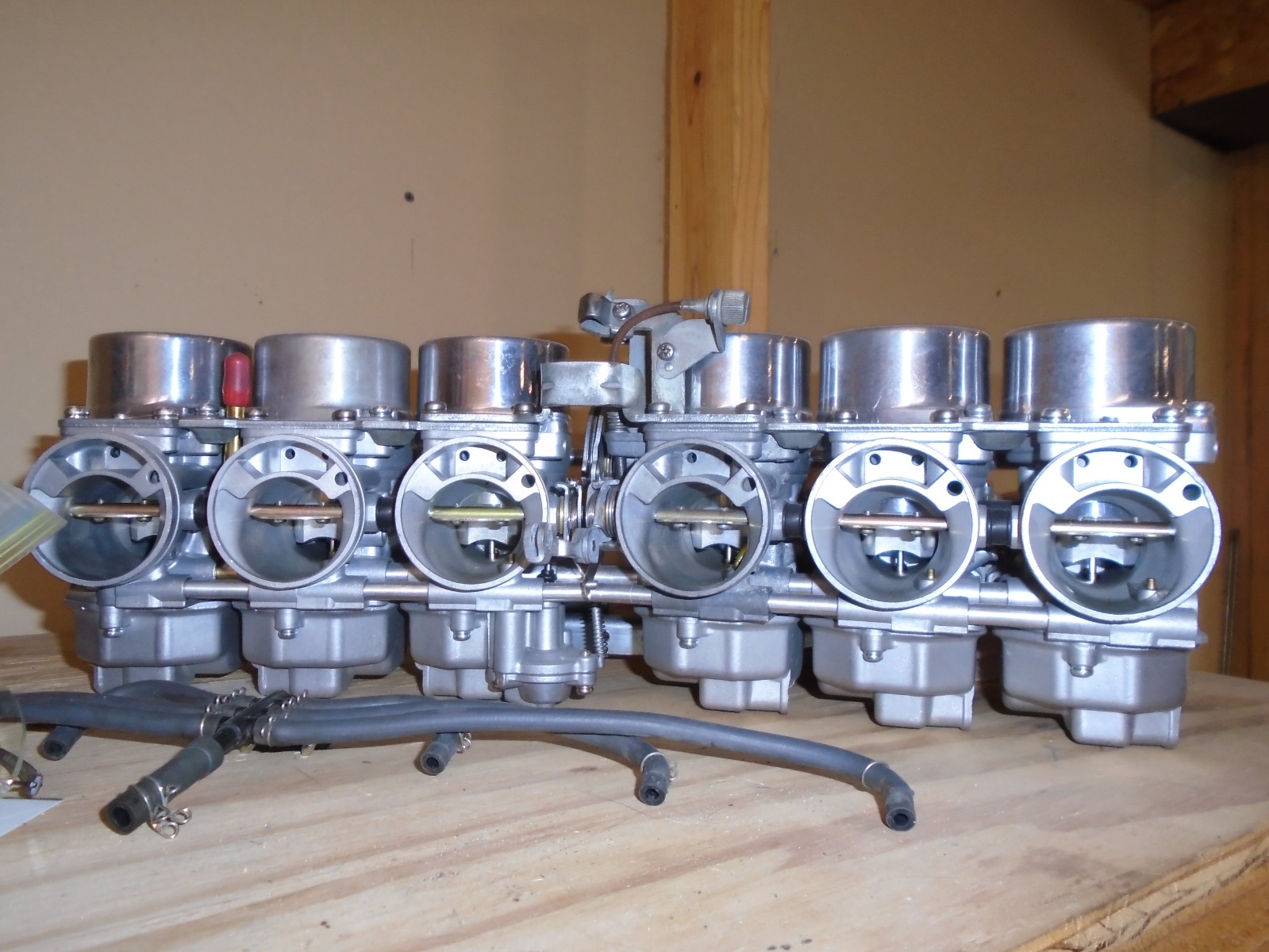

I saved a set of carbs for a 1982 GPz550 back in 1987 or so. Pre-ethanol carbs. They are beautiful and nice. I have had them in a box for over 20 years. I drained them prior to storage.
I am doing a check on them before giving them to a friend for his bike. PROBLEM: one slide refuses to budge. All other slides came out easily and look great.
I've tried all of the normal methods. Penatrating fluid of various kinds, vinegar, light tapping with a piece of bar stock, etc etc. No joy.
I am very ready to sacrifice the slide itself.
I briefly tried heat gun on the slide from both sides of the slide this morning but no joy.
Suggestions welcome!
