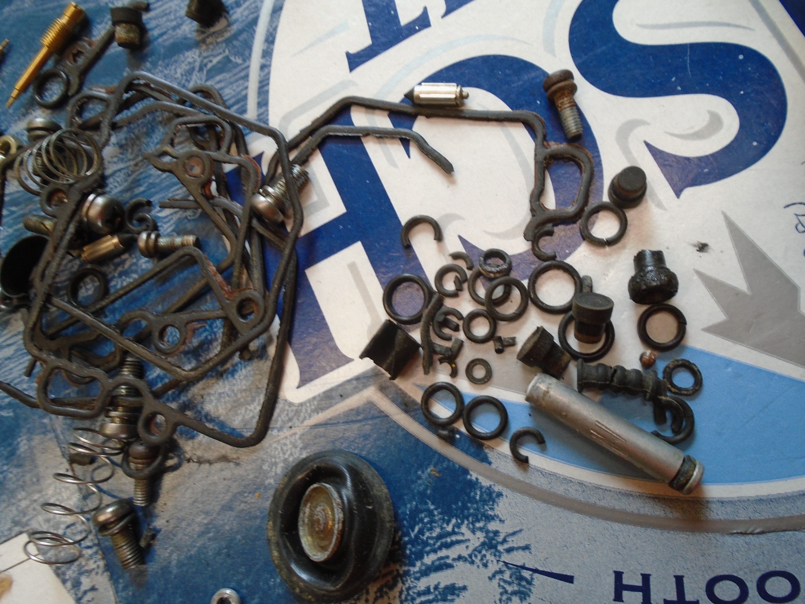

Don't get flustered, unless You actually live in Oakland, at that point I can see why, ha. All the forwarded info was merely to HELP, not to dismay you from those critters working again. But, take it as You may, "blown-out" is Perfect for jetting but ya won't know till you fill with fuel if the Tee/Connector tube rubbers are still intact. Rubber goes South and hardens/shrinks and splits. I do this all day, and not just little bikes.

Here's an example as to what everyone is talking/referring to. Because i always save disgruntled components i replace, take note. The same bits that were pulled from those previous shown CBX 1000 carbs. All hardened/shrunk/brittle, nothing usable. Make sense?? It, around here, is peat, repeat. Soo many carbs soo little time, he.

The 1982 GPz550 carbs use 4 O-rings on the fuel inlet Tee and also on the (two) fuel transfer tubes (for a total of 12 on these parts alone). These O-rings are exposed to the outside air and UV light and are sure to be hard as a rock. While I do have O-ring kits for Mikuni and Keihin carbs, I don't have them for the TK family of carbs. Well, I may have some, but I haven't verified the proper sizes. Kawasaki still sells most of these parts, though.

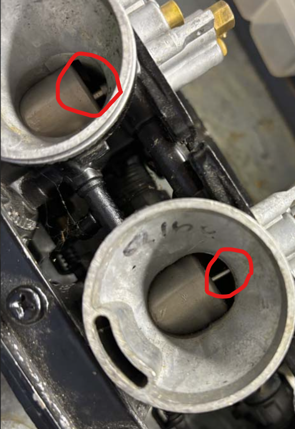

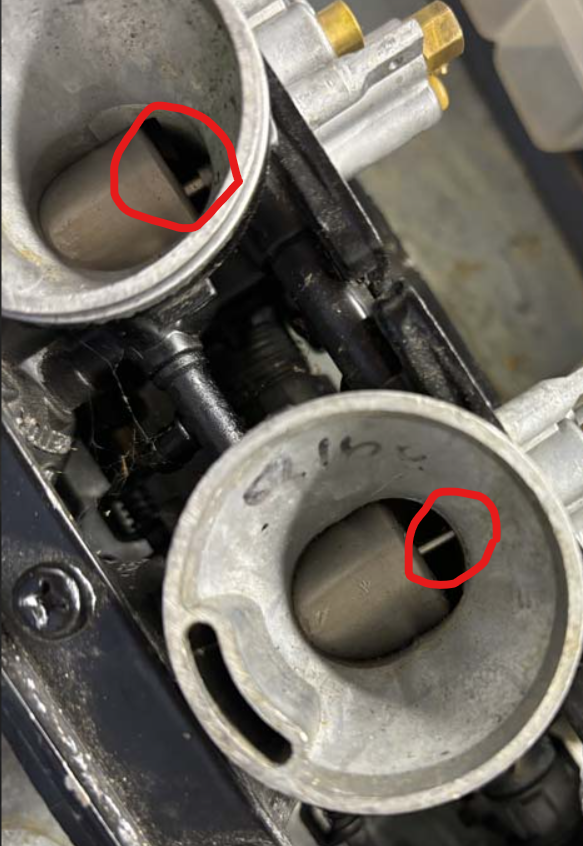

BTW, maybe just the photo, but a jet-needle looks to be missing?
Last edit: 28 Jul 2024 13:37 by Nessism.
Re: Slide Biblically Stuck In CV Carb & Will Not Move
28 Jul 2024 15:46
Nessism, to be correct, not the jet-needle is missing, the needle jet is missing = the brass bleeder part that holding the main jet.
