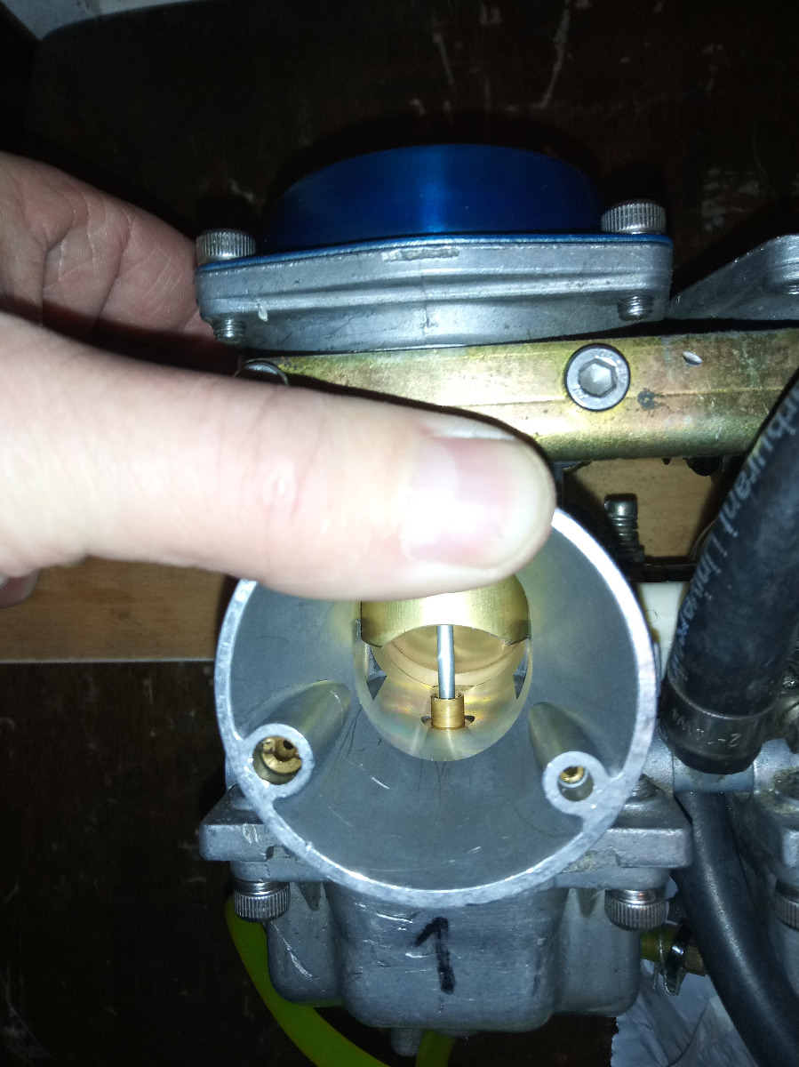

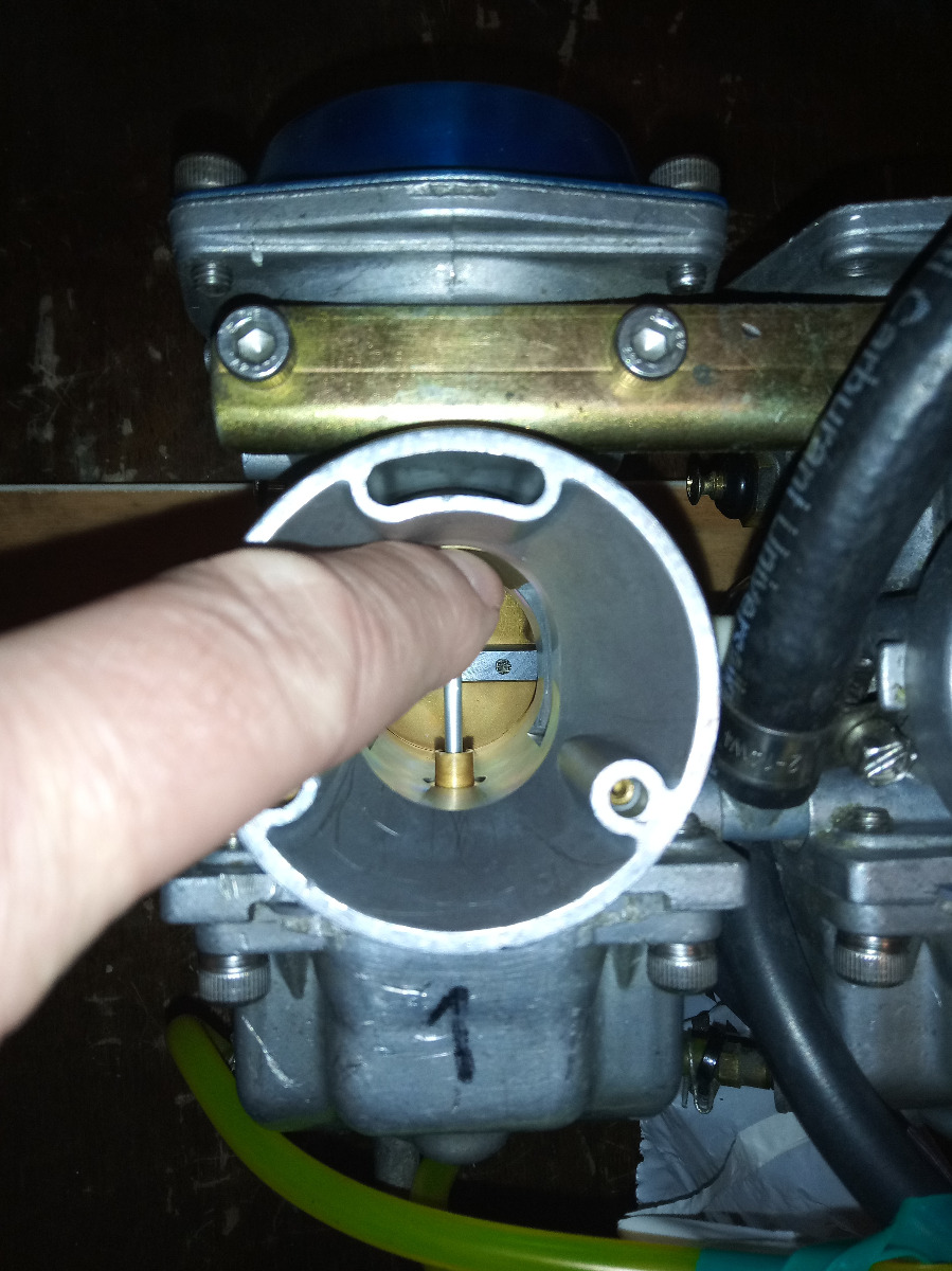

28 May 2024 11:02all valve guides are new and the valves have been professionally seated. Not sure what you mean by the thumb test on the slides.
Put your thumb over the large opening on the top of the intake of the carbs. Lift the slide then put your thumb over the opening, let them go and see if they fall fast or slow. That lets you know if there's a leak up there.

Thanks for all the replies and interest given to this thread.
Did the thumb test and the carbs are fine. I went down one on the pilot jet and it ran worse so I quickly changed it back. The pilot screws are now three and a half turns out. Still, it runs great with absolutely no hesitation while under power. Just trying to cruise at any speed and it will seem to surge or slightly buck, not sure how to accurately describe it. The pick-up coil is new from the factory and the timing advancer seemed to work fine when I put it back in after the rebuild. Simply at a loss what to do here. So much time and money spent on this project.
