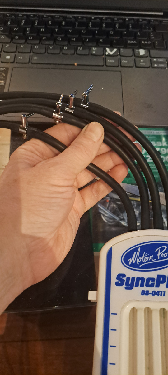

i have now bought some airvalves and placed them on the lousy motion pro carbtool. the reason for that is that without them all the fluid is sucked
out of the "tool". The valves works and can be adjusted to decrease the vacuum .So today i went to my favorite wrencingspot outdoors and was going to do a carbsynch. It did not go well because i found that the screws for adjusting is out of range.Is that a sign that the jetneedle is sitting to high ? And one more thing im not familiar with these carbs is there no "master carb" on vm26 How can i fix them so i can use the adjustment screws? i benchsyncked them last winter when overhauled and used 0.7mm drillbit.

Also, the valves you installed are another variable. To be sure they are not giving you different readings, I think it would be best to connect all four lines to a single vacuum source and adjust the valves so that each tube reads the same. Then do not touch the valves again.

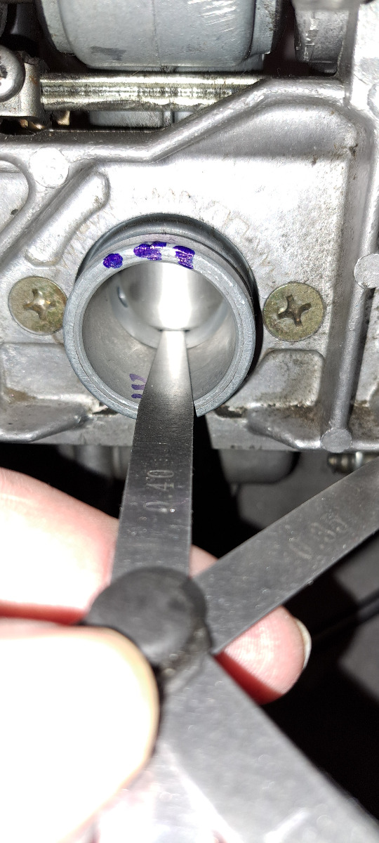

I would do a static referenz sync first. Adjust the idle positon high of the sliders to fit a 3 mm drill in all carbs from the cab outlet side.
Turn the oulet of the carb rack into the 6 o´clock position. Then adjust the sync screws until all drill bits fall out at the same slider positon.
For butterfly carbs i use a 0,10 mm feeler gauge the set static sync.

28 May 2024 06:40 - 28 May 2024 06:42I did also use feeler gauge blade when rebulit the carbs this winter.I did not do anything to the settings i just checked with feelerblade before i teared them down and checked after rebuild.The strange thing is what i found today the adjusting screw on carb 3 was not same height as the other 3 carbs. not sure what has happend.I would do a static referenz sync first. Adjust the idle positon high of the sliders to fit a 3 mm drill in all carbs from the cab outlet side.

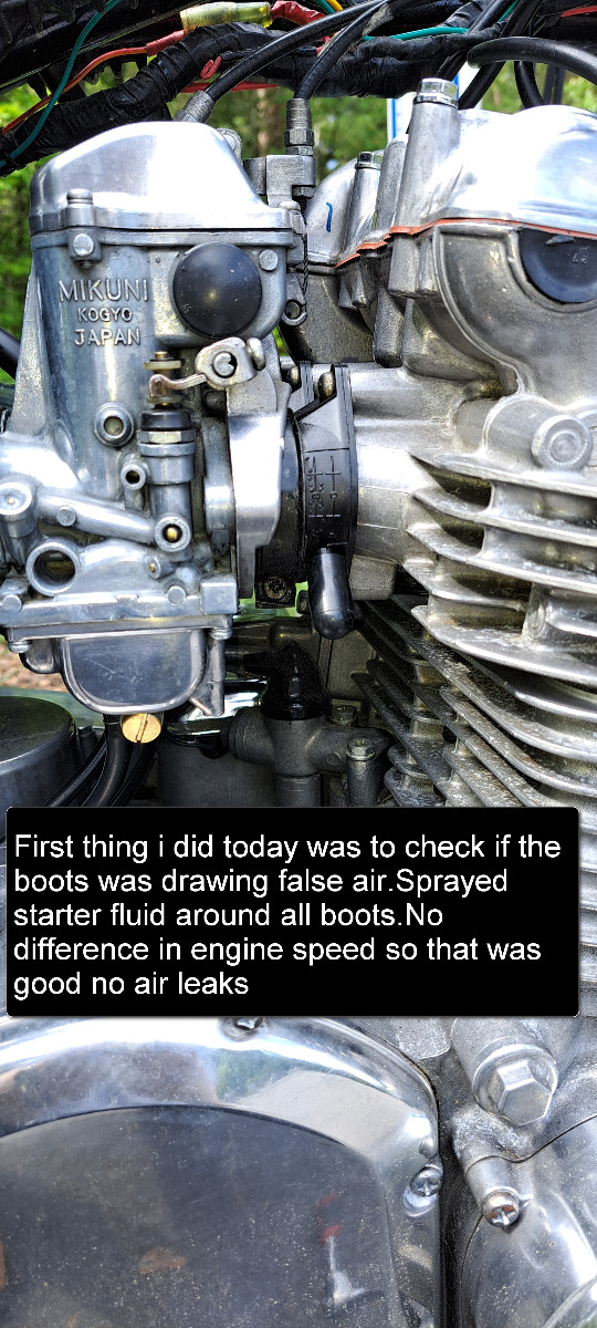

Today i did a new attemt to get the carbs syncronized. Today i had more tools .First checked if there was any airleak at the rubber boots on both sides of the carbs sprayed with starter fluid around the boots.No difference in idle speed so that was good no leaks. Then checked the compression to se if valves are okay.

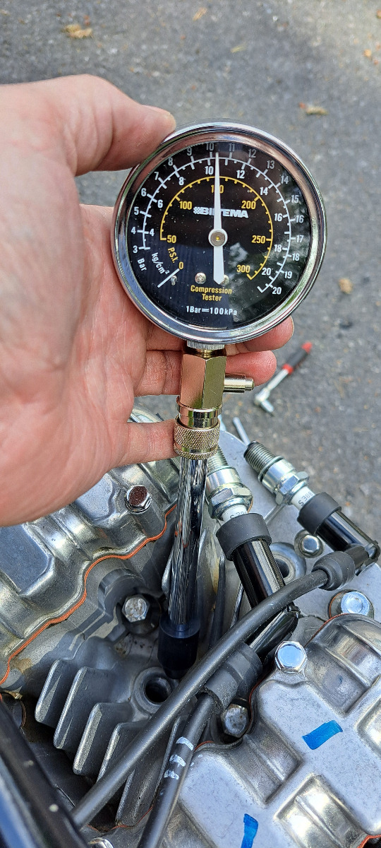

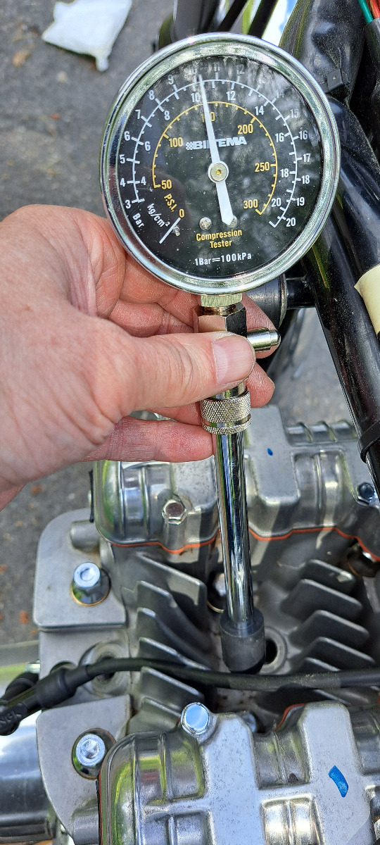

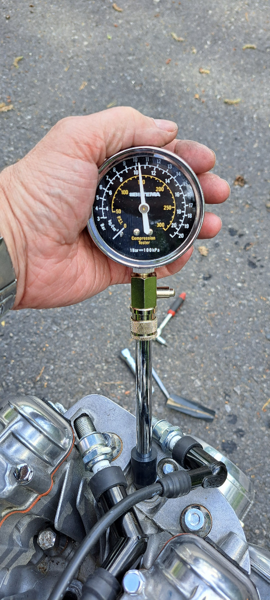

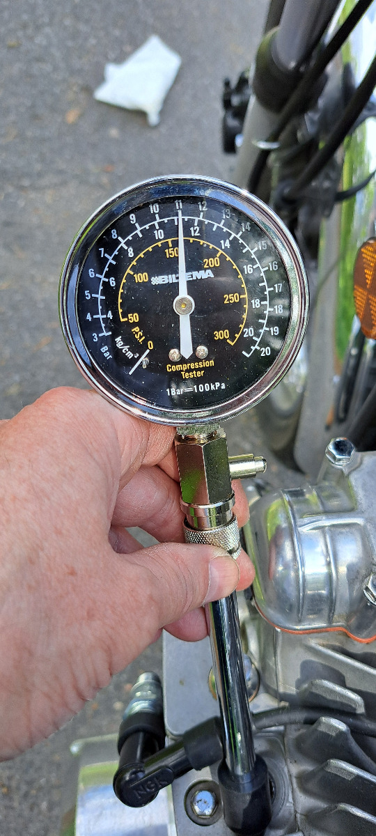

The engine has now run about 450 miles since rebuild so it is finished run in and rings are seated. The compression was good cyl 1 has 160 psi cyl 2 3 4 has 150 psi hot engine.

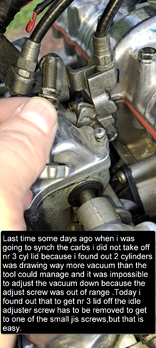

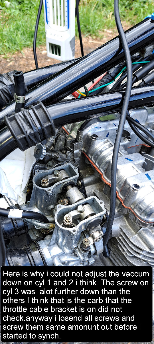

Then removed the lids on the carbs .Last time i did not remove lid on cyl 2 and 3 because i did not have a long enough screwdriwer and i desided to quit because i found it was not possible to adjust the cyl 1 carb because the adjusting screw was out of range.I mean it was not possible to tighten / lock the nut and even if it had beed able to lock the adjuster it was still to much vacuum when screw was fully out.
Today when i took off the lids on 2 and 3 carbs i could see that the adjuster screw on carb 3 was alot deeper screwed inward.So i losend all 4 screws all way out and put them with the locknut about same height so i could have more range to adjust and get them locked.

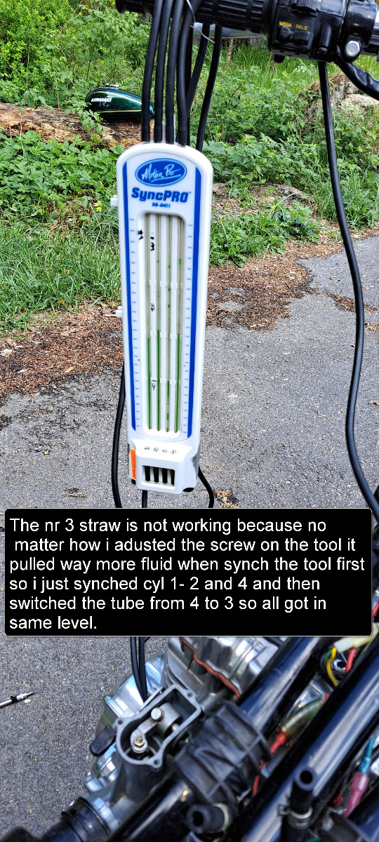

The motion pro tool "worked" better now exept that one of the straws was not working . so after synch the cyl 1 2 and 4 .i put on the rubberboot on the vacuumport on 4 and moved the hose to cyl 3 and adjusted the screws so all 4 carbs draw same vacuum. did many adjustments on the idle screw as well
the idle screw has to be unscrewed to get the carb 3 lid off but that is easy and just put the idle screw back in again when synching. Then did a short ride and the vibration around 2700rpm is gone and engine feels smooth,but now the engine bogged/burped a little when opening throttle fast so will have to adjust more on the mixture screws again and again and again .This green lady really want things her way haha.
