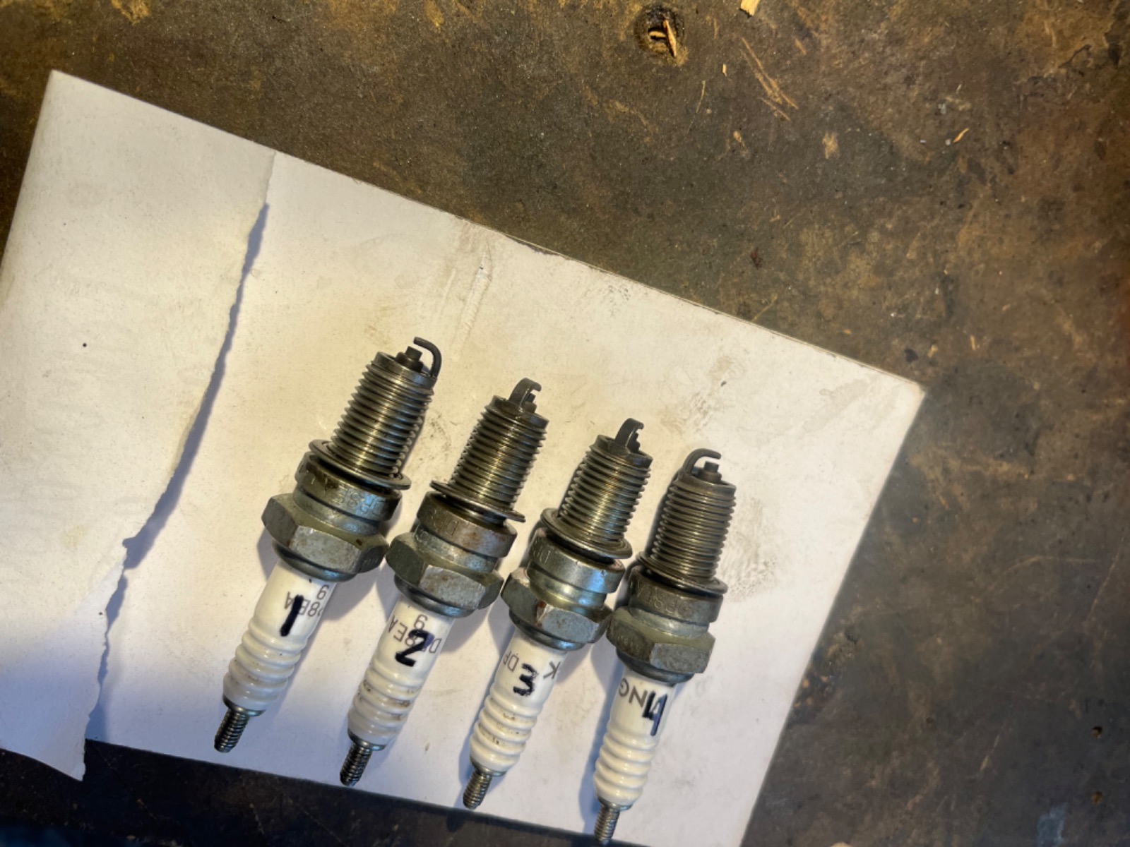

Picture of plugs shown below.
Checked each cylinder and it has enough compression to throw my finger off.

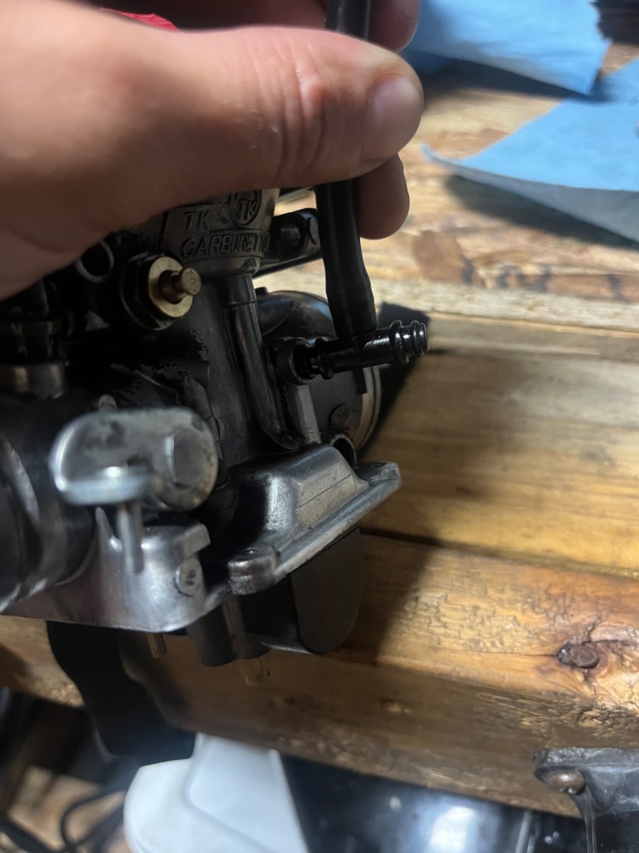

My float bowl vents might be a problem. They don’t seat very tight as I replaced the old cracked o rings with some nitrile ones I had of similar size. The float bowls seem to take awhile to fill up and fuel trickles into the carb inlet from the auxiliary tanks. I have a clear tube hooked up between the two. Could this be a problem?
pictured is the carb bowl vent I’m referring to.
Pilot air/fuel mixture screws are all new. All turned out 1.5 turns.

The engine is getting fuel on the choke circuit so I would assume flow to the bowls is OK. Have you tried taking the bowls off and checking your fuel flow when the float is wide open and then close it manually (with your hand) to see if it works as it should? Also, and I'm really reaching for this one...is it possible your floats remain stuck closed when the bowls are installed? I've had a float that remained in closed position because it was touching the side of the bowl, but never had four of them sticking at the same time.
- sf4t7
- Posts: 1021
- Thanks: 857
Re: Got Any Ideas?
07 Jun 2024 20:21
You stated you have a clear tube connecting the bowl vents together. Does this mean you've linked the two pairs of bowl vents? Shouldn't the bowl vents (in pairs) be open to the atmosphere to vent properly? (Maybe I'm misunderstanding your description)

No sorry, the clear tube I’m referring to connects an auxiliary tank with the fuel inlet to the carbs. The bowls are vented in pairs connected by a T joints as shown in the previous picture.

Have you done the test to se if it gets to much fuel? i mean to take off the sparkplug caps and turn the engine on starter for a while then take the plugs out to se if they are wet. Also look at the top of pistons if they are wet.
If wet it gets fuel ,but mayby too much.Fuel should not drible into the intake when you have a external tank fitted that may be the reason for it getting too much fuel. To fix that you will have to lower the fuel level a little or it can be that the needlevalveseat gasket/o ring are leaking.
